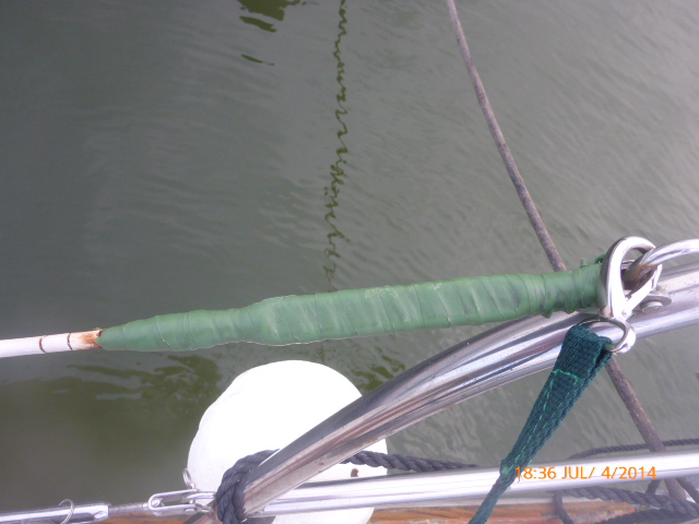

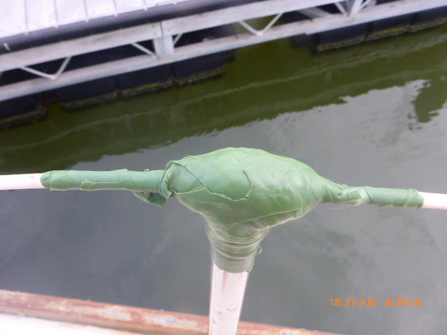

As a minor thread drift. What is the difference between sail riggers tape and white electrical tape? Seems like the same thing to me, but I have not investigated it very much.
Jul 27, 2011
5,203
Bavaria 38E Alamitos Bay
Rigging tape stretches tight and sticks only to itself, not requiring much overlap or many wraps, and does melt off from gooiness like electrical tape can. But what I was saying is that after a sail rigger does a rig inspection, he tapes the shroud turnbuckles so rings and pins do not fall out or get knocked out. This also protects the jib some from abrasion against the shrouds, pins, and rings.
  • Helpful
Likes: ontherocks83
14,252
Rigging tape sticks only to itself and does melt off from gooiness like electrical tape can. But what I was saying is that after a sail rigger does a rig inspection, he tapes the shroud turnbuckles so rings and pins do not fall out or get knocked out. This also protects the jib some from abrasion against the shrouds, pins, and rings.
There are 2 types of tape, the Self-amalgamating tape KG refers to, which is neater and cleaner than sticky tape and the vinyl rigging tape chandleries sell, which is essentially the same as the high quality 3M vinyl tape, usually sold along side electrical tape at half the price fo WM and even Defender.
Jun 7, 2016
315
Catalina C30 Warwick, RI
Thank you, I apparently I have the latter of the two. Thanks for the clarification
