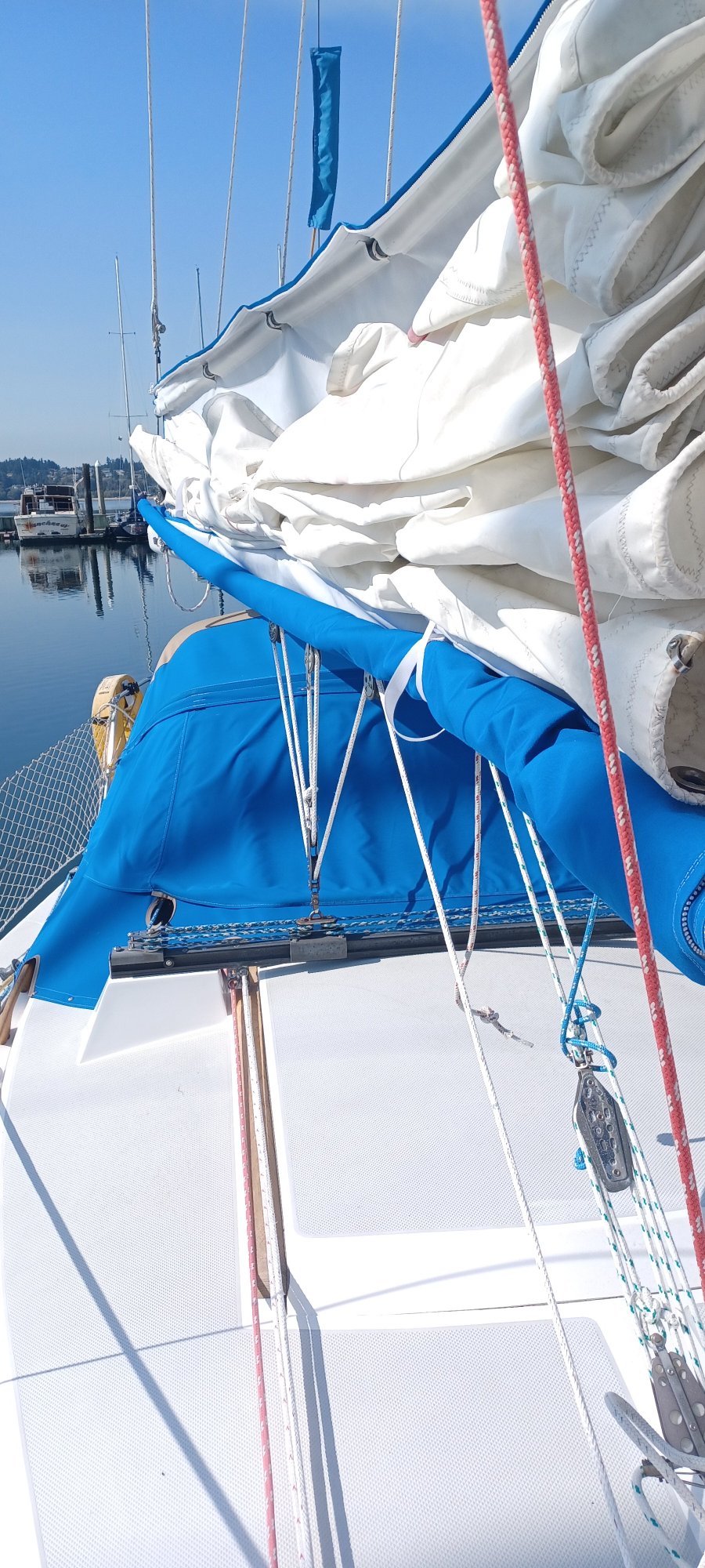

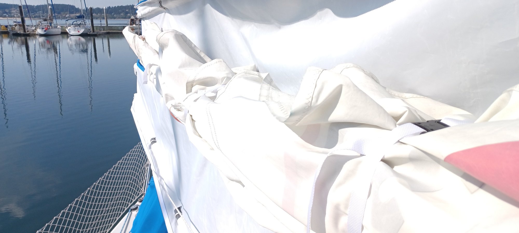

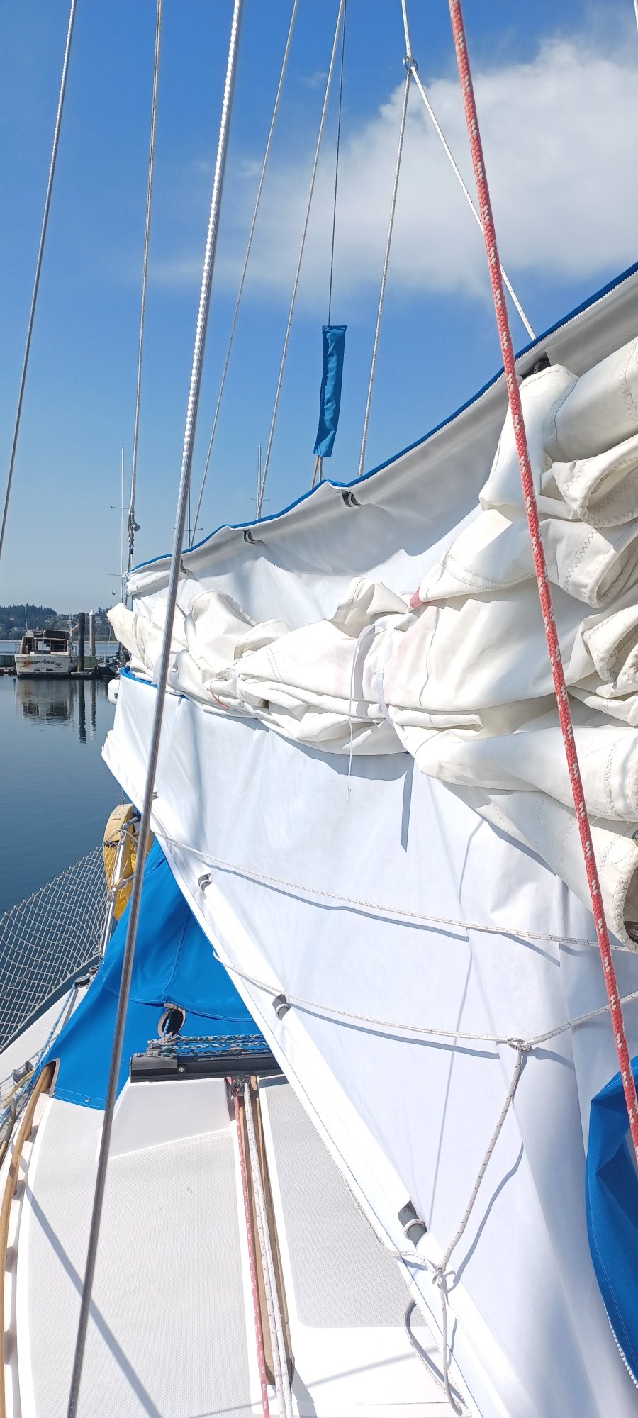

On the original sails that came with my boat the attached foot made the task relatively easy. They were blown out but they are what I had for a couple of years and I treated them like new sails till they were replaced. Flaked on the top of the boom. Held in place by the foot track and 4 straps of varied lengths with quick clips to close them.
3 ft yellows, 5 ft Greens, 7 ft blues. Work great.
Then I got new sails. Loose foot. The equation changed. When the sail falls it goes every where. It took only one windy day when I dropped the sail to convince me I needed a better plan.
I discussed this with @Hayden Watson. He sent me a plan. I procured the materials and assembled a pretty good lazy jack rig on my boom/mast. I am going to tweak it a bit, to see if I can get the sail to raise with out the batten catching.
Good thing. The sail drops quickly and is captured on the boom. I can quickly put on the straps and be off the deck/salon roof.

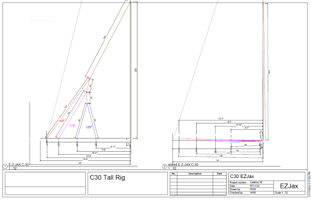

Thanks for the mention but it sounds like you are not using the EZJax's design correctly. The system is designed to hoist the sail with both sides of the Jax lowered and stowed alongside the boom which completely removes them from the equation so that there is no way that the batten can catch on them because they are parallel to and tight against the boom. It is no different than raising a sail without any type of cradle.

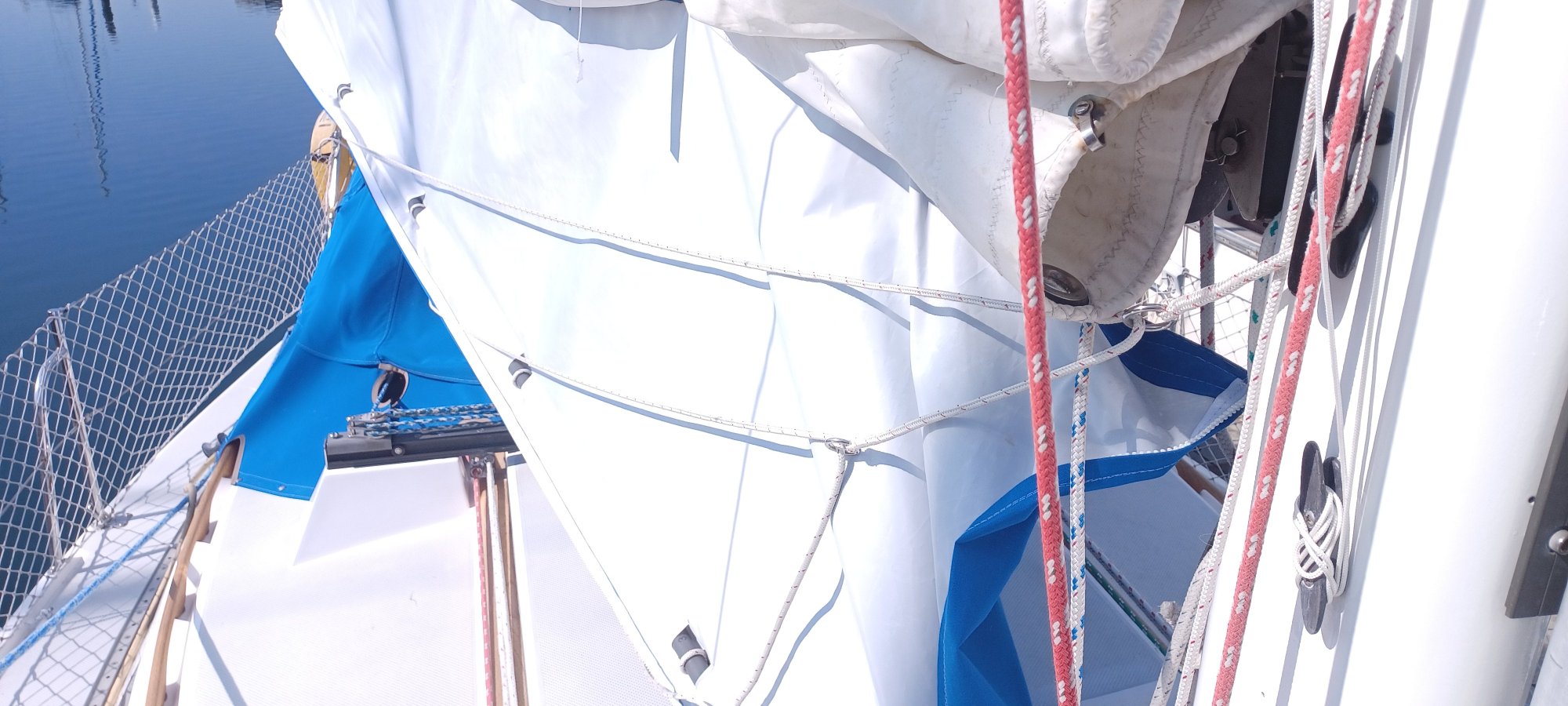

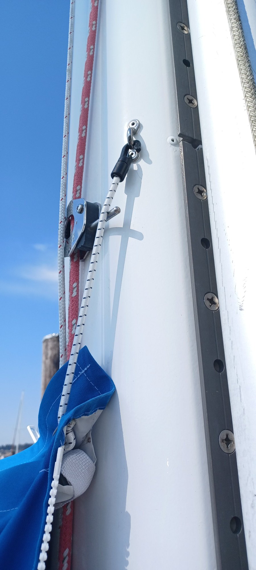

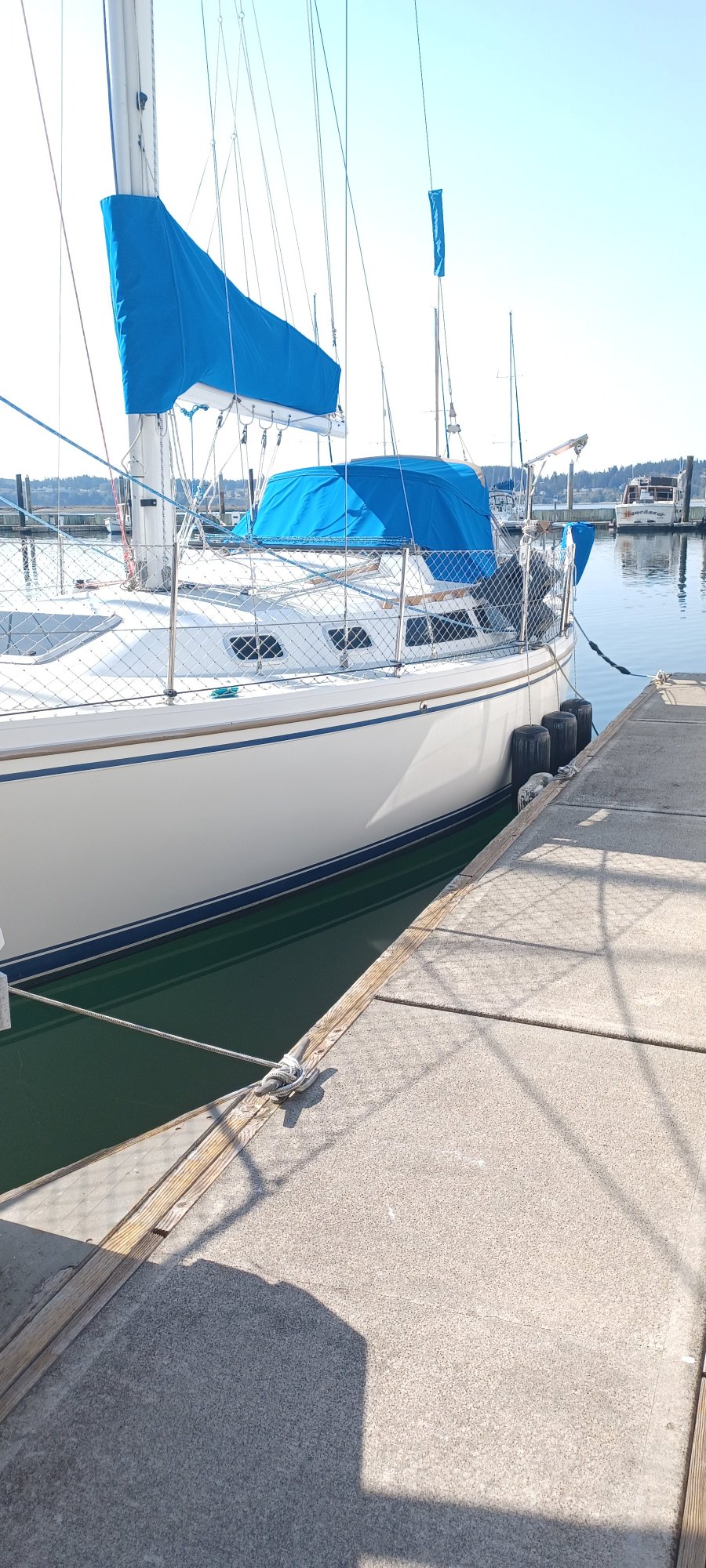

Attached is the version I made for the C30 group which show both the deployed and stored position. I always left mine up down all the time except when dropping the sail. Once the sail is down, I tidy the flakes, connect the sail-ties, and lower the Jax before putting on the sail cover. This way, they do not chafe on the mainsail when sailing and do not require modification to the sail cover. Like I said, they are only up from just before I pop the halyard to drop the sail until I get the sail ties fastened.

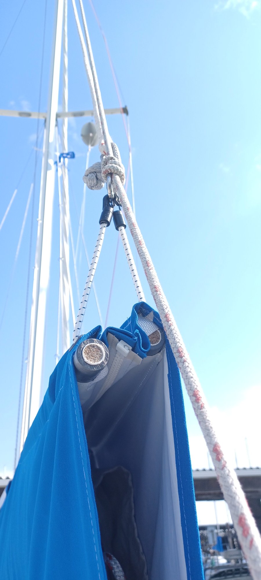

I no longer use this system on my boat because we made a Pap-Pak system. I incorporated the same mechanics in the new cover so that even though I have a sail pack, it is in the down position whenever I hoist. I have the EZJax design of lines that connect to the batten in the top of the pack which allows me to drop the leeward side before hoisting. I can also drop both sides and pull the lines forward and roll the sides up and secure them with built-in sail ties. These same sail ties can also be used to secure the mainsail to the boom with the sides dropped. This is handy for doing things like adjusting the compression in the full battens.
