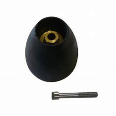

There is no prop metalic nut as there is on a conventional shaft and strut system. A sail drive is very similar to the leg of an outboard but much more robust. On the sail drive shaft, there is a prop cone made of a composite material that screws on to the shaft and a stainless steel fastener that threads into the shaft.
This is an image of the older version of the cone kit. The installation instructions had you use a special insert T2 (priced at $150 USD and unobtainable by me) on a suitable torque wrench block the prop with a piece of wood and torque to 125Nm. The fastener tightened into the shaft to 23Nm. The new design now has a nut on the end of the cone that you can get an everyday torque wrench onto and torque to 70Nm The instructions also tell you to put the transmission into reverse and to use a thread locker. The kit even comes with Loctite Red-Gel.

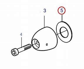

This is an image of the newer version of the cone kit.
