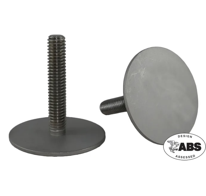

An additional option is to attach fasteners to the hull to serve as attachment points.
Weld Mount makes a product that works.
You epoxy the flat piece to your hull and you have a 3/8” bolt to use as a fastener.
Use care in where you attach the fixture. It will be a semi permanent rod sticking out to catch your skin and rip it to shreds.
