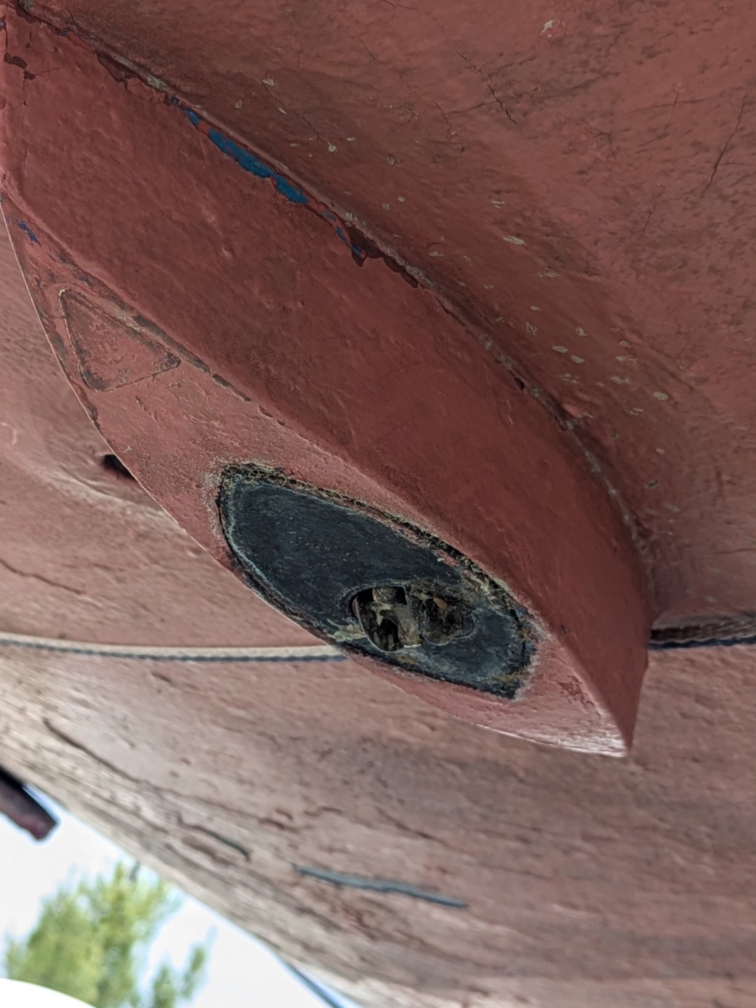

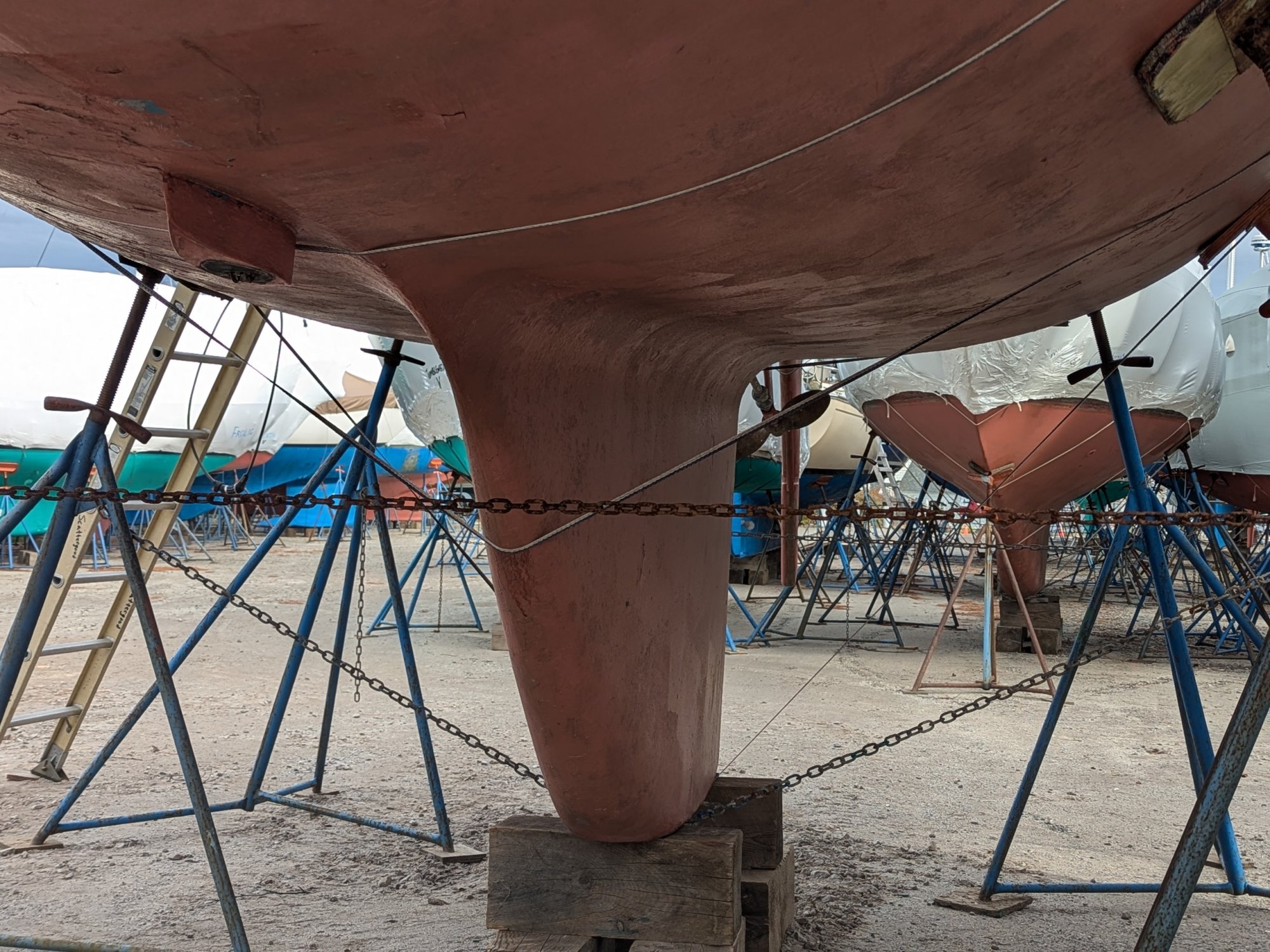

Hi there. I'm currently in the process of buying an S2 9.2C (center cockpit) berthed in Maine. My transducer and log paddle wheel are on a small bumpout on the hull, accessed thru a small hatch in the cabin sole.
