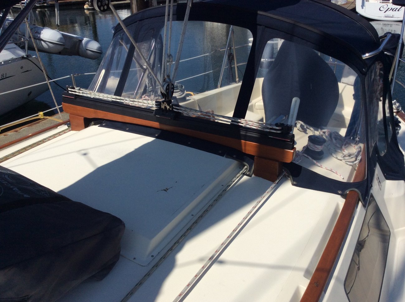

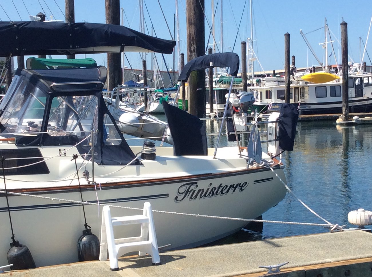

The previous owner of our boat moved the traveler to the cabin top and kept it aft as much as possible and still accommodated the dodger. There is a stainless steel frame aft of the helm mounted on the cockpit sides (aft of winchs) that has a bimini rolled up on it. Unroll it and it zips to dodger. It can accommodate sides if desired in the future. It does not have clear in it and I’ve thought about it. I can get some pics in a day or two..

Thanks very much for that information and the pictures! I was wondering about moving the traveler up there. Can you tell me how the cabin top is reinforced underneath? Did the PO add a plate or some way to distribute the load?
