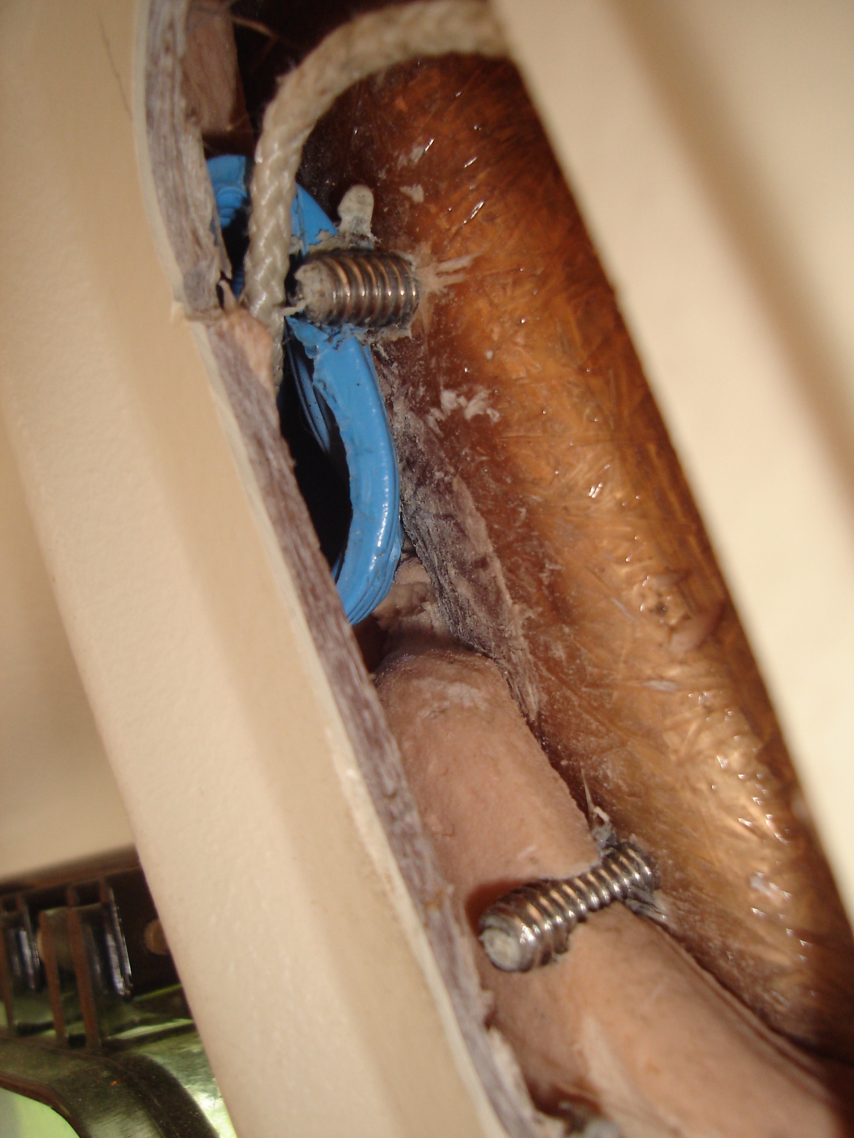

On our 260 we also had the crushed conduit above the stove. If I remember correctly I used a rigid fibreglass fish tape and pushed/forced it through from the mast end of the conduit. I also did do a bit of digging over the stove as well with a sharp pointy object to help guide the fish through and help enlarge the opening afterward. Ended up with fish coming through the side of the conduit above the crushed portion and towards the centre line of the boat. Pulled back a replacement pull line and left a spare in place as well for future use. Flotation foam also blocked a number of conduits in various locations.

Success! Just got my snake to go all the way from the mast to past the stove. I am attaching photos of the stanchion above the stove before and after I finished chiseling away material that blocked the conduit. Only took three days! Now to run the wiring. :dancing:
