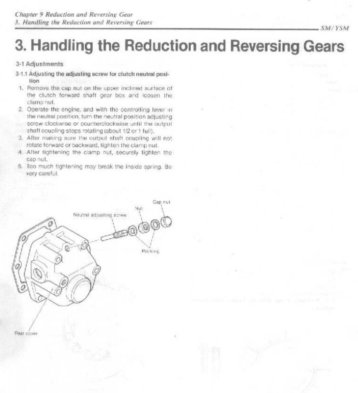

Neutral adjustment
Basically I follow the same regimen as Navigator, with one exception. My prop shaft has some rotatating creep, even with the transmission lever in NEUTRAL. To stop the creep, I put a pair of Vise Grips pliars onto the drive shaft near the end of the transmission. As the shaft creeps, the vise grips stop the shaft as the Vise Grip pliers contact the hull.
(I have Hunter 27 with a Yanmar SB8 (8 HP) diesel.
(The problem with the creep, of course, other than the danger to the dry cutless bearing, is the obvious danger (liability) of a rotating prop shaft.) [ Which is probably why someone else's yard insists on removing the prop before starting the engine.
Hint: Be sure to remove Vise Grips right after winterizing!
Bob
Prop creep is usually an easy adjustment in the transmission. The amount of creep when running the engine on the hard will probably not do any damage to the cutlass bearing as long as you are not running the engine for hours.
But - clamping the shaft will wear out the clutch plate in the transmission - a much more expensive fix.
The picture will explain how to adjust the neutral drift in the transmission. I did it to mine (YSB12) and it took about 2 minutes. Hope this helps.

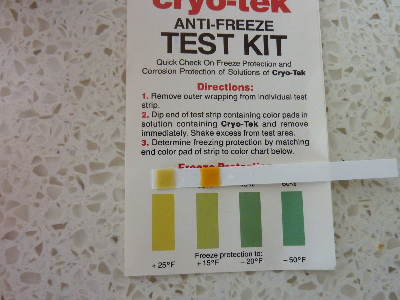

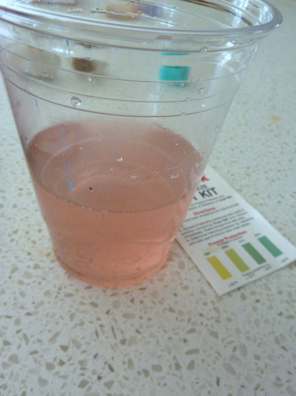

Guys this is please be very careful with this advice.
As one who actively tests AF concentrations when winterizing, on LOTS of boats, I have yet to see one that can take a gallon and be adequately protected... PLEASE winterize carefully. 3-5 gallons of AF is $10.50 - $17.50. A heat exchanger, water pump or strainer many $$$$ more..... I have a Universal HX that froze and split with THREE GALLONS sucked in....
Please remember that the BURST POINT for plastic pipe is -10F on UNDILUTED -50F propylene glycol. Dilute it just a tiny bit and your burst point is well above 0F... A thin walled copper tube heat exchanger is as fragile as just about any plastic pipe. Again PLEASE be careful.. This is NOT an area to save $10.50 on....
This is what came out of that M-25 HX that split a tube. Again, three gallons of -50F PG antifreeze were sucked in. It still froze and split... Look at the color of what came out of the HX it does NOT match what it went in as. Yes the owner "saw pink" but the "concentration" of "pink" was nowhere near enough.... These test strips are not what I normally use but you can't take a picture into a sight refractometer.
It will take this owner 108 years to make up the "savings" of the two gallons of AF he did not buy vs. the repair costs...........
