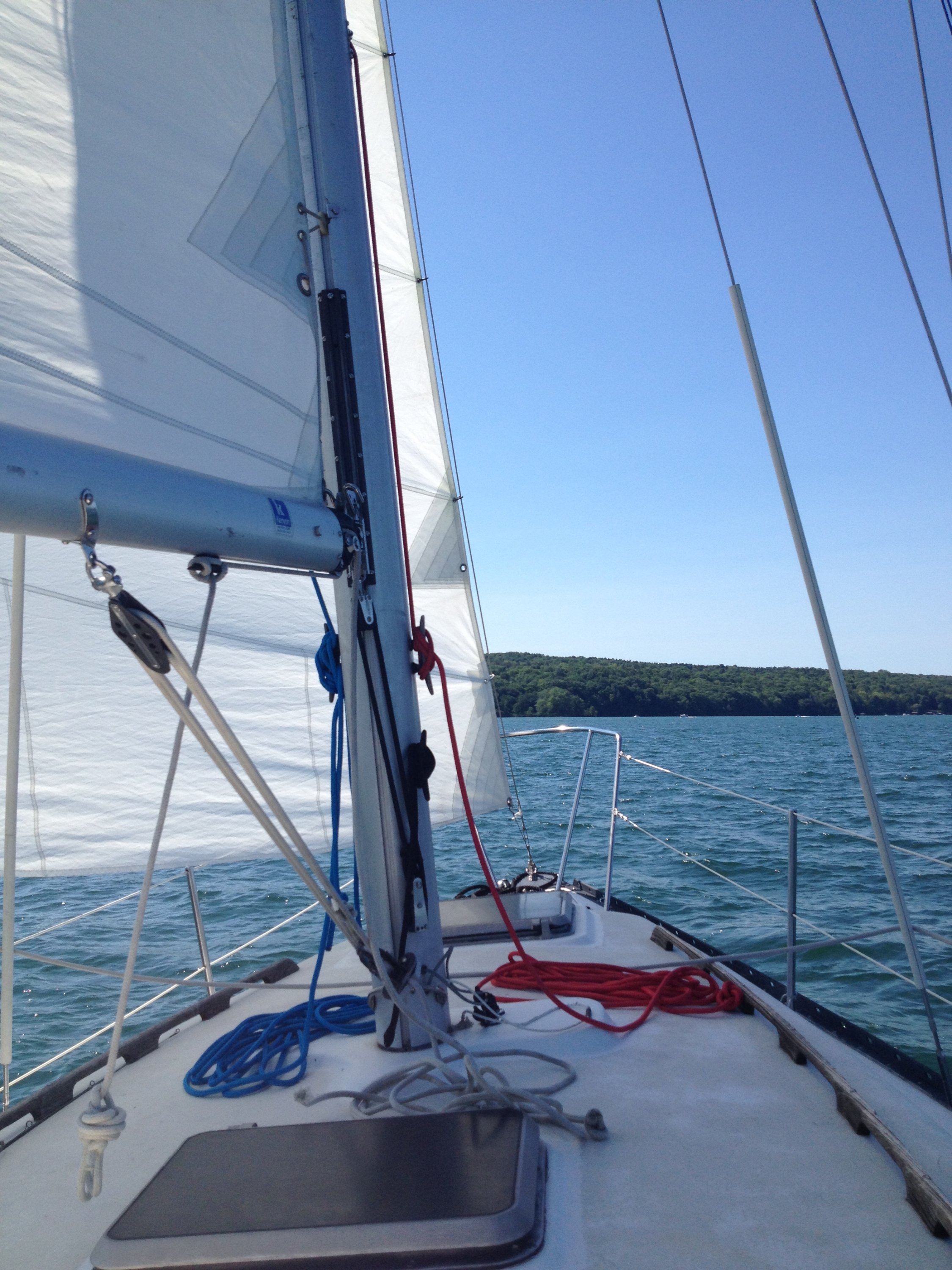

Welcome to the forum Kupskius! I too am on Cayuga and also live in Maine on Park Street, behind the Most Holy Rosary Church. I can certainly answer your questions and help with the rigging. I will send a private message to you with my phone number...feel free to call and we can discuss your needs. My H30C is still in Treman Marine Park and we can go take a look at how I have it rigged...at least until hauling it out on Oct. 17th. I've attached a photo which shows the halyards, downhaul, and boom vang setup.
Best Regards...Wayne

Your 1980 version had the halyards run aft to the cabin top left and right of the traveler with turning block organizers at the mast base, cam cleats and winches. Our earlier models had them cleated on the mast as in the pic above..
