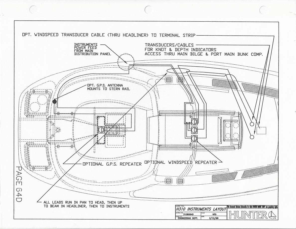

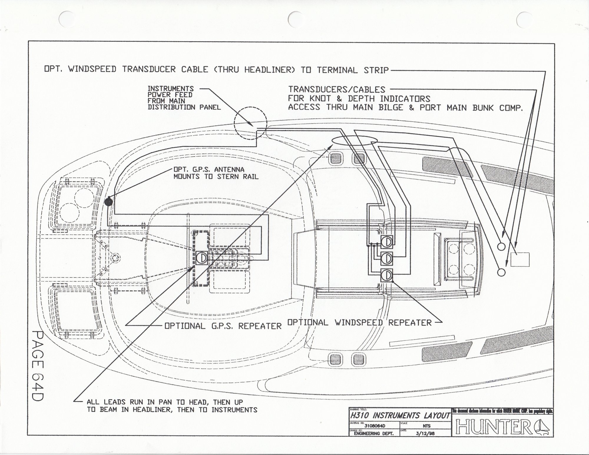

Do you think I should pull from the helm or from somewhere below?
Refer to your owner's manual to see if there are various spots along the run to open up and slowly nudge the cable along. This should be very close to what you have:
Jun 7, 2009
15
2 29.5 kingston ny
Thanks Ralph, Mine is different. There is about a 1.5" pic pipe in the hold running aft. I am not able to see it in my owners manual. i am going to call Marlow and see what they have to say.
