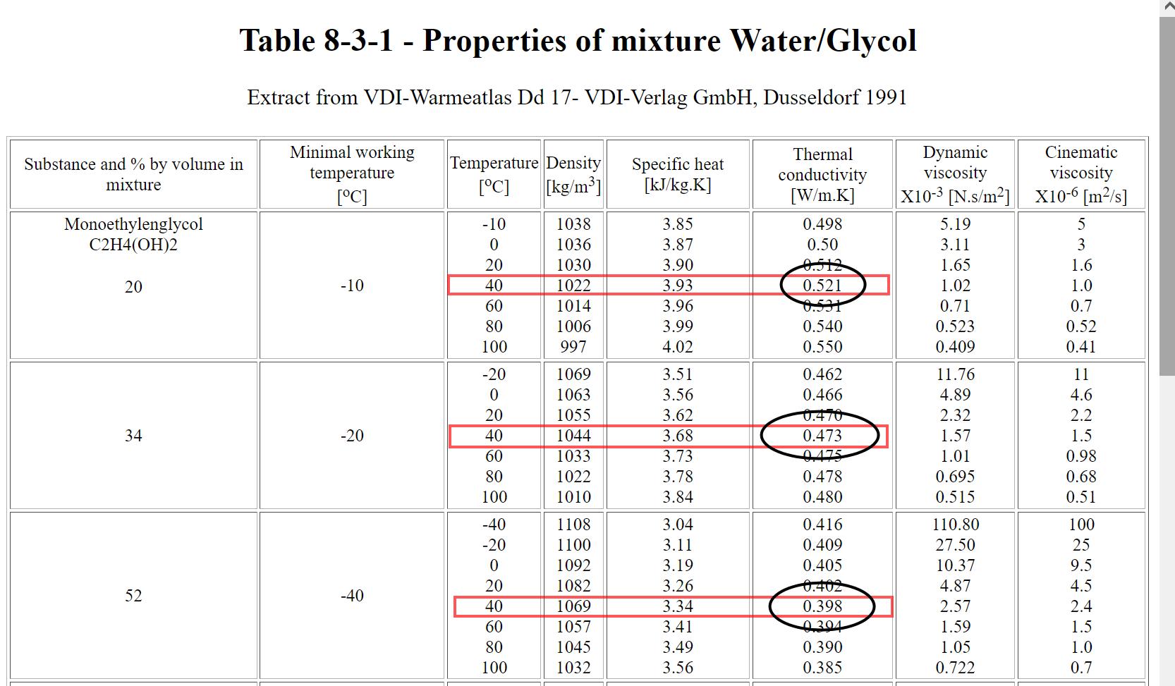

Please see the table in the link below and the tell us if you still believe that
"The 50/50 mix of antifreeze has a greater heat capacity than either water alone or AF alone. This means that it takes more heat energy to raise the temperature of the coolant 1° than it takes to raise water 1°"
Table 8-3-1
OUCH ! I can only suspect that @dlochner was looking at Table 8-3-1 on his iPhone and not a full size screen, hence his error in reading the Table. 100% ethylene glycol only has about 75% of the thermal capacitance of 100% water.

Mixing the two does 3 things, lowers the freezing point, raises the boiling point, and makes it a better heat transfer medium.
No. Read either the Wikipedia article or look at the table again.

A 50/50 mixture of AF and water is a better heat transfer fluid than straight water,
Maybe you might want to think about giving in while your ahead (relatively speaking).
The more ethylene glycol you add to the mix, the less the conductivity becomes.
Water has a greater heat capacity than ethylene glycol however as a result it does not give its heat as readily.
No one cares how slowly heat is GIVEN up to the heat exchanger. Make the damn clunky thing bigger and better. It's how quickly it's REMOVED from the small passages in the engine block. That's where the delicate design comes in.
No matter how you look at it, the more glycol you add, the poorer the mix becomes as a coolant. Its only saving grace is that it keeps your engine from corroding away or splitting in two in the middle of winter.
