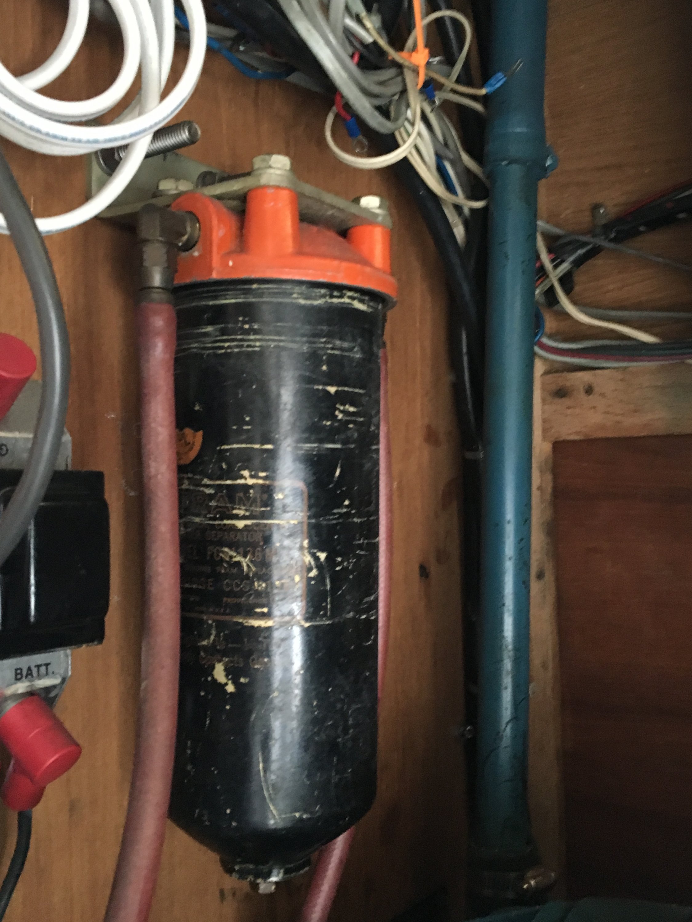

Yes Guan. You are correct. On my first rough water cruise, I stirred the soup and found that the 1974 filtering system was a bear to change.
My boat has 2 tanks... listed at 85 gallons each. There was unknown fuel quantity and age in the boat when I bought it.
After considering many options, I have been running through the fuel. 2 years finally got to the bottom of the Starboard tank while cruising with my friend Les on Mahalo. When got to the tank bottom, lots of stuff plugged the filter. Cleaned the filter, started the engine, it died. Looked in the tank, empty. Switched to the 3/4ths full port tank... Now considering a fuel polishing strategy. Not sure I want to pay someone $800-$900 to run fuel through filters... Might be better to buy the filters and pump. But there are other issues higher up on the Boat List.

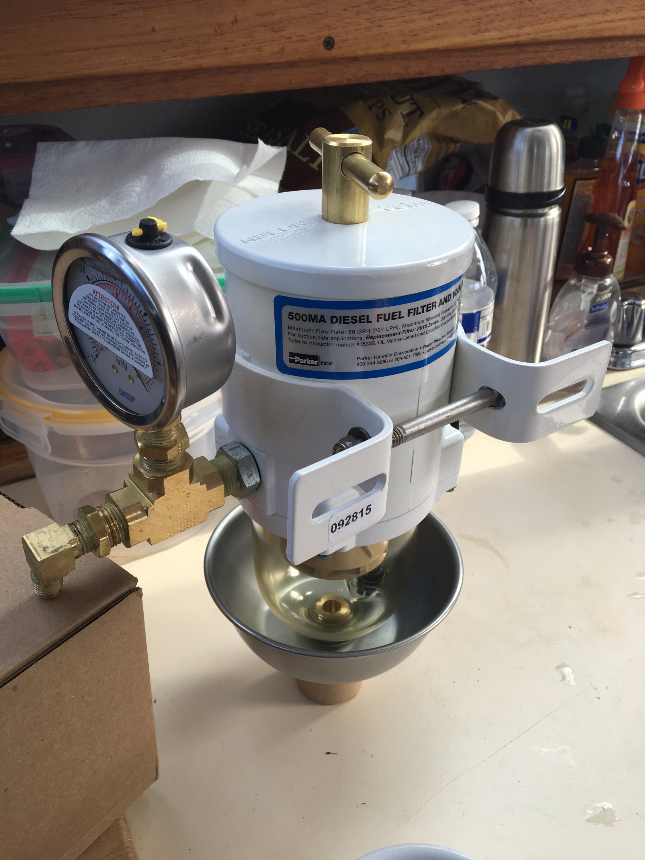

While I suspect water has been in the tanks (the PO failed to put o-rings on the fuel ports), I removed the Ford Truck filter
installed a Racor 500M with vacuum gauge.
Filter changes are now a "oh that again" task, no big deal. I carry spare filters. Monitor the gauge and know if I see greater than an 9 on the gauge it is time.
