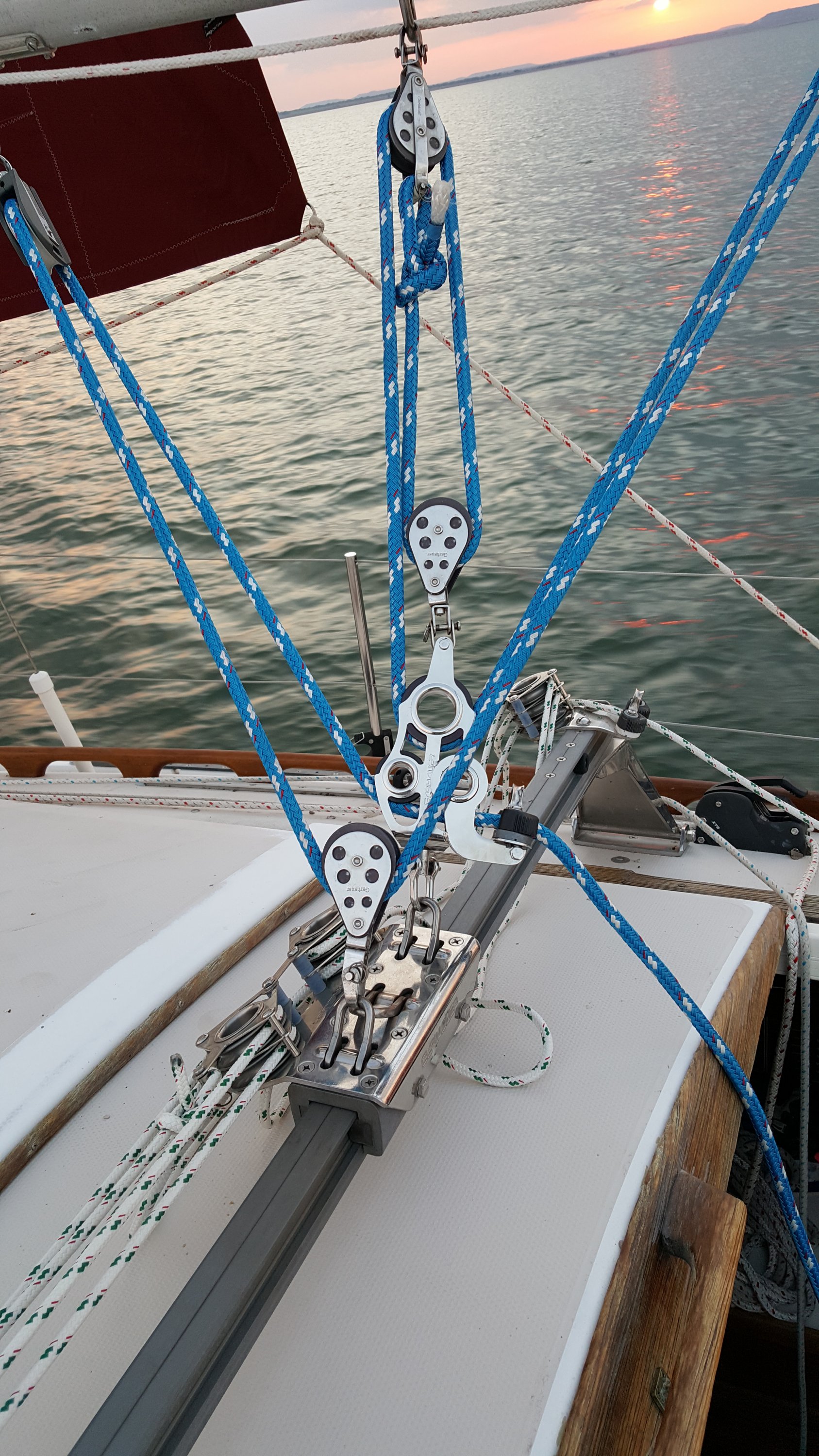

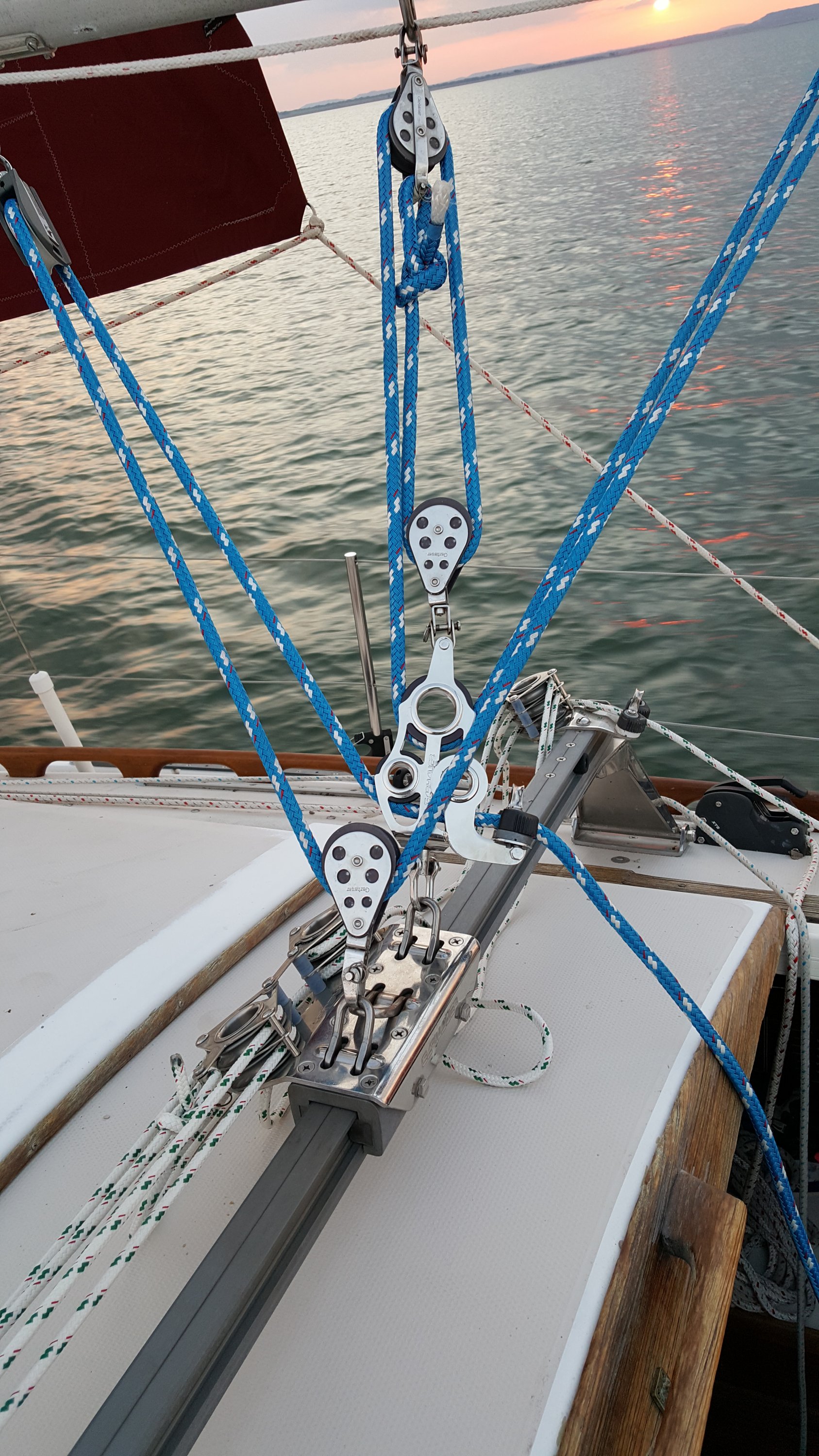

I had Garhauer make me this piece and now can adjust main from anywhere. I actually run the lines different now and that new block is in the center with another block below the top center one.

I had Garhauer make me this piece and now can adjust main from anywhere. I actually run the lines different now and that new block is in the center with another block below the top center one.View attachment 131593

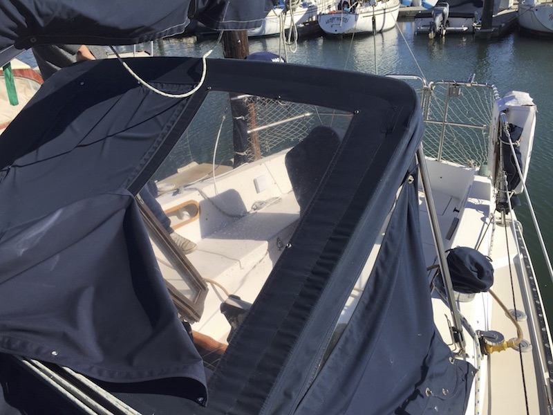

Woah! I did see something similar on my dock walk. That could make things easier given that I remove my dodger whenever I go out here on the SF Bay (maybe things would be different if I had a wife or a kid that wanted to hide in the "sweet spot" while underway.
23,525
You betcha. You must be a glutton for punishment if you go out without a dodger when you actually have one! :) Of course, John's solution wouldn't work with a dodger up.
Well, my dodger is a real POS near the end of it's POS life. It's easier to see and to access the mid/foredecks by jumping under the frame. Plus, I've never really seen need for it here in the bay. Maybe it's because I grew up sailing in Alaska, who knows...

JohnVTX's cool bit of kit still leaves the sheet at the fwd part of the cockpit, but it does indeed give added purchase (getting the winch out of the picture)
