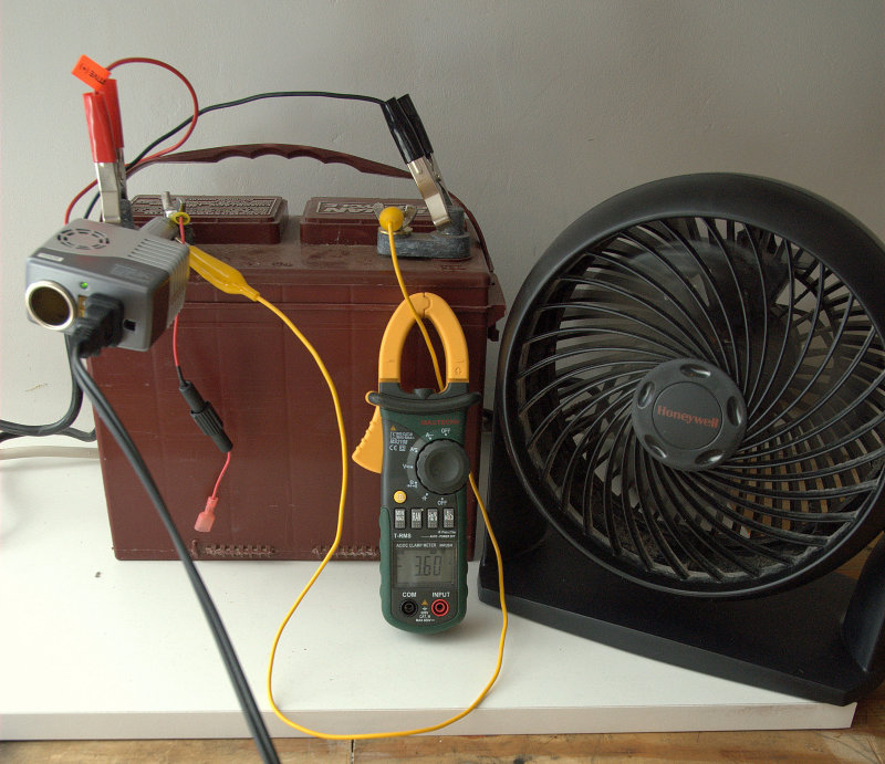

It draws a LOT
Does anyone know the power consumption of one of these Honeywell table top fans?
http://www.amazon.com/gp/product/B0000DJ27M
I've search and even downloaded the owners manual but I can't find anything.
I don't have access to the actual fan; it's on the boat.
Does anyone have an opinion about running it on a inverter over night?
It would certainly not be my first choice. The Honeywell fan you show draws 3.6A at 12 volts running through a very small 150 watt inverter. On a bigger inverter you'd likely see less efficiency.
3.6A X 10 hours of run time is 36Ah per night. Now multiply times two nights at 72 ah's and you've used nearly the entire capacity, to 50% depth of discharge, of a 200 ah bank while out cruising.
Remember that when cruising, and charging via alternator only, you'll rarely if ever put back in any more than 80-85% of charge state so a 200 ah bank with 100 usable to 50% becomes a 60 hour bank when away from the dock for any length of time.
200Ah X .80 (or 80%) equals 160 available usable Ah's at an 80% re-charge. If the bank is only say 200 ah's, and you don't want to discharge below 50% for battery life/longevity, then you'll have only 60 available real usable ah's per charge unless you run the motor for hours and hours on end to get back to 95-100%..
3.6A is a lot of current for a fan. My Bora Caframo can run 10 hours and burn only 2.5Ah's and your is consuming 3.6Ah's for every hour it is run. Is the Bora expensive? Yes, but less than a battery bank upgrade..;) RV fans tend to be slightly less money but do still draw more than the Bora..'
Oops almost forgot the proof... Here's the pic..
Jan 5, 2009
40
Hunter 28.5 Lake Lanier
What are the chances that Maine Sail has hooked an ammeter up to the exact fan that I have on my boat?
Amazing!
