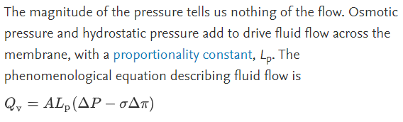

In addition to the concentration driving force to cause osmosis, there is also The pressure. Hence the reason you see far more osmosis on the outside of a hull, and often lower down, than in the inside. A short quote from how osmosis happens:
What are the variable in this equation? Or the citation of the work you copied?
