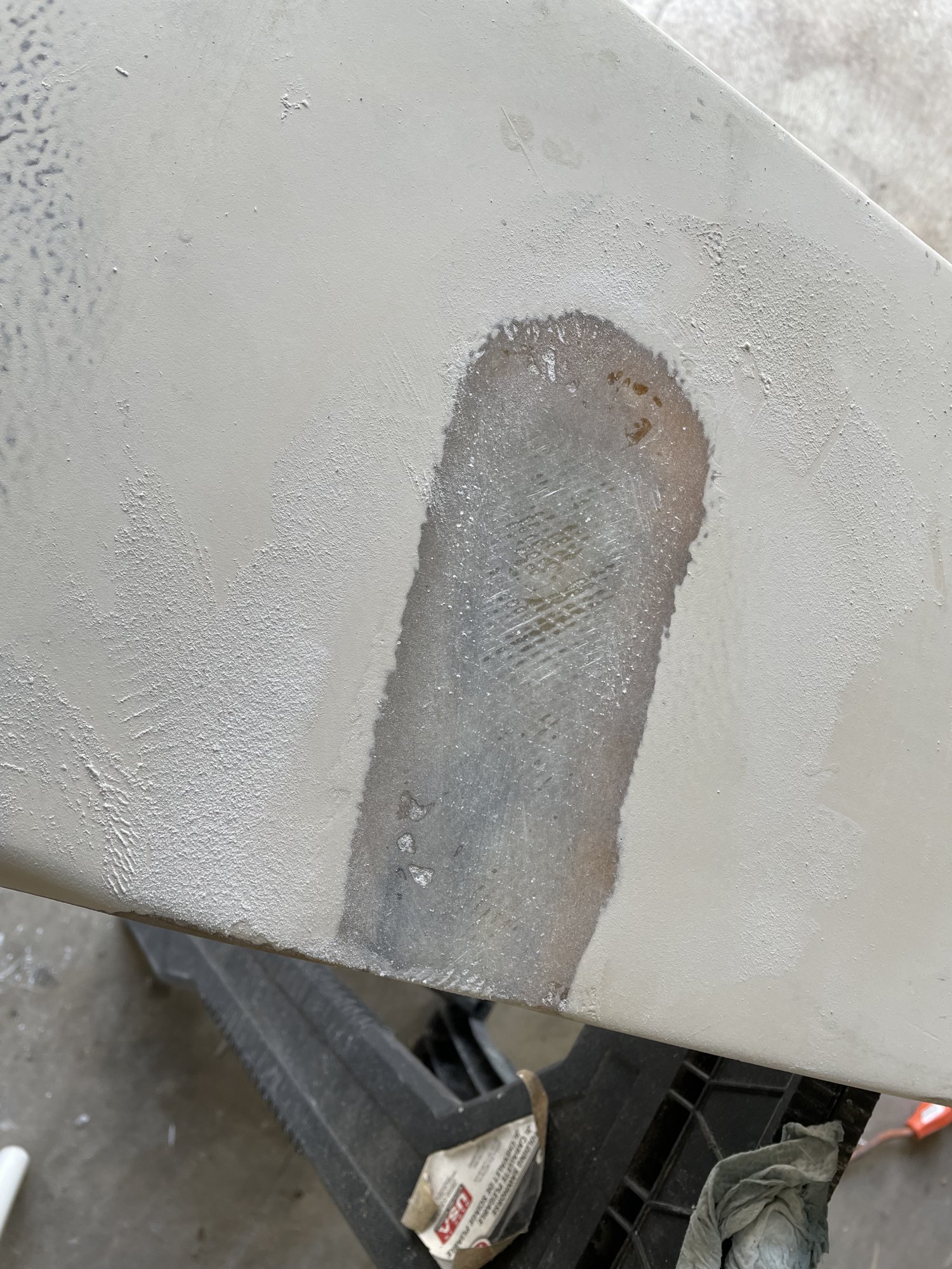

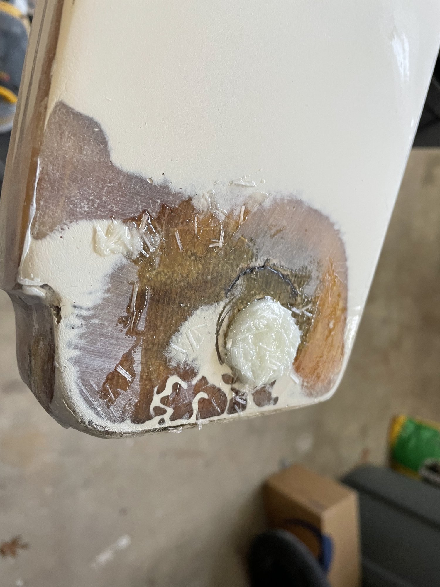

From the last picture above, best I can tell, I filled the holes with thickened epoxy, laid some chopped strand and some mat (1708?).

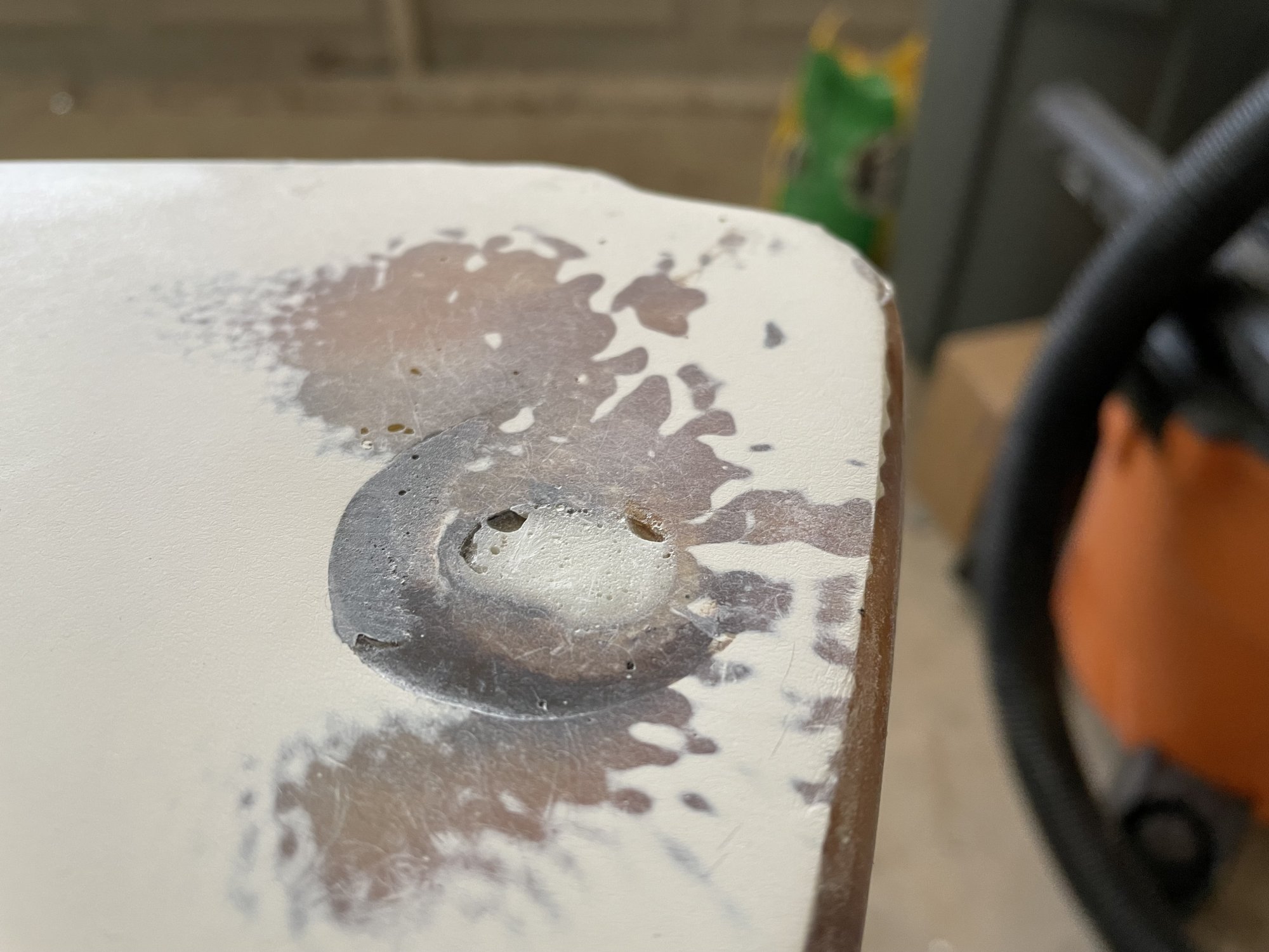

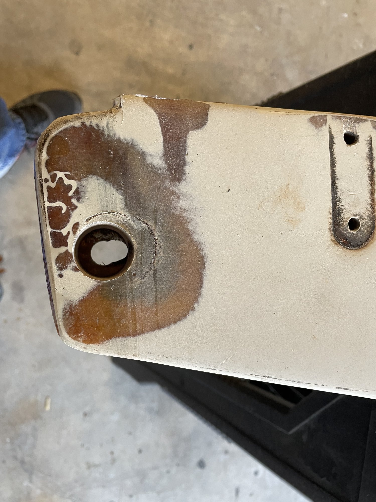

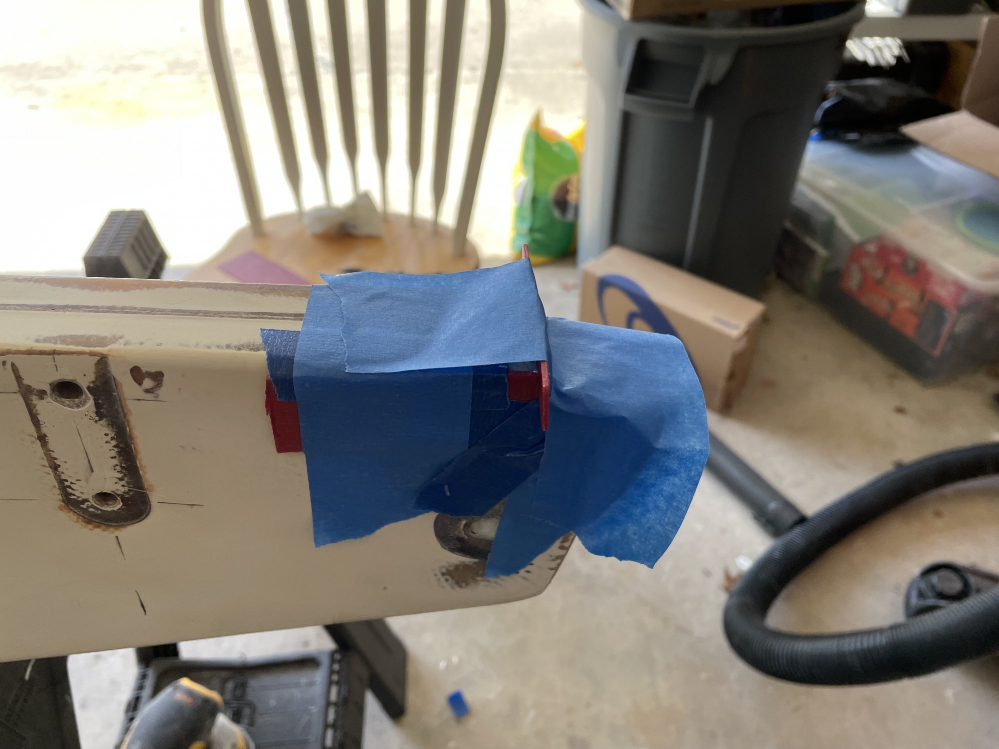

Then I used a forstner bit to drill out the 3/8" hole where the tiller mounts. The hole was elongated probably from people pushing down on the tiller. I didn't drill completely through the back side, so there was some fiberglass backing for the epoxy to bond with.
I used a mixture of straight epoxy to wipe the interior of the hole down, then I made some thickened epoxy with Chopped strand.
I forgot about how it expands and I ended up with this, but that vibrator cutter and some 80 grit on a random orbit sanded took it right off.
I built up the edge where the tiller arm rides on the rudder to keep it from rubbing on the back of the boat, The gelcoat is worn off and provides a nice light when you're under the cockpit (not really).

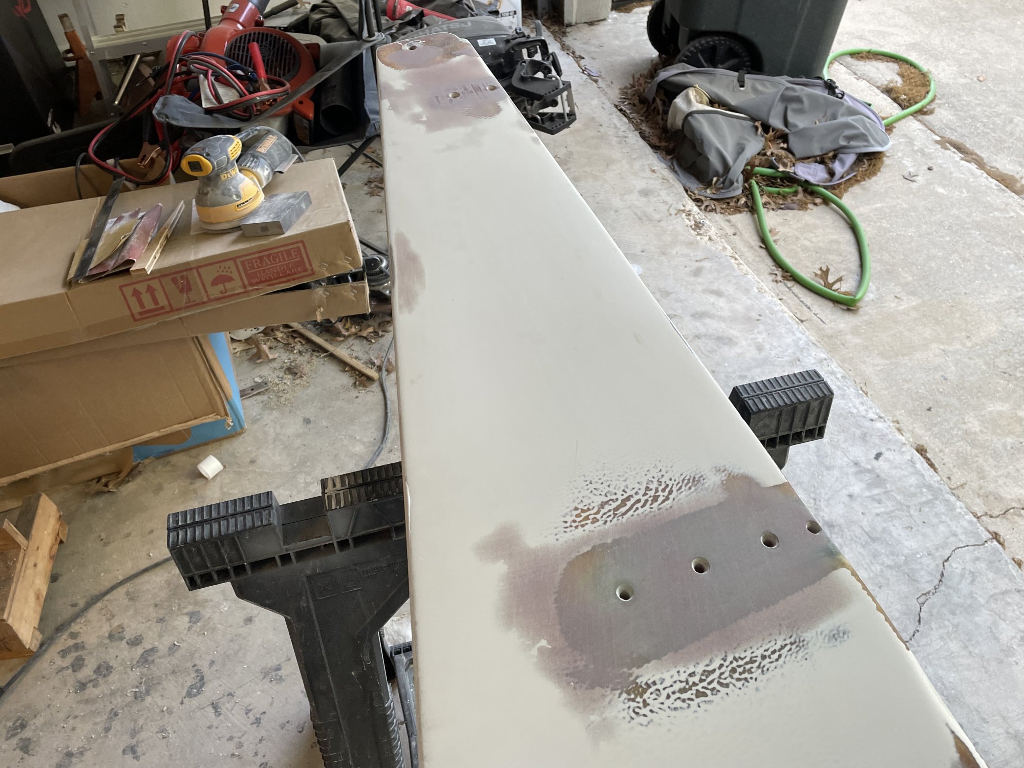

After this, I made some fairing compound, it mixes much like the cabosil thickener until it gets to a bondo like consistency. I faired the repairs and sanded it down, redrilled the bracket holes, then final sanded for painting.

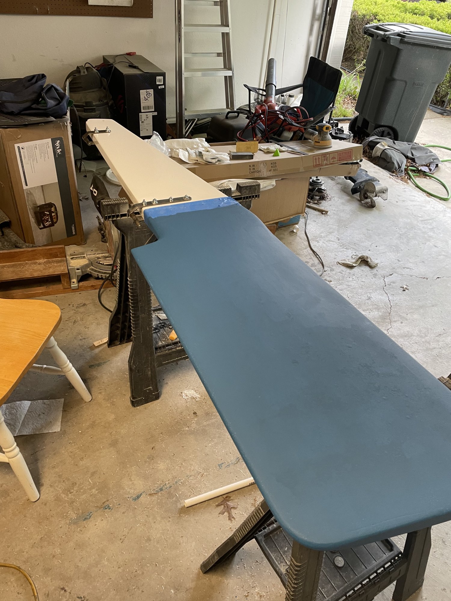

A bunch of paint later, the rudder is finished. I have to let it sit 24 hours before putting it on the boat.
