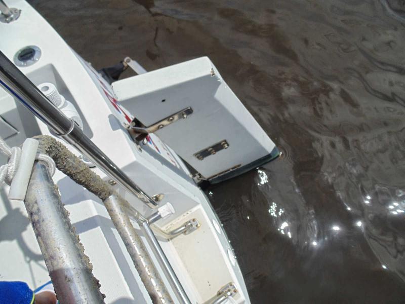

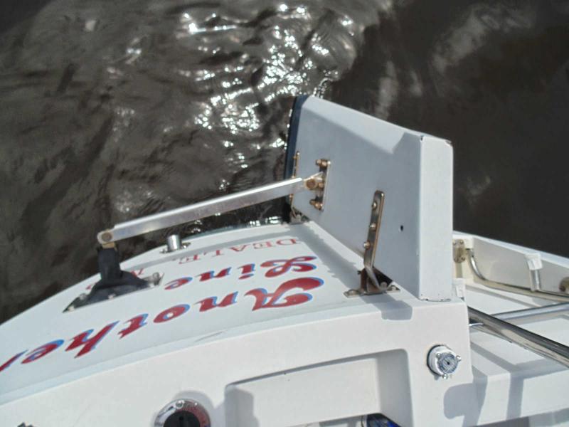

Although I don't have a 280 or 272, I do like to collect pictures for reference, figure they will come in handy, I guess sometimes they do!
The rudder for the 280 should be the same as for the 272 (actually same boat, just different deck). I have a picture of the 272 rudder, but no dimensions... I figured that you could estimate dimensions pretty good off the cockpit dimensions.... then I realized, no go.... the cockpit is different on the 280! OH Well!
If an owner of a 280 or 272 doesn't answer, you should be able to get the dimensions from Rudy Nickerson at D&R Marine (508) 644-3001, he was the Parts Dept. Manager at O'DAY and now runs a little shop suppying parts for our O'DAYs. I think he can make you a new rudder, and it will match the original, but although better than OEM, they are not cheap.

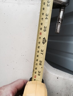

I have a 272 as well. I will photograph it with a tape measure overlaid tomorrow.

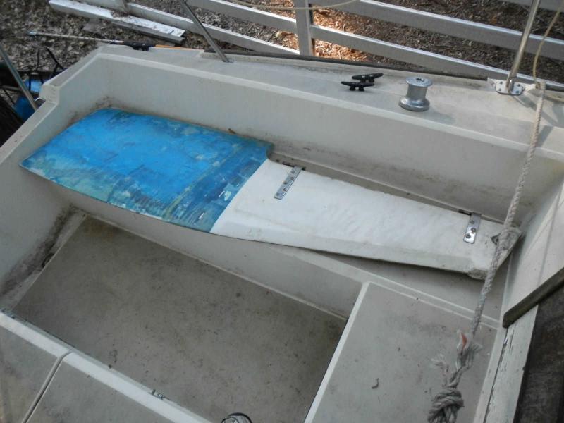

Thank you for the pics I now know the shape I hope to start building next week

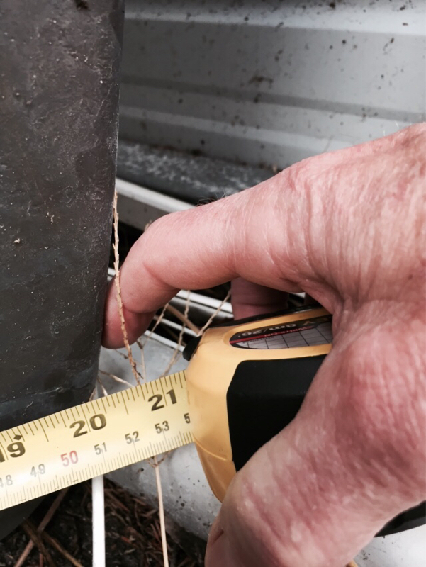

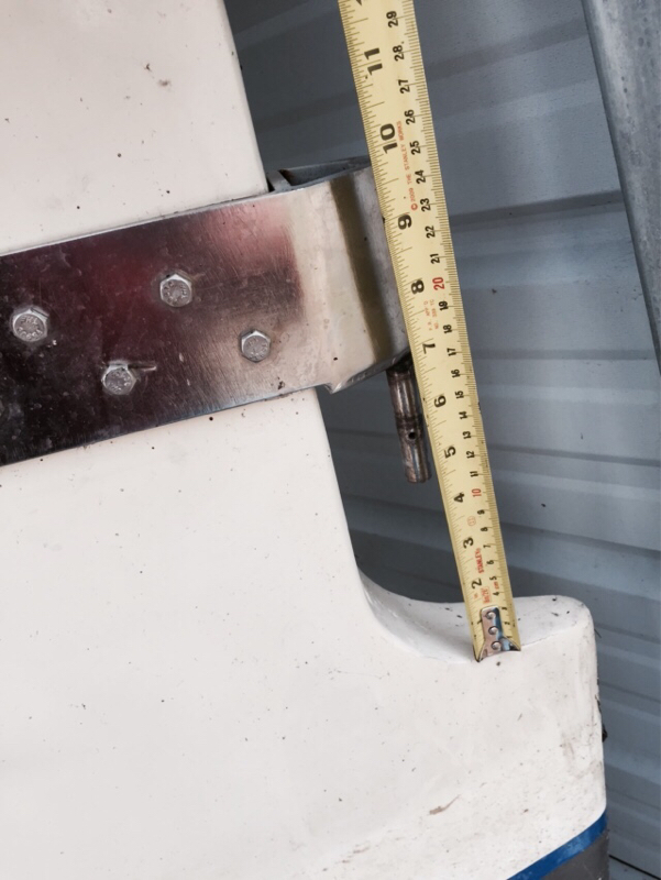

Here are measurements: image-2894343012.jpg image-1475574191.jpg image-1396411227.jpg image-3825163240.jpg image-4008697683.jpg image-2295674471.jpg image-543903594.jpg image-2182769926.jpg image-1960973170.jpg image-2457653675.jpg image-2049124475.jpg image-3890475109.jpg image-2201690983.jpg image-561515438.jpg image-203167185.jpg image-1704400233.jpg image-3821123264.jpg image-579142288.jpg Ok. Some of the photos are in pairs. The first shows which measurement I am taking, and the second shows a closeup of the tape reading. The 77ish measurment is the overall length. Good luck! Andrew
