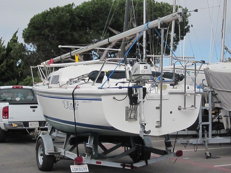

We remove our rudder also, because the mast crutch is installed there when trailering. We don't remove the outboard when trailering. I pull it all the way up, and then secure it with a small ratchet-strap and pull it up tight. This way it doesn't bounce at all, and is no problem for trailering, even hundreds of miles.
