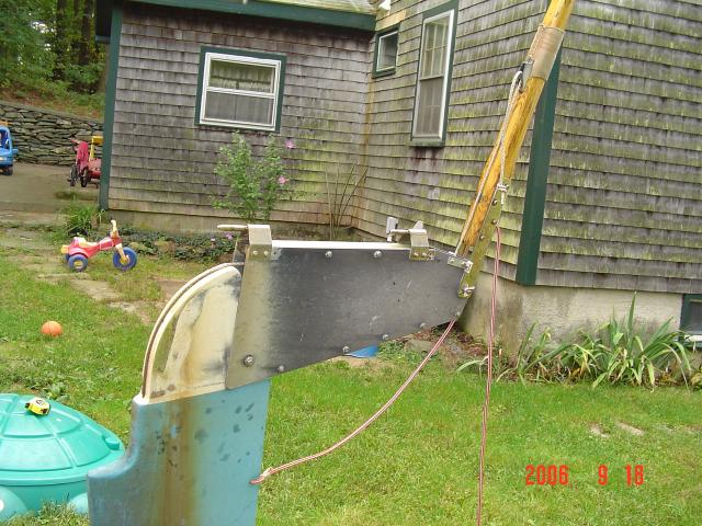

My DS II has the original all fiberglass kick-up rudder, so I can't really help. However, the rudder that you describe may actually be a DS II rudder, the later models (1983-85) of the DS II had a rudder with a wood blade and an aluminum top assembly (same as the DS III).
I'd say if all else fails, give Rudy at D&R Marine a call (508) 644-3001, he builds those rudders like yours and should be able to give you advice.
