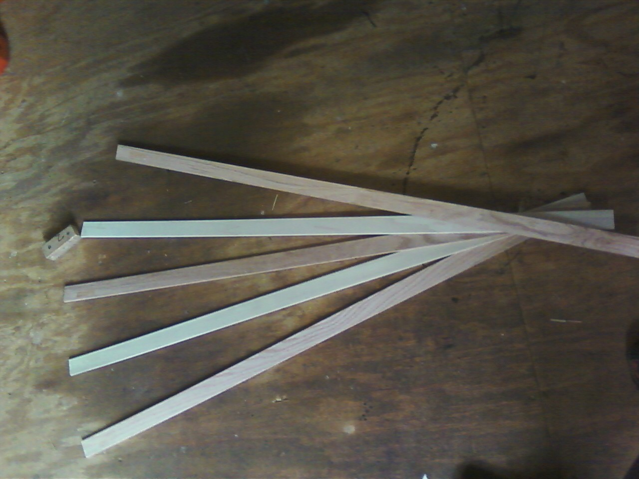

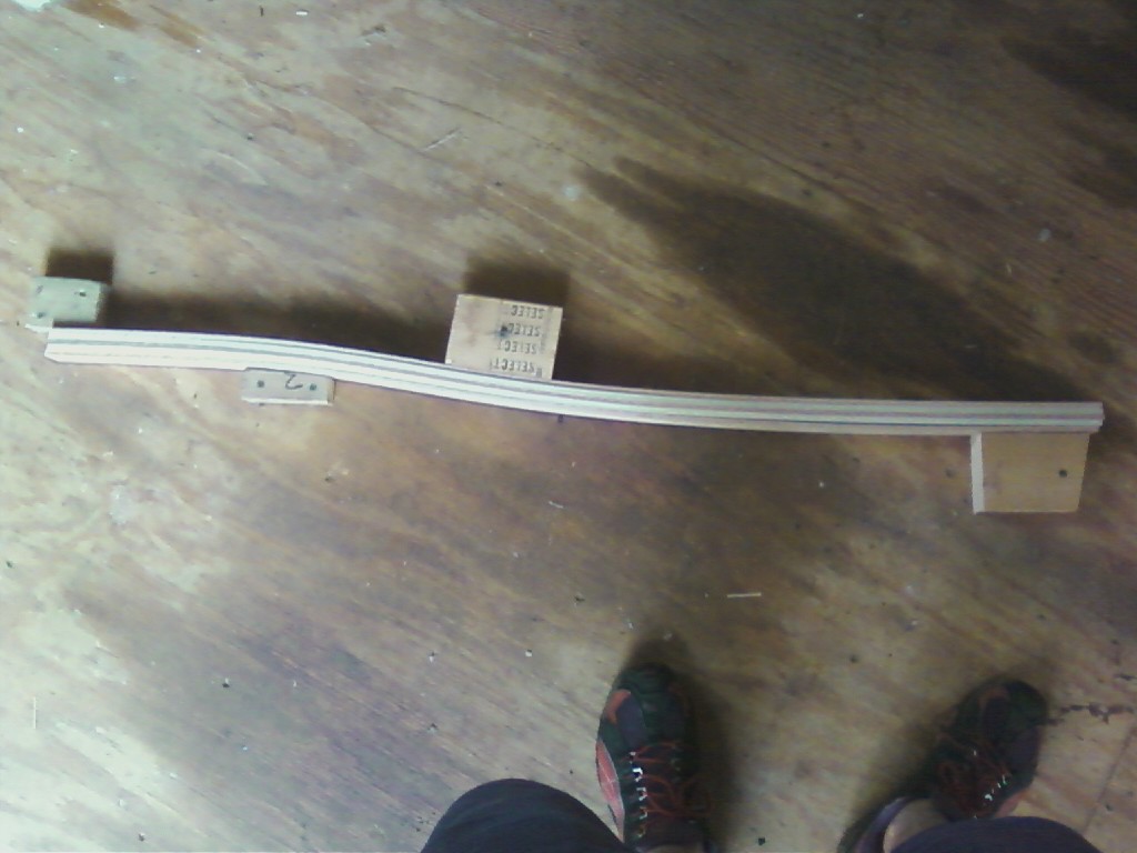

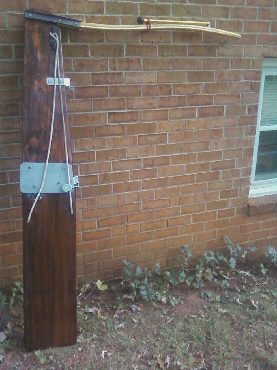

I made a rudder for a Mac 22. Can't find the pics right now but I started with two pieces of 2X12 boards. Glued them together to make a 4 x 12 piece and then using an electric plannar I gave it a NACA foil shape. It took less than an afternoon.
I also made a tiller handle... that I could find pics of. I started with some oak strips I purchased at Lowes...

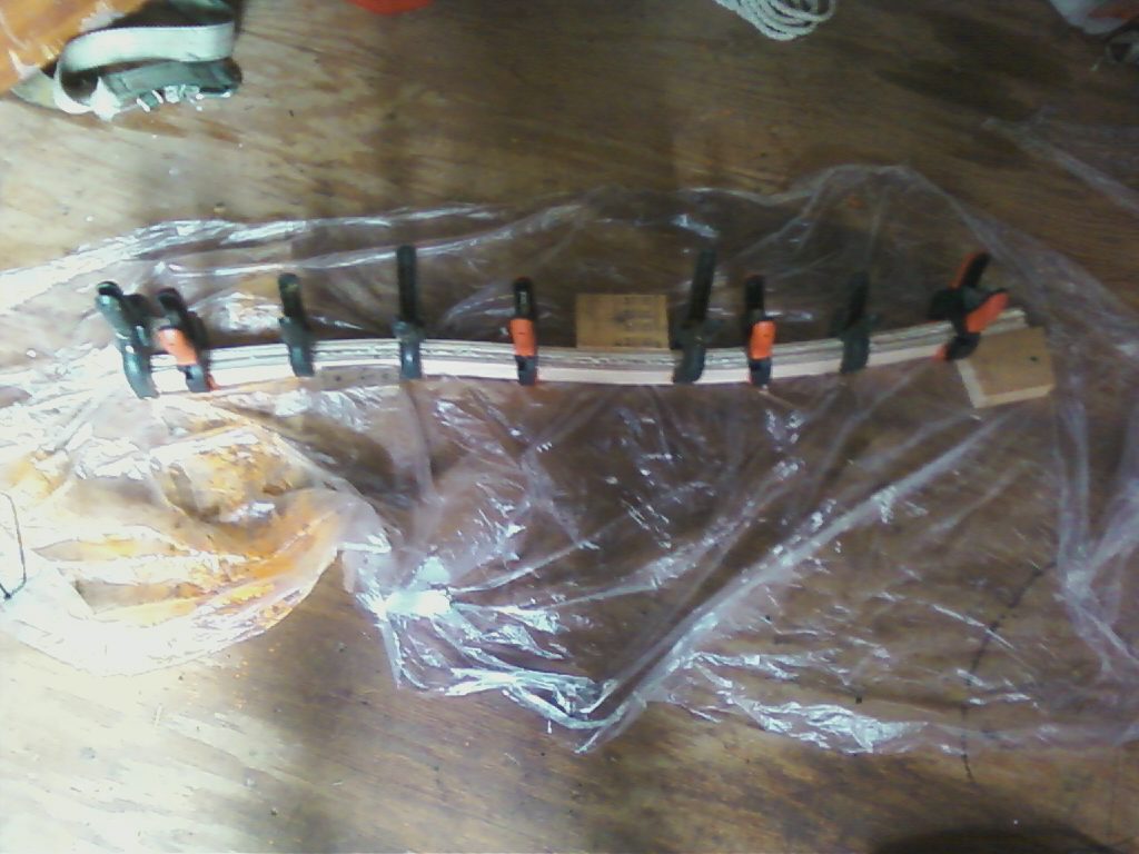

Then I made a jig by screwing blocks to the floor of my shed and glued the pieces together...

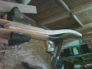

Put it in the vice and shaped it with a planar and some sand paper...

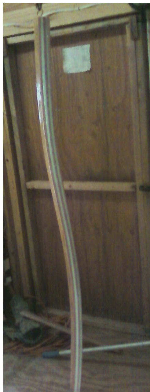

Several coats of varnish and...

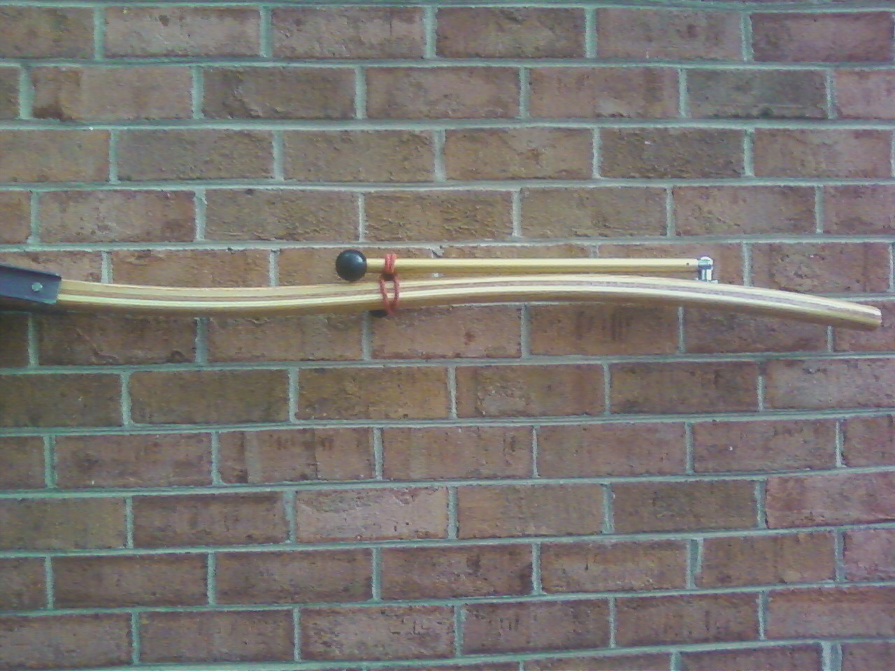

I had a new tiller handle...

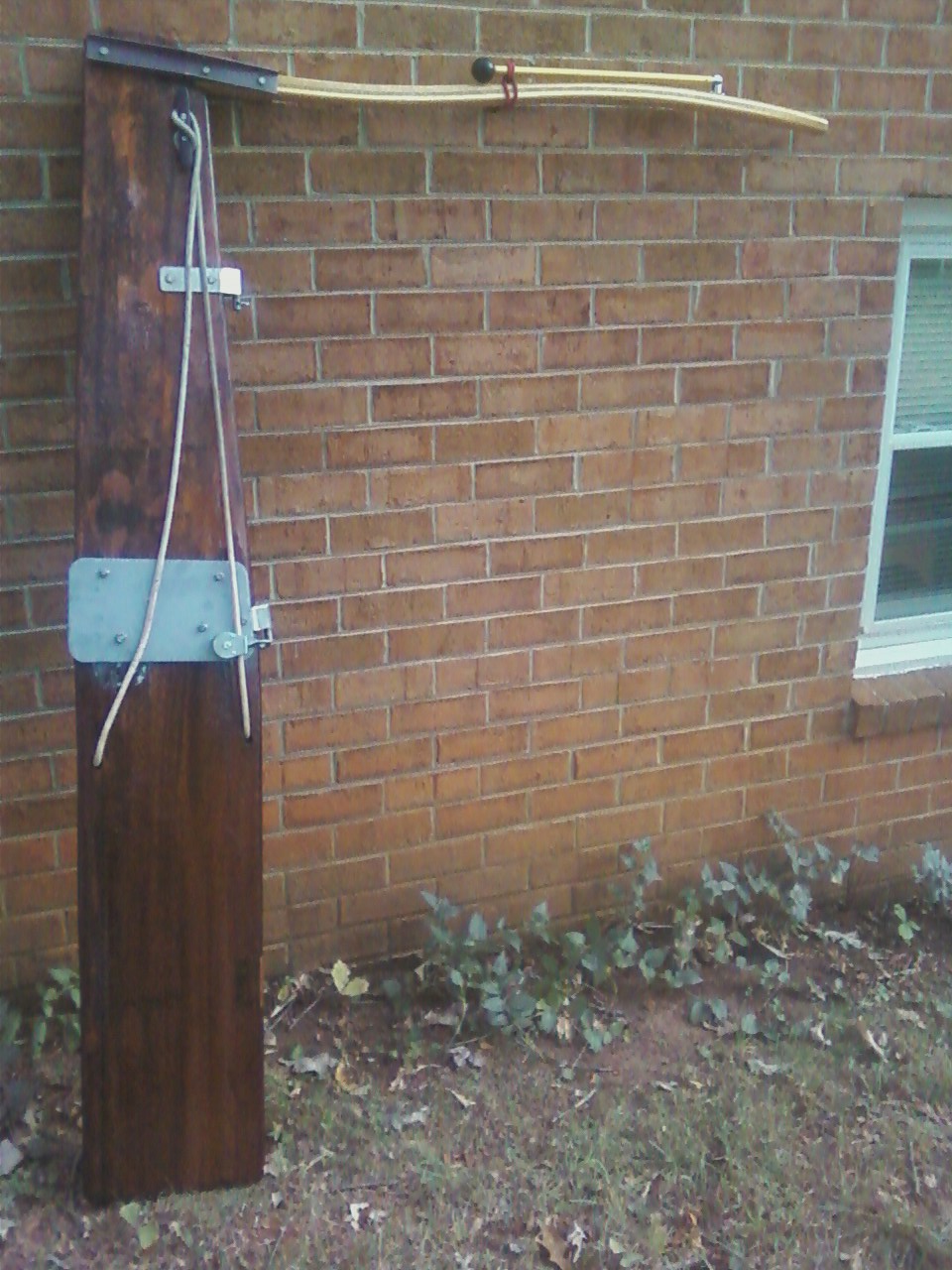

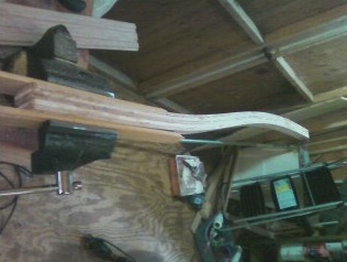

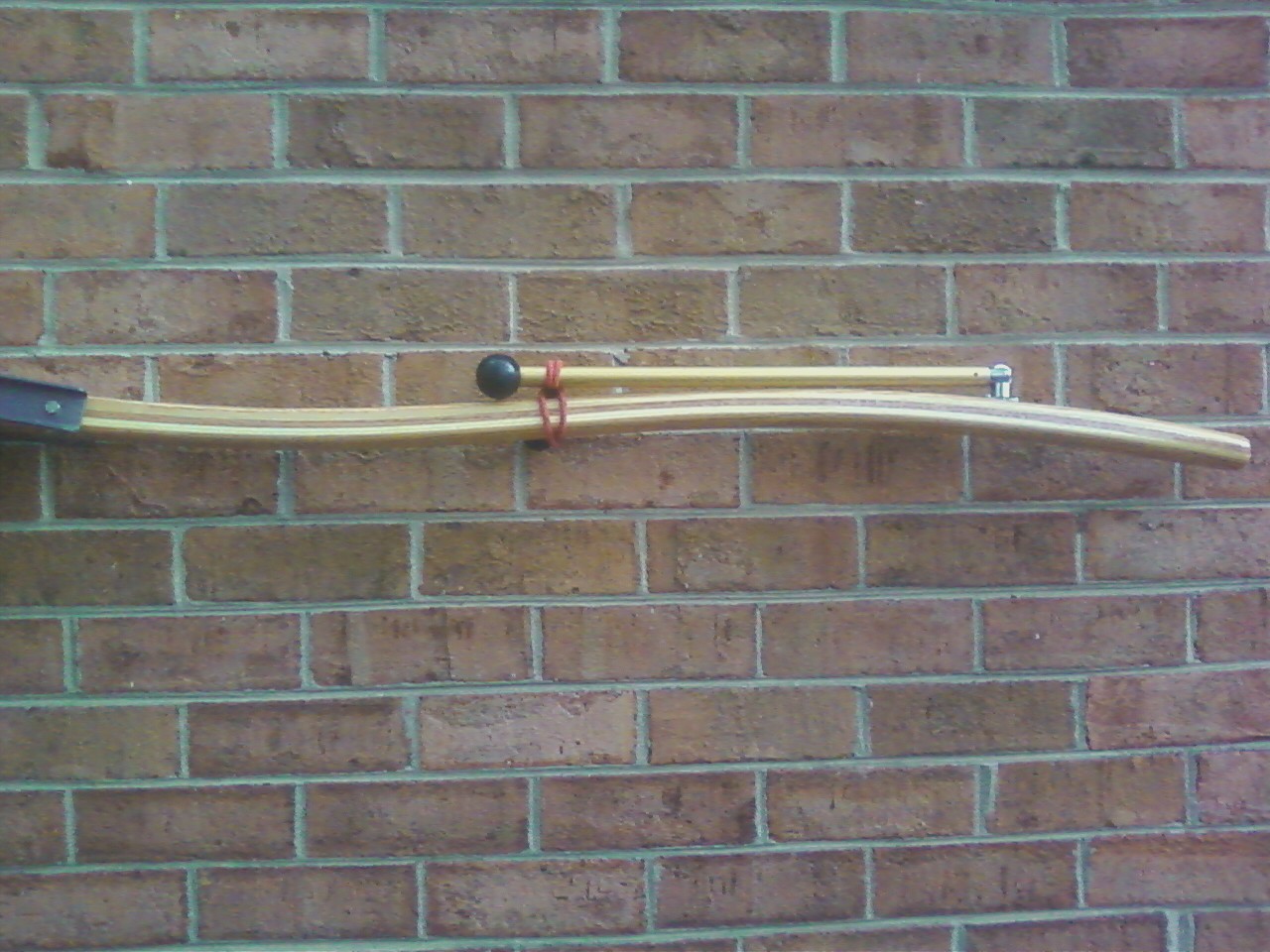

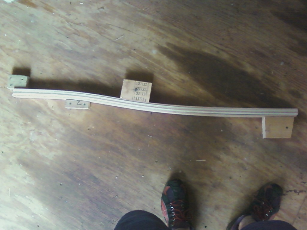

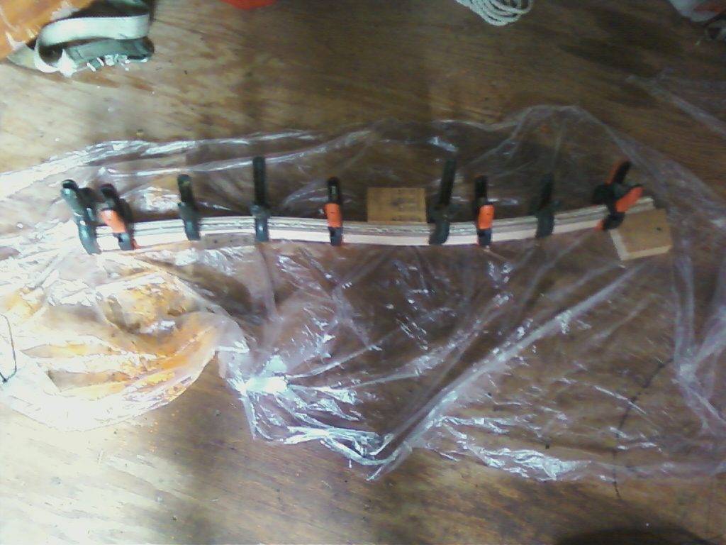

View attachment 181724View attachment 181725

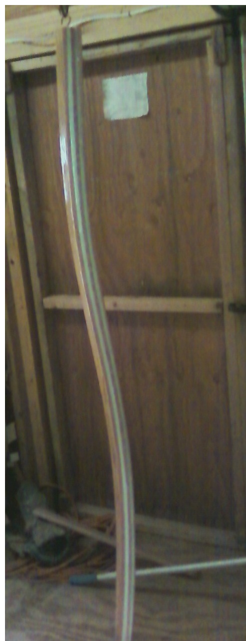

View attachment 181728View attachment 181729
Good luck building one. I think you can find some aluminum plate material at Lowes and the rest is just time and patience.
