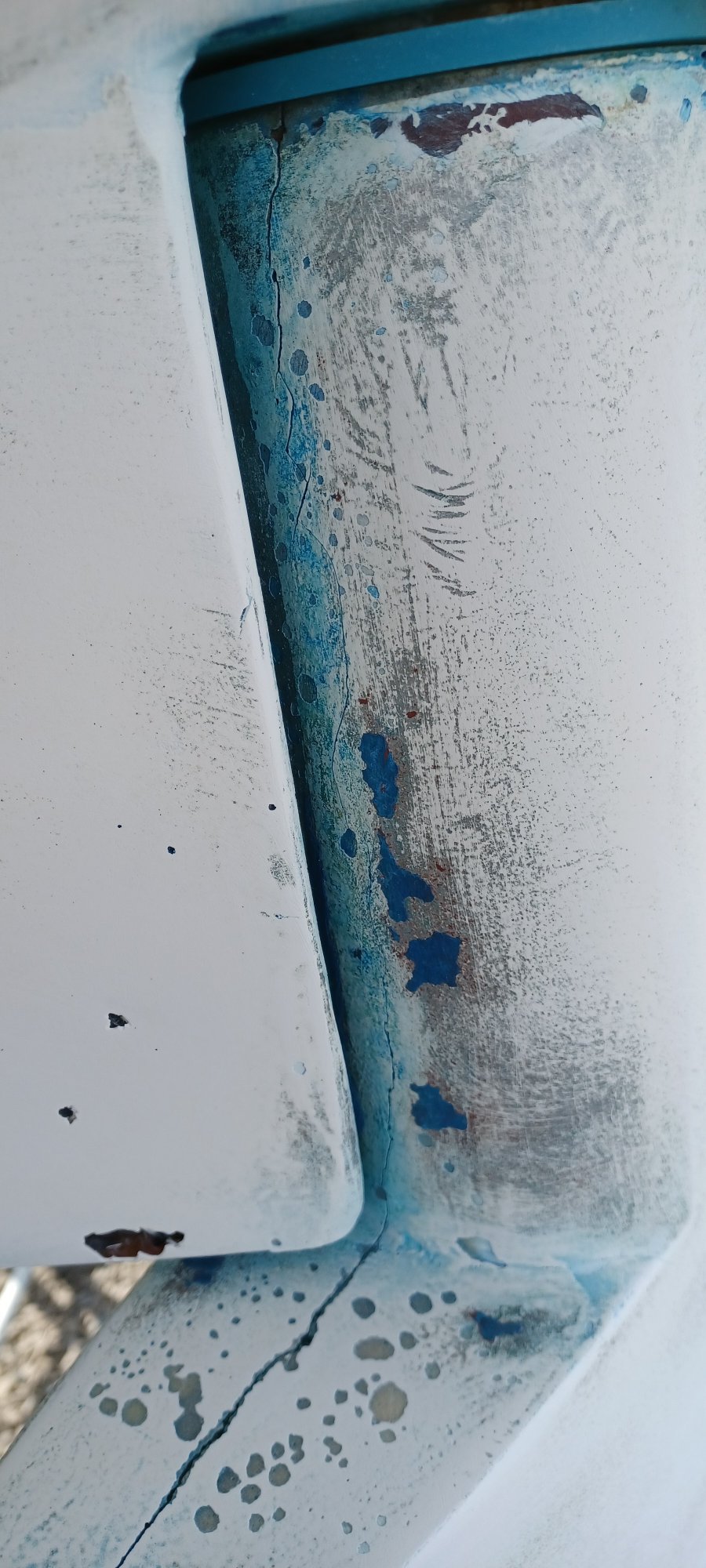

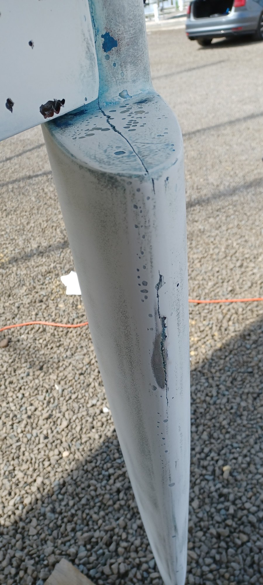

Recently purchased 2000 34mk2, decided as part of our total rigging refit to strip back 22 years of bottom paint and sleep better at night knowing what the previous 2 owners had done or not to the boat. We discovered grounding damage to the keel and rudder(could be 2 years old, or 18), both repaired at the impact sites. We discovered on the rudder there is a hairline crack from the post down about 10 inches on the leading edge, I am assuming this damage is from the impact and has resulted in water penetration, but to what extent we do not know. I understand there can be other ways for the crack to have formed and for water to have entered as well.
In any event, before getting everything barrier coated I'd like to make sure I do a proper repair, the yard suggested to die grind it back and lay up some new glass then barrier over top. Any thoughts? I put my moisture meter all over the rudder and found no elevated readings, and no water came leaking out when they walnut blasted the bottom indoors over the winter and exposed the crack. I don't know if this crack has been stable for 10 years, or if it happened last year if that makes any difference.
Photos attached. Thanks in advance for any knowledge!
