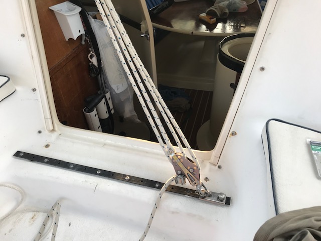

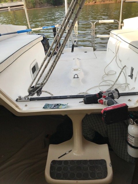

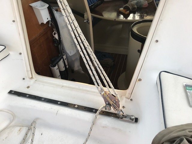

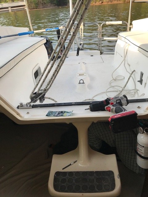

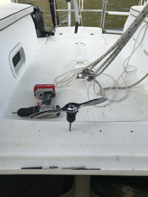

Here is what I did with my H26. I added the traveler at the bridge deck.
View attachment 219621View attachment 219622View attachment 219623

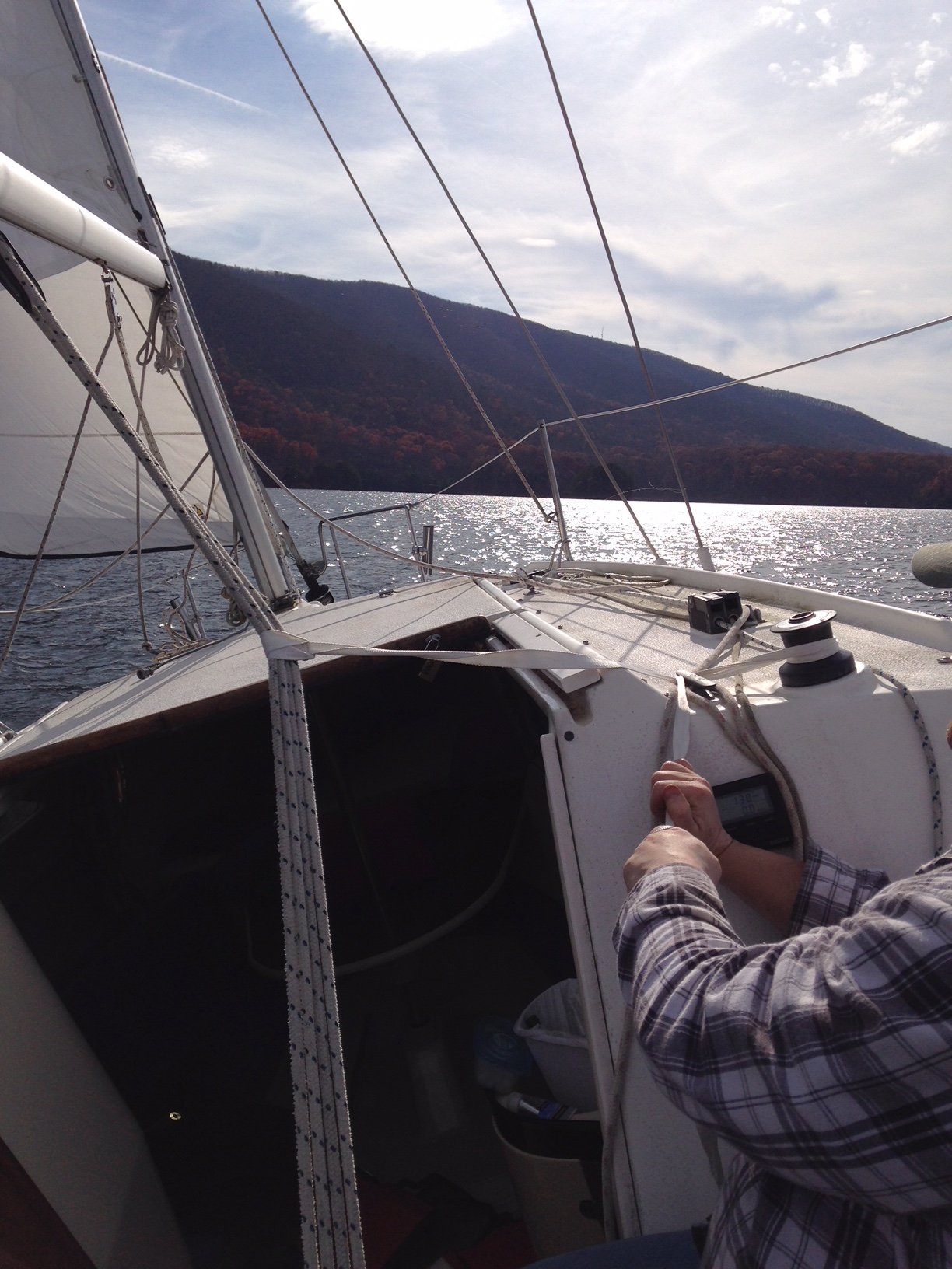

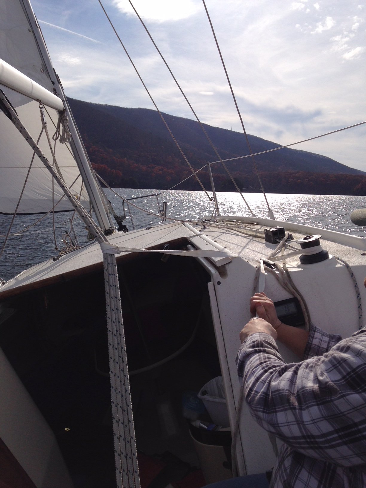

But if you want to conduct an experiment and see if swinging the sheet to windward and then letting the boom out helps.... you just need to take some line around the sheet and physically haul the sheet over... then let the boom out. Here is a pic of me doing this on my H26
This approach will not give you the full effect of a traveler but it is a good experiment to see if a traveler might give you the performance improvements you are looking for.
