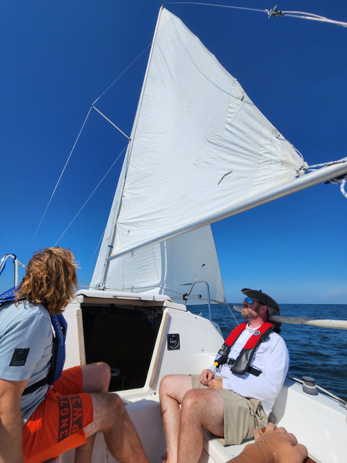

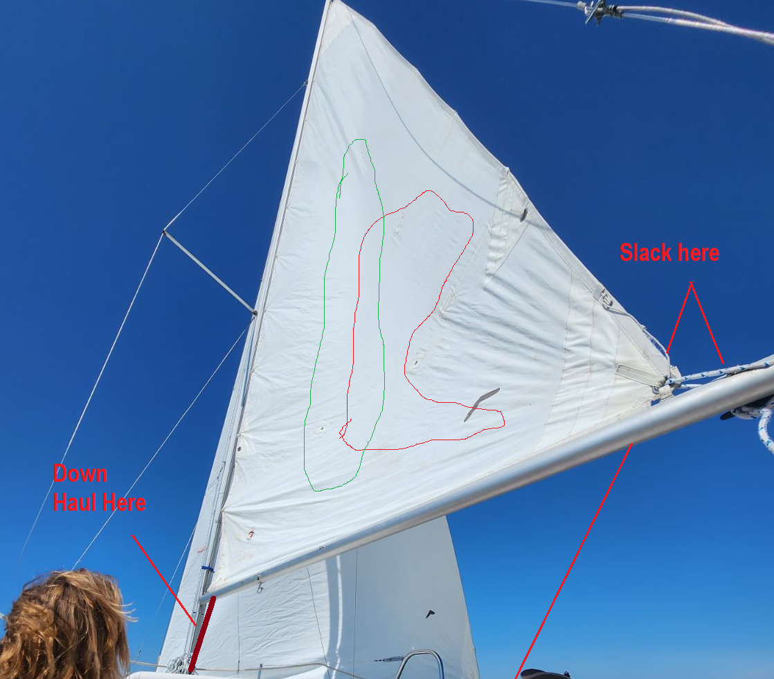

The sails are younger than the boat, but also not new. They're Rolly Taskers and don't look too shabby. The best shot I have of them in use is here;

Judging from your photo and video, it does not appear to me that your sails are blown out. I do see some issues with the mainsail, as outlined below.
Balancing your rig (sails and steering) are a good starting point. An airfoil rudder is a good step - when I replaced my stock rudder with one I did experience less weather helm and overall turbulence.
In my experience, excess weather helm is caused primarily by an overpowered mainsail. Experiment with mast bend (if your boat is equipped with an adjustable backstay, that is). Tightening the backstay flattens the mainsail, depowering it and reducing weather helm. This could help even in moderate breezes. It's possible that tightening the upper shrouds could accomplish this, but I would not see this as an ideal solution (to difficult to change in changing conditions.
In your video and photo it looks like the luff of the main is a little slack. This is the functional equivalent of tightening the cunningham, as it creates more curve in the sail near the intersection of the mast and boom, increasing power. Too much power at the main is a major cause of weather helm. When sailing in anything greater than light breeze, I would suggest you get that main halyard good and tight so there is no slack in the luff. This is not easy with your rig. Before I led my halyards aft (allowing me to use the winches to tighten the halyards), I used a snubbing winch on the mast to help with this, but these are not easy to find. Perhaps a clam cleat above the horn cleat on the mast will help hold tension while you get the halyard cleated off?
I find that fresh breeze means time to reef. I don't like to reef because wind speeds vary a lot on my little lake, but in your case it may be the thing to do. Flying too much sail will work against you, as your boat's hull speed will ultimately limit your potential speed. A properly balanced rig will give you better speed since it cuts down on turbulence at the rudder and windage from heeling.
As previously mentioned, keel angle will affect the balance of the boat, so once you have addressed your overall sail tuning, start experimenting with keel angle.
I use a quick-release clam cleat (Clamcleat CL257), mounted on my tiller. Holds the rudder down nicely, releases under stress, adjustable. I have not had to buy a new hold-down cable since I installed mine. Hard to find, but available on Ebay: Clamcleat ® CL257 Auto Release Cleat for Rudders 5024220125706 | eBay
The downside of decreasing weather helm in your case is that you might have to change your handle from "Heelboy" to "Sailing-at-25-degrees-tilt-or-less boy". Or not...
I have no experience with auto helms, so can offer no insights in that regard.
Best of luck, and happy sailing!

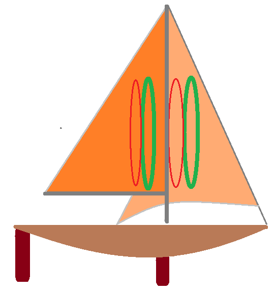

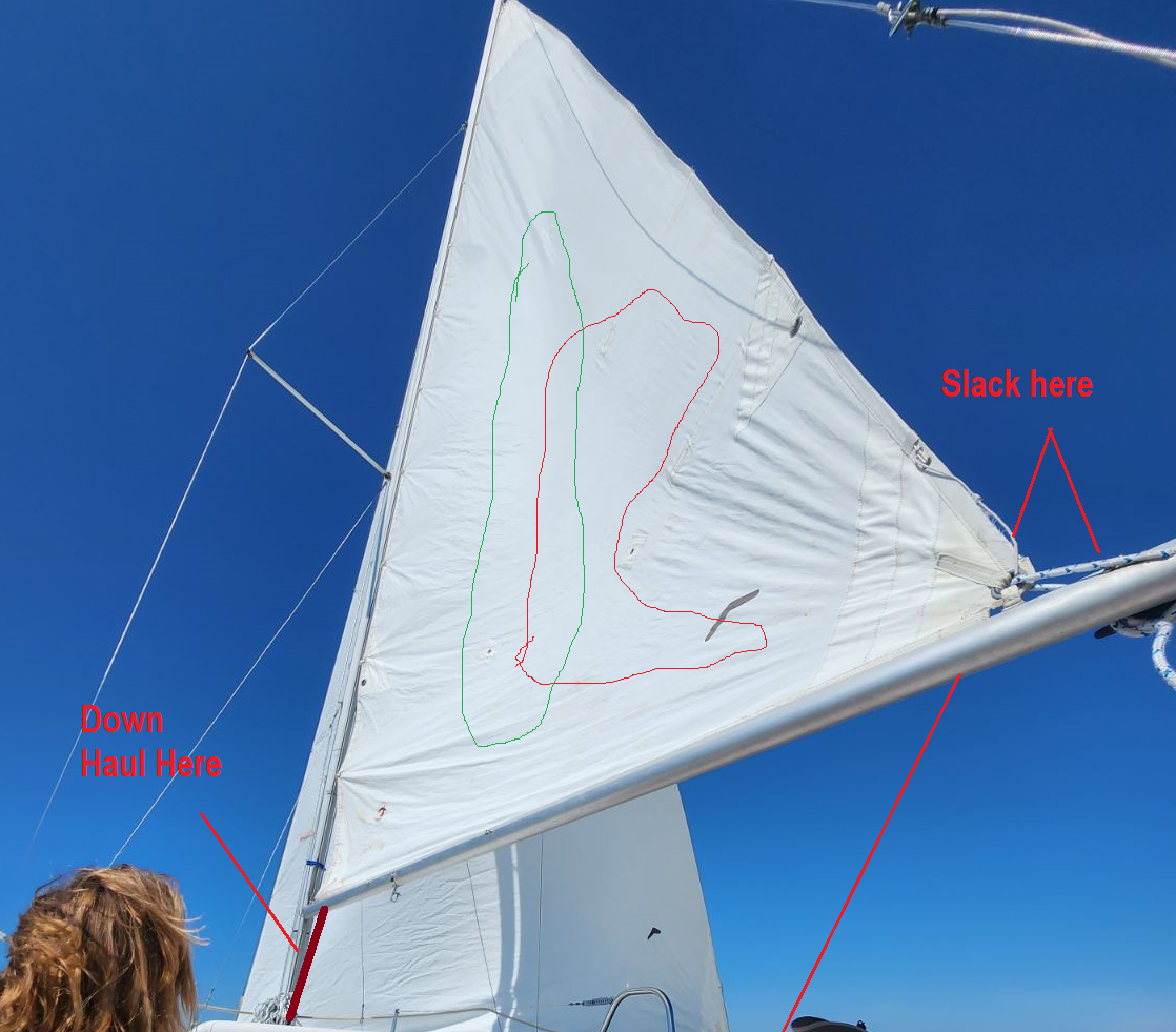

You want the pocket to be about where I drew the green ovals in this image
And those sails look tired. But I see a few things that might help. Right now, your pocket is where I drew the red lines.. you want it where I drew the green lines...
First you need to get the luff flat. Add a down haul and pull the boom down just enough to get the crinkles out of the luff. The crinkles near the clew are also a sign of a poorly bent sail. I think your out haul is too tight. Try slackening the out haul until you see the pocket move forward a bit and play with the down haul and the out haul and try to get the crinkles out of your sail. You can also get stick on tell tails. These will really help you see the wind moving across your sail. They are cheap...
It also looks to me like your jib sheet is too tight. You want to fatten up the head sail... keeping an eye on the pocket. And I can't see your head sails luff but make sure that is also crinkle free. Look at the sails in my avatar picture as an example. Also, your main does not have battens... I think you will find a lot more joy for the money if you start saving for a new main sail instead of investing in a rudder modification. The M25 was designed correctly when it left the factory so I doubt your troubles are from the rudder. It might just be the way the photo was taken but it also looks like your main sail's foot is too short for this boat.
Likes: HeelBoy

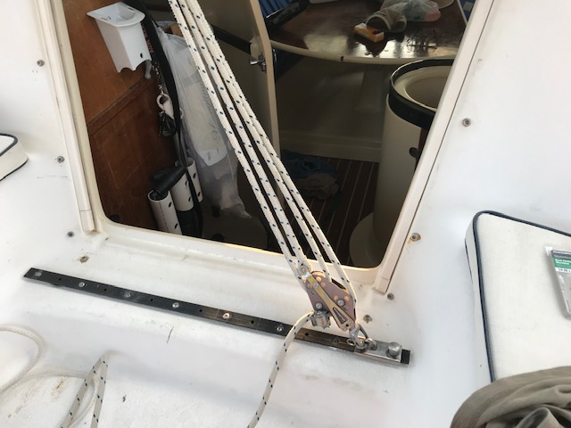

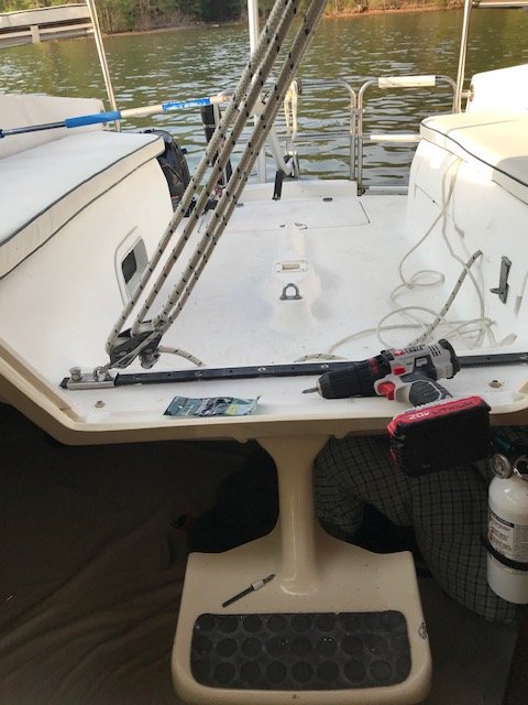

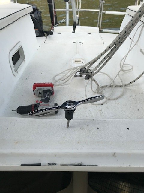

Also is the bucket of parts is parts for an lines-aft kit. I hadn't considered using the winches, but that makes perfect sense. I'm holding off on the install until I summon the courage to spend $ on rope clutches.

I greatly appreciate this input! A couple of things first. The main does have battens, 4 of them. Also, the Foot is something of an optical illusion due to the fish-eye pano lens that this photo was snapped with. Spacing of near objects is wildly distorted and the clew was just a few feet from the camera.
A downhaul would probably be a great help. I wail on the main halyard to get it tight, but I'm against the mast head. I never would have though of slackening the outhaul, so thank you also for that.

You will like halyards led aft, especially if you can use a winch to tighten them. I HIGHLY recommend the Lewmar D1 double. Yes, an investment, but vastly superior to other designs. The "domino" design is easy on the ropes, and allows tightening even when fully locked down. Genius.
If you can get your mainsail luff tight using the halyard, that will obviate the need for a downhaul.

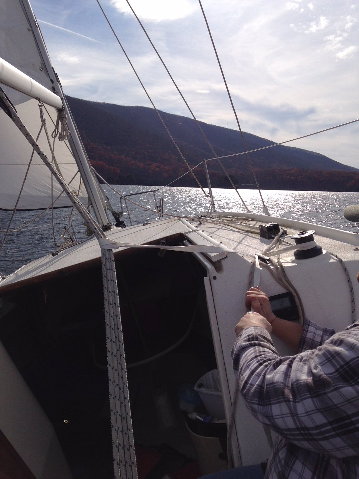

Here is what I did with my H26. I added the traveler at the bridge deck.
But if you want to conduct an experiment and see if swinging the sheet to windward and then letting the boom out helps.... you just need to take some line around the sheet and physically haul the sheet over... then let the boom out. Here is a pic of me doing this on my H26
This approach will not give you the full effect of a traveler but it is a good experiment to see if a traveler might give you the performance improvements you are looking for.
