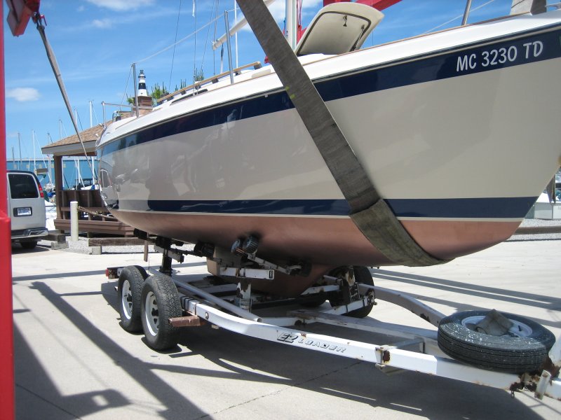

A fine grit, 1000+ sand paper gets through a HEAVILY oxidized gelcoat quicker.
Then compound/polish/wax. There is no shortcut to success.
Here's the deal though. You can grind through the gelcoat, so be careful, come coats are thin.
This should give you an idea of what I am talking about. On this boat I only used rubbing compound (bright red)... this is ONLY after that.
Where the chalk was heavier (stern mostly) I wet sanded at 1000 grit first, then rubbing compound then polish, then wax.
I used nothing fancy to do this, just Turtle products, including turtle wax (yep it held up nicely for a season, and I only had to rewax per season).

RBone another member here followed my instructions and this is what it can look like..
Right tools, process and products.. He had very little buffing experience before reading the instructions and doing this..
