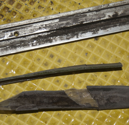

I have a S2 8.0c. It has aluminum rub rail. Between the rub rail and the fiberglass, there seems to be a plastic material. It is deteriorated and brittle. It may be double sided tape or a gasket of some sort. It may have been used in the installation process. I do not know. Does anyone know what this is or why it is there? I want to reinstall the aluminum rub rail. The rail is not in too bad of shape. Do I need to find this material and reinstall it? I have 1/16th inch rubber. Is that a good material to use between the fiberglass and aluminum? All suggestions are welcome.

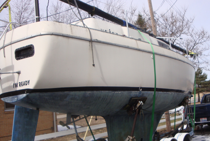

Here is a picture of the aluminum rub rail. Yes. The plastic tape/gasket was between the aluminum and fiberglass. It may not be a gasket but might be a double sided tape that held it on when installing the rub rail. I am not sure if it is really needed.

For clarification, the 1st picture is the back side of the rub rail.
