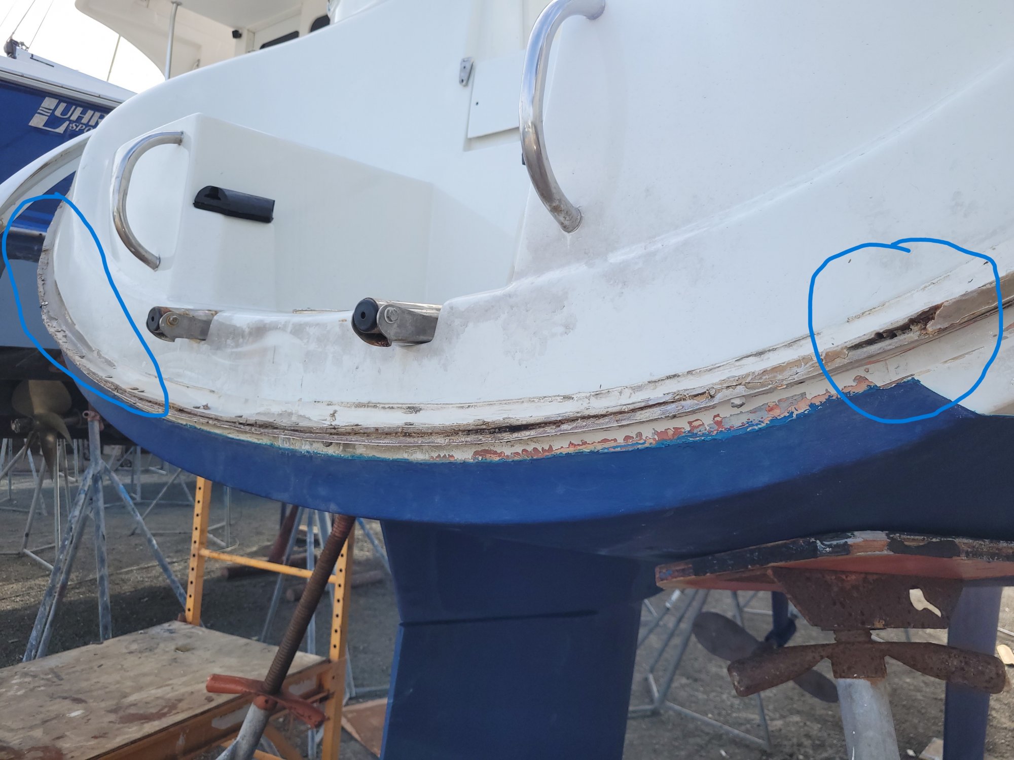

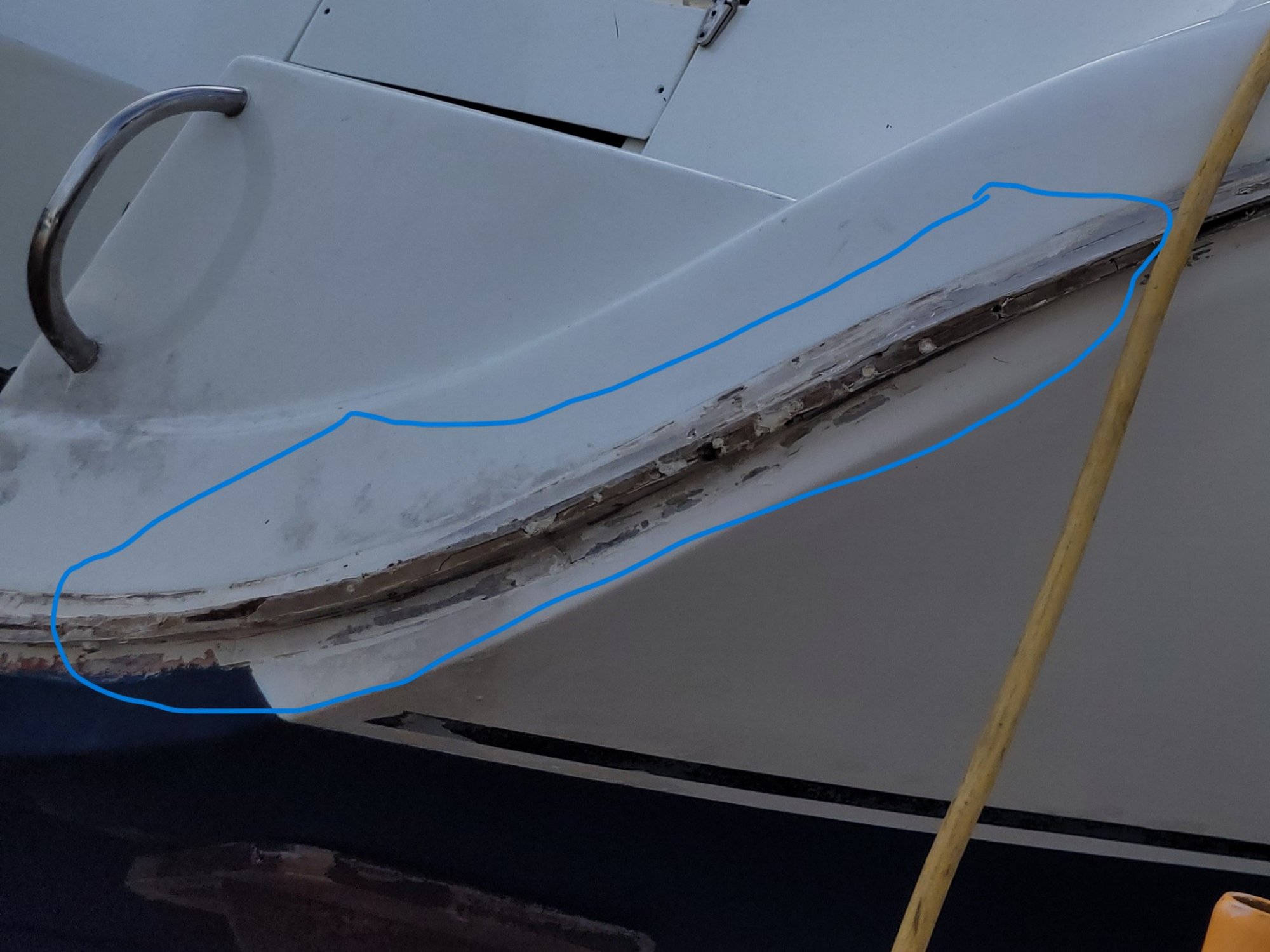

Hi All, I figured I'd keep the thread going!
Attached are two photos from the stern which show the leaks. It also shows some form of work done on the Port and Starboard side where they covered the gap between hull and deck. Interestingly enough two different materials were applied. The question is: Is this normal or do we suspect that this was repaired before? The starboard side is a very hard material and the Port side is a more soft one.
Following info from threads my plan is to clean the gap thoroughly (with acetone), fill it with 4200 then seal the gap. Plan is to remove the material currently applied on both sides the best we can.
I've found different suggestions for materials to seal the gap. Would appreciate any thoughts on this matter.
Once complete we'll pressure test using the blower to find possible other leaks.

The yard recommends only applying 5200 and not covering the edge with glass since it can crack when hit. I'm still looking for an alternative to put over the edge after applying 5200.
