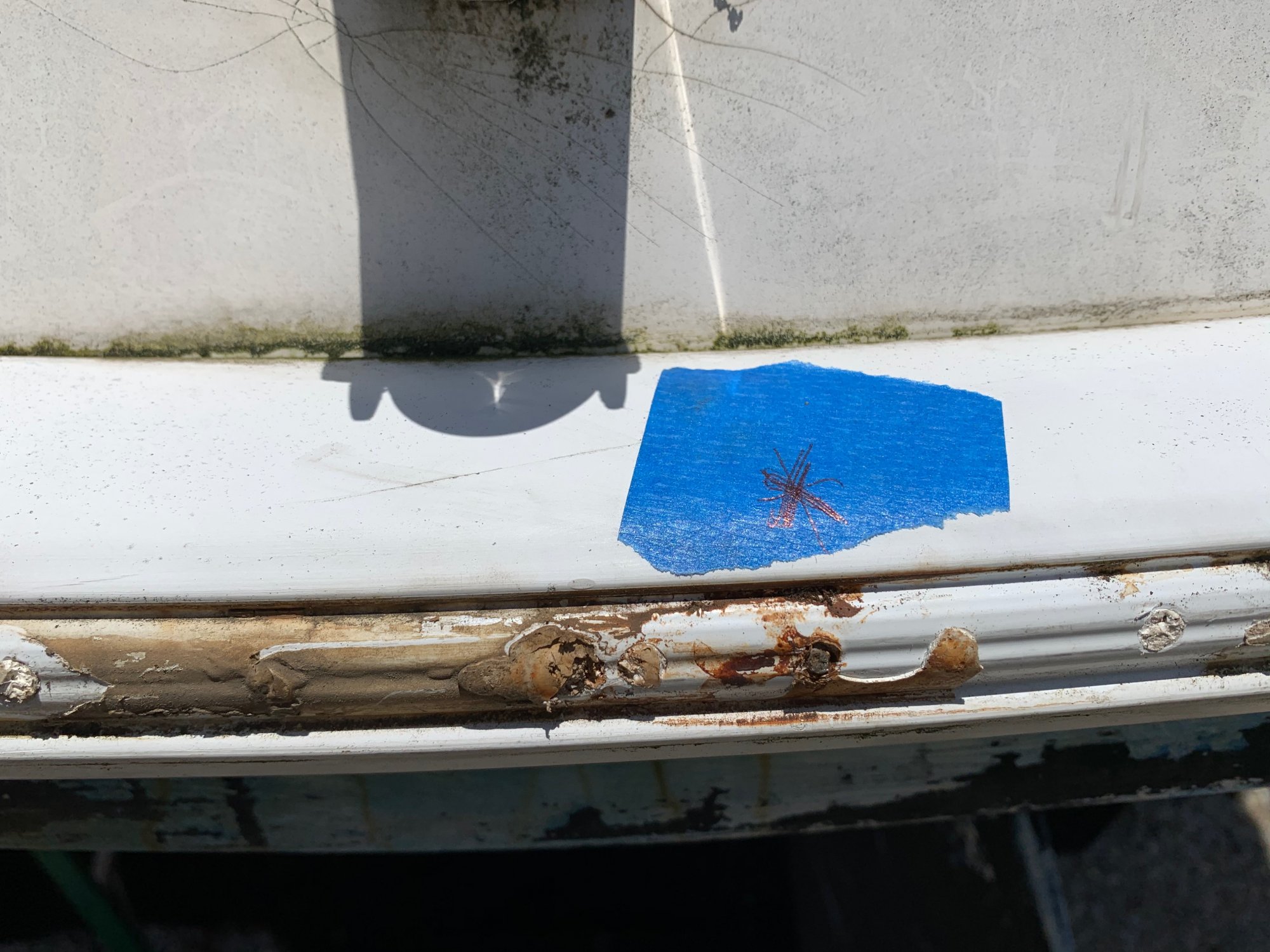

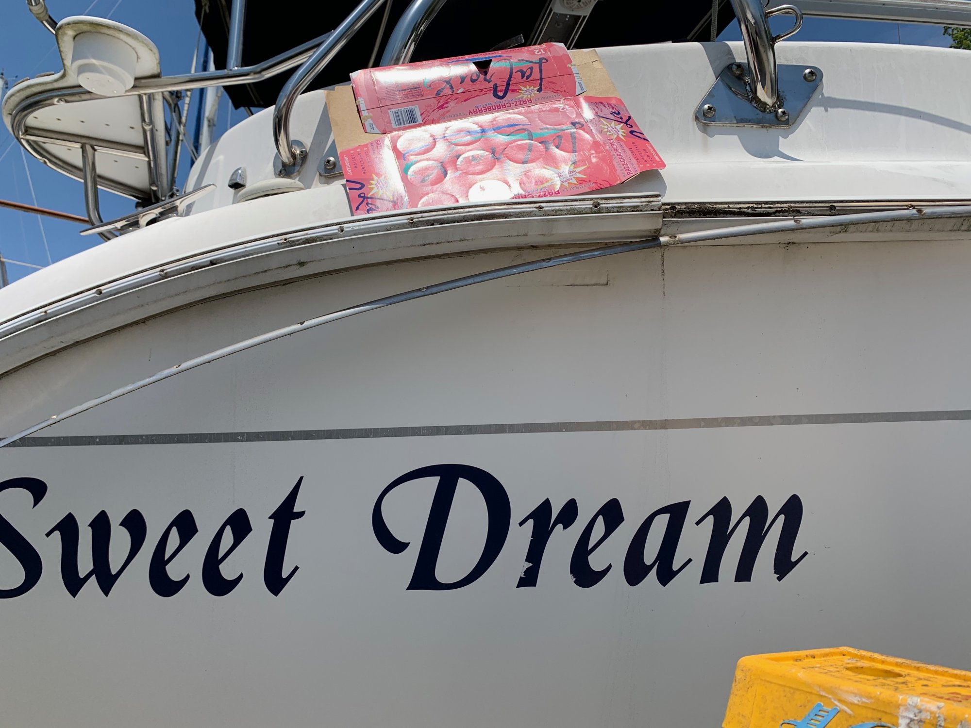

Behind our (Hunter 306) aft cabin, I've seen something like 3 or 4 water trails coming down from the hull/deck joint when it rains, all of which either end up in the bilge, or under the teak panel which separates the aft cabin from the holding/fuel tank space. This has caused the teak plywood panel to delaminate and get nasty over 15 years or so. I'm mostly done with finishing the new panel, but it was time to address these leaks.

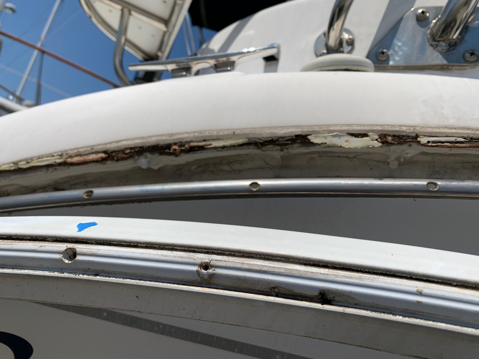

So I finally started pulling off the rub rail on the stern the other day. It's one of the very hefty white rubber rails with a narrow stainless steel strip screwed on the outer edge. Fortunately, the rub rail is in 3 sections, and the aft section starts a bit aft of mid-cockpit on one side (near where the arch is attached) and runs across the stern to the other side of the cockpit. So I only have to do the stern section, and not the whole thing. The stainless strip is attached with very shallow screws which are very easy to remove (except when the heads come off, which happened to 3 of them). I don't believe these even penetrate the rubber, so they're unlikely to be the source of leaks. I started by removing the stainless rail up to the joint in the rubber, and about 5 screws beyond, just letting the steel hang.
Under the steel rail, they countersunk longer stainless screws (hidden by the steel rail) which were at least intended to screw into the 5200 in the joint between the deck and hull. These seem to be spaced at intervals of about 10-11 inches. I marked them with bits of blue tape (for reasons I won't try to explain) which you can see in the pictures. Once these were removed, the rubber rails came off on port and starboard sides with only moderate prying for the most part, but then I got really stuck trying to get off the 5 feet or so along the stern, under the boarding ladder. There were a few broken off screws there, so I thought that must be the problem:

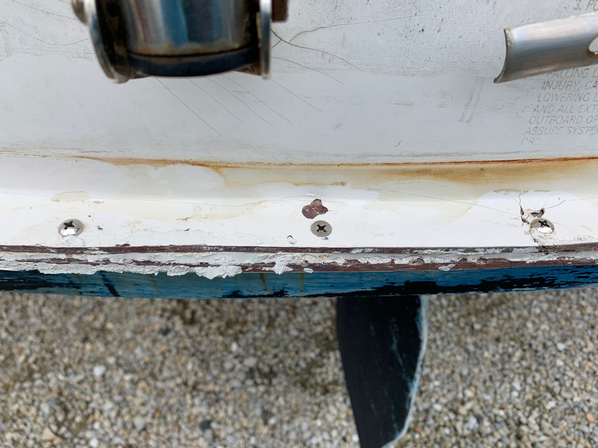

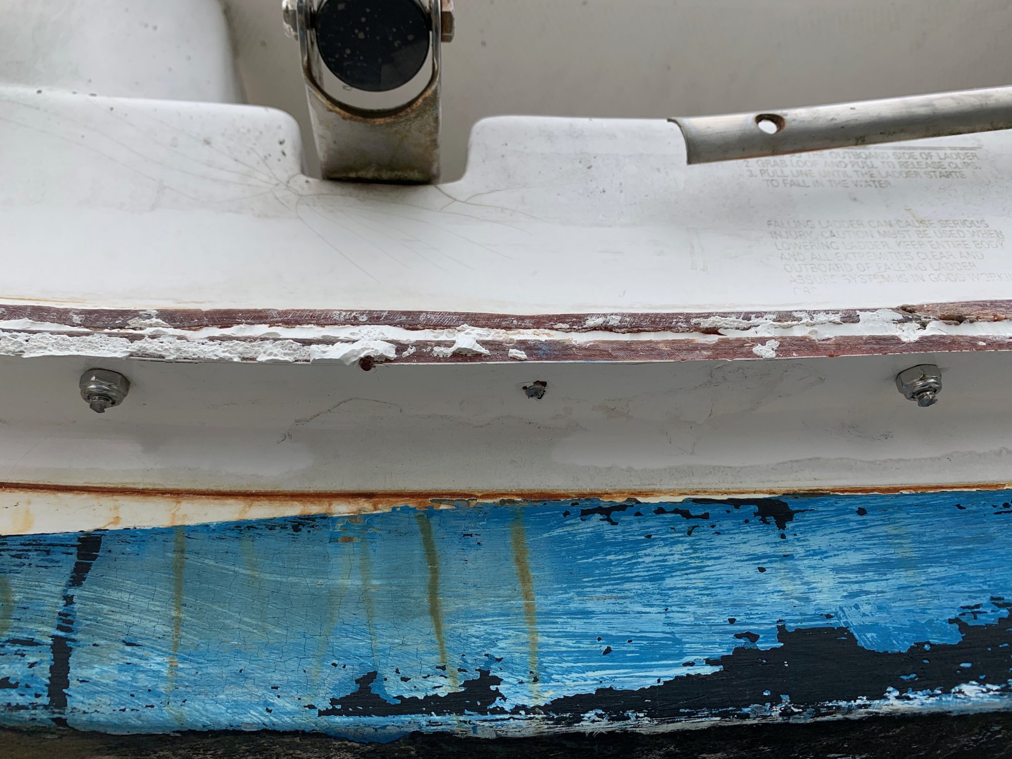

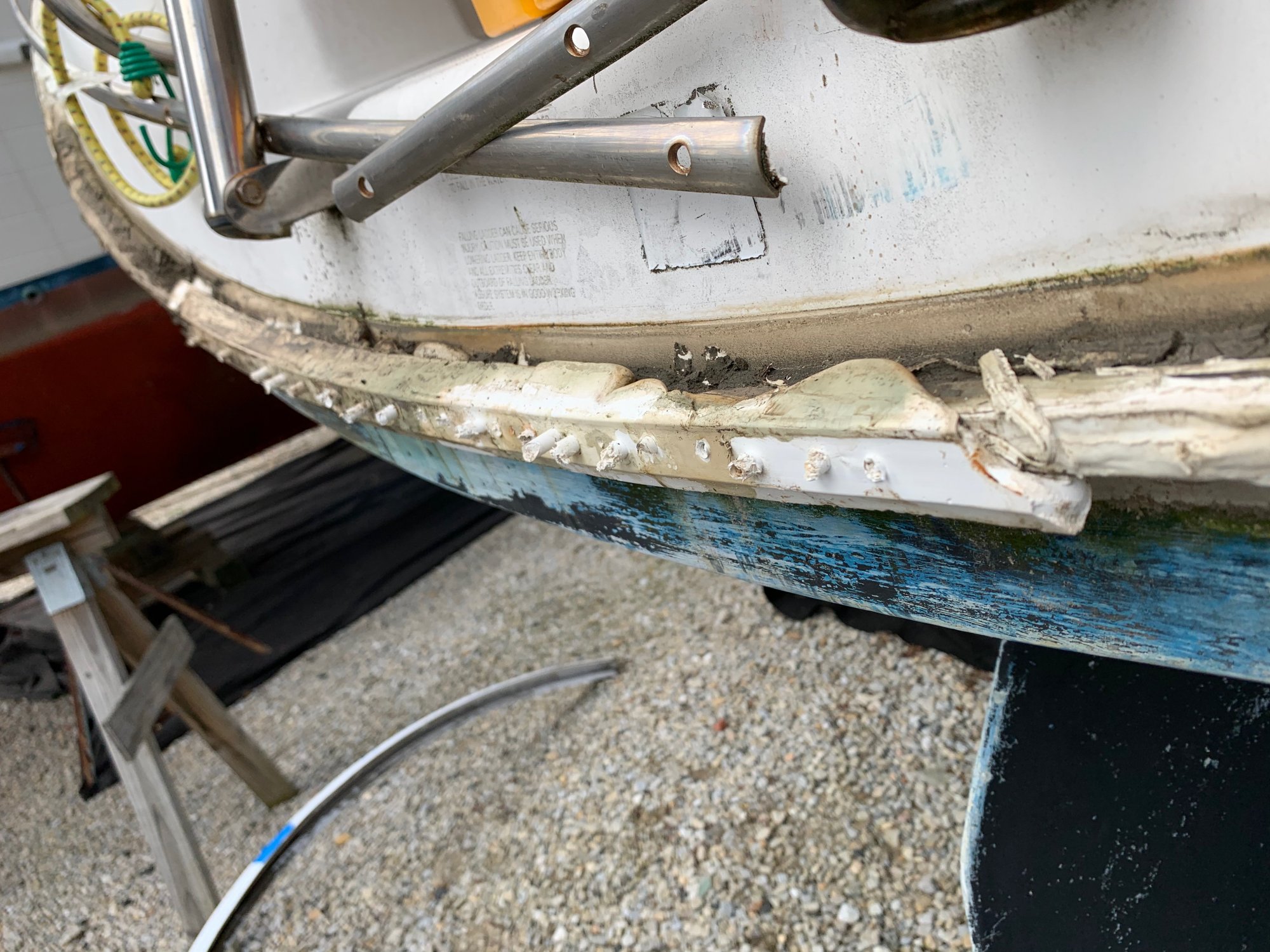

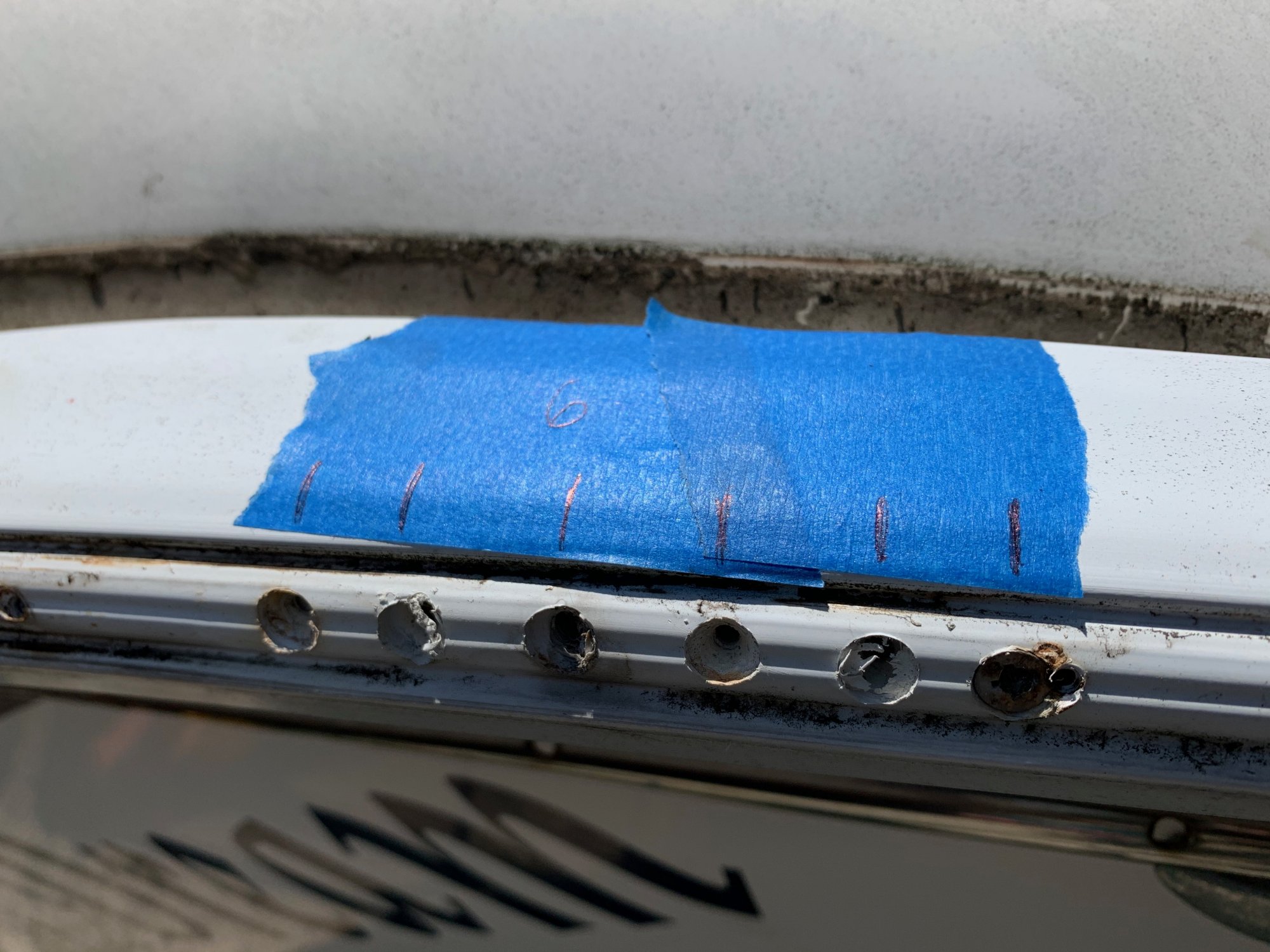

Surprisingly, I actually managed to extract 2 screws, but they were the little ones that secure the stainless rail. So they weren't the reason I couldn't get the rubber rail off. In the last picture above, you can see lots of holes that look like they are filled with caulk. These are only along the aft-most 5 feet of rail. Maybe they were hiding another screw or two? I eventually drilled into them all, removing little plugs of caulk: no screws. After about an hour of prying and swearing, I got to where I couldn't risk any more prying, so I just pulled really hard with both hands on the left and right parts of the rubber rail where it was already freed up. Much swearing later, I seemed to be making some progress. I could see an extra layer of "cushion" underneath, between the rubber rail and the hull/deck joint. More pulling and swearing and it eventually popped off:
It turns out that Hunter had drilled a ton of small holes in the rubber rail just along the 2-3 feet to either side of the swim ladder, and pumped them full of caulk (presumably 5200). So the last bit of pain in getting this off was just fighting this adhesive. Just to be clear: what you're looking at above is a perfect mold of the inside of the rubber rubrail, made of 5200 and still wrapped around the hull/deck joint.

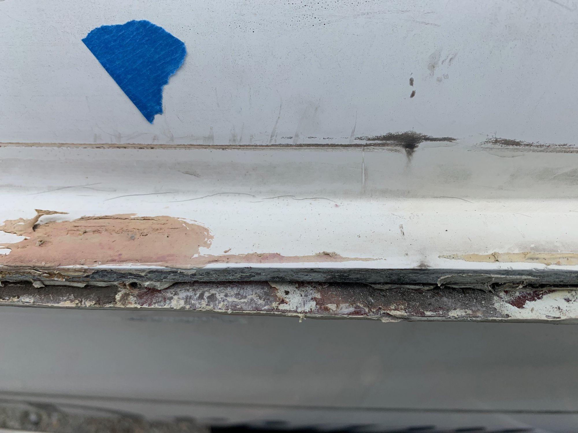

Anyway, in searching this forum, I hadn't found any really clear explanation of what was involved in pulling off and recaulking the rub rail, so I thought I'd share this. It seems like I just need to clean up the hull/deck joint, smear some caulk (I'm thinking 4200?) on the obvious cracks which were letting in rain, put more caulk into the groove on the rubber rail, and reassemble. I'm not sure about doing the same thing they did along the stern (i.e., injecting into all those small holes), but I probably will. I may even do a few new "injection points" in the problem areas which seem like they were leaking. For the most part, these seem to be the result of the workers messing up and missing the middle of the hull/deck joint when they put in the long screws to secure the rail. In fact, although they spaced these screws every 10-11 inches for the most part, there were 2 spots where they went nuts:
At least one of these places cracked the fiberglass and caused a leak.

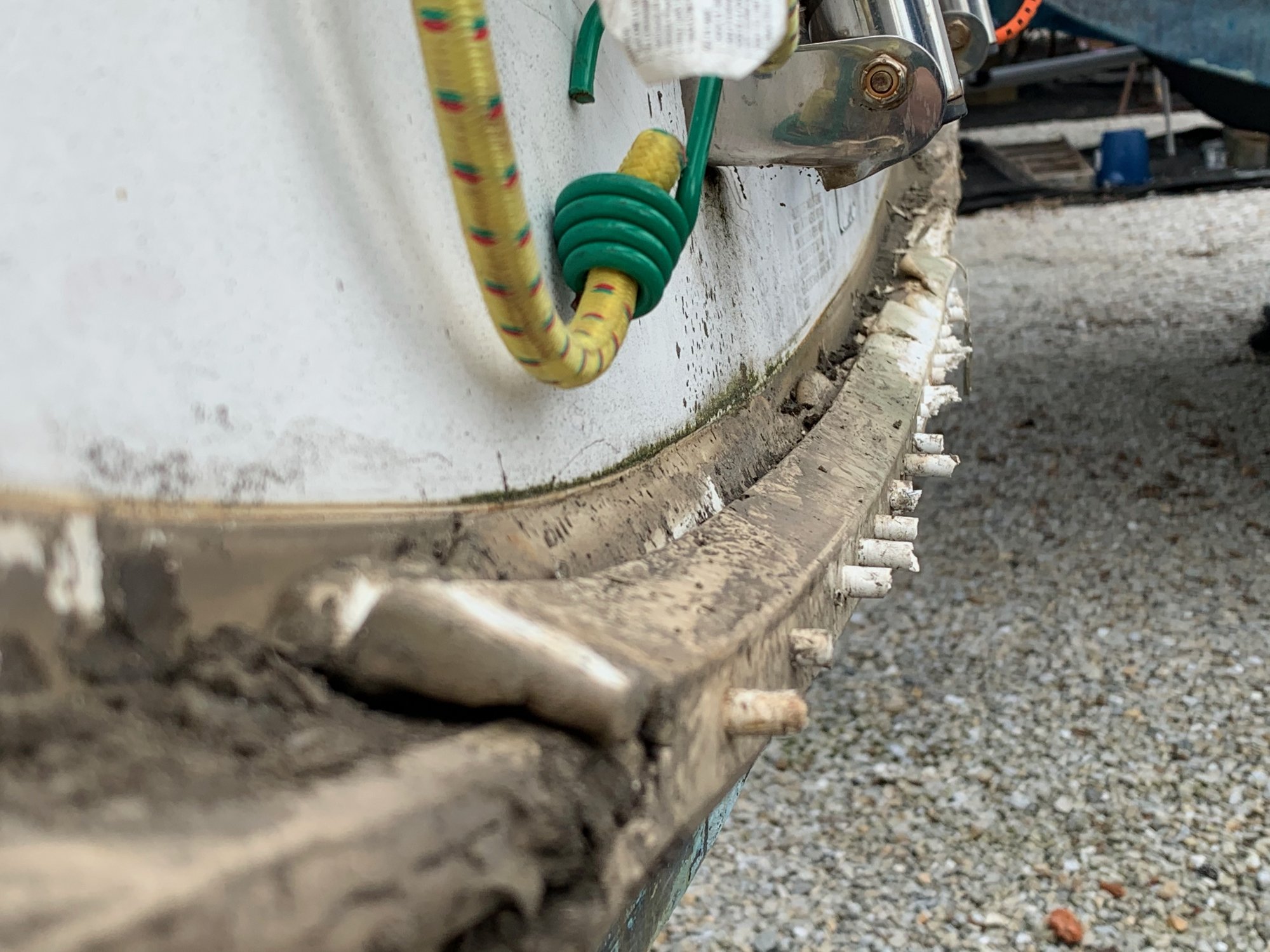

In looking over the forum archives, almost all of the posts about leaks under the rubrail seem to end with either the dealer fixing it, or the poster saying it was fixed. Not much detail either way. Glad yours was dealt with!

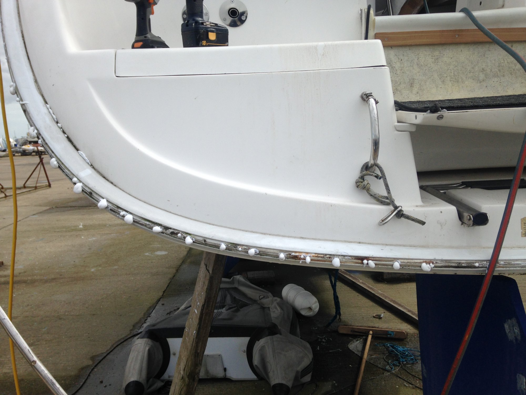

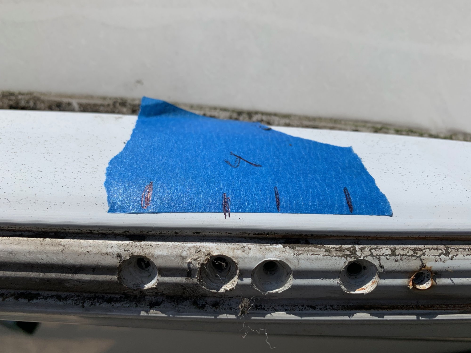

i had a similar problem with my H356. But rather than remove the rub rail completely, I removed the stainless strip, drilled 5mm holes through the rub rail to the depth of the hull join, roughly equi distant between the fixing screws. I then injected gap filling silicon (using a pneumatic gun as a manual one was just too hard on the hands) into the holes until it started to come out of the next hole, working my way all around the boat. That sorted my similar issues out.
Neil
Neil
Neil,
Interesting! So essentially, you replicated what Hunter did along the bottom of our boat, but going further left and right. (Except I'm 90% sure Hunter used 5200.) Thanks for the picture!
I caulked our deck/hull joint yesterday with 4200, after cleaning up the joint with a utility knife wherever there was an obvious crack. Tomorrow, the rubrail will go back on. I'll post more pictures as time allows. I plan to inject a bit into each of the holes for the long screws before installing them, and when I'm all done, probably inject a little into the many holes under the swim ladder as well, where Hunter injected the huge 5200 cushion.

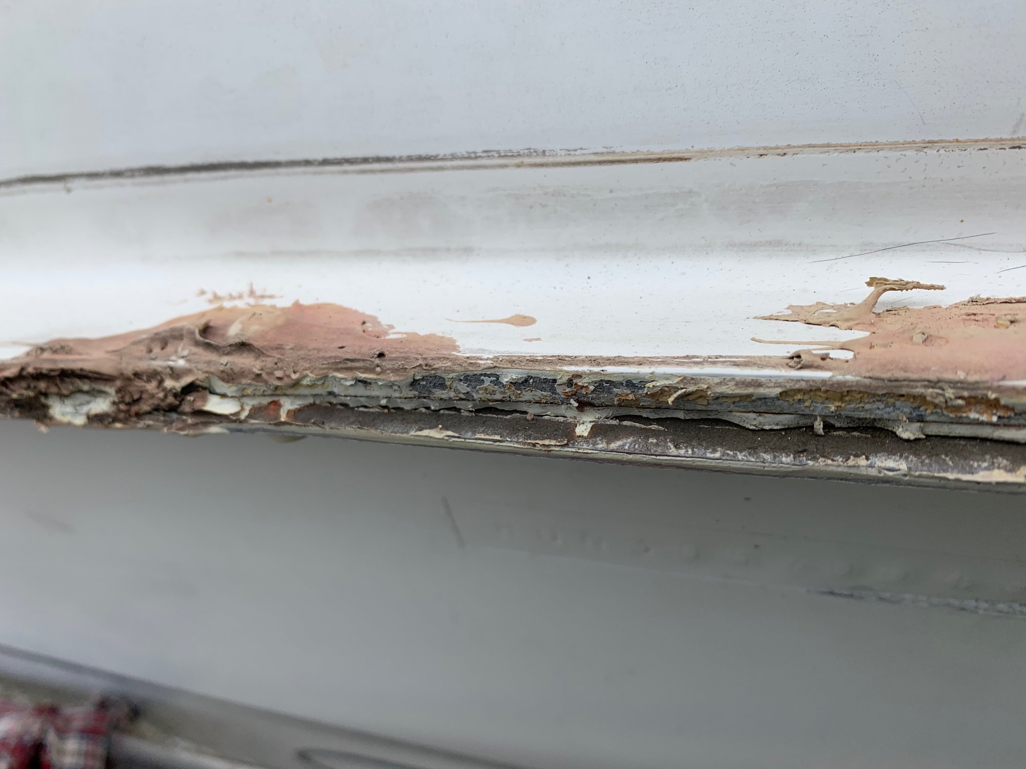

If correct, it would appear the boat was unprofessionally repaired. You should see pink material in the space between transom and the deck plate. There might be a Crack in the pink material.
It was designed the space between the deck and hull was filled with marine putty to the lip , sanded smooth with the back end of the boat with gel coat applied. That lip was above the waterline.
As on the 260, the rub rail was removed using a dremel to get out the old cracked marine putty cleaning to the lip top space of the deck pan and vice versa to the hull. Sanded smooth , I would clean using acetone. Then I would apply a two part epoxy using Water Tite. Depending on the depth, could take several times. That filler is a slow cure but was some of the best I used as it was very strong adhering to the upper and lower lip surfaces. Never had water penetrated thru. Sanded smooth. Instead of applying gel coat, I purchased a spray can from krylon using a white plastic paint. Putting back on the rub rail I would predrill using 5200 as a caulk on the screw threads as well as a bead around the hole. That will hold.
What I saw looked like an attempt to repair a leak before. I hope this helps. Send a private message if you want to.

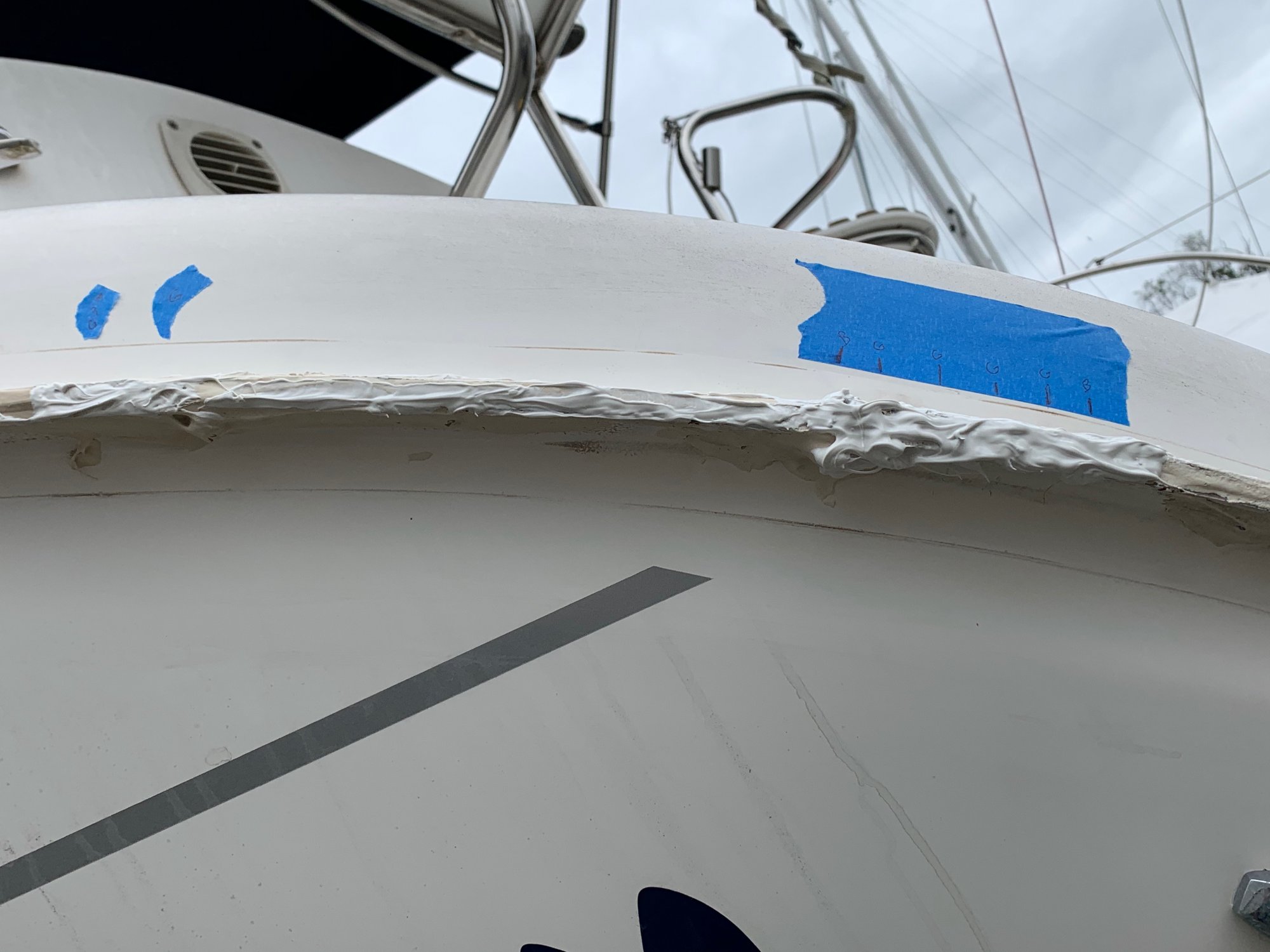

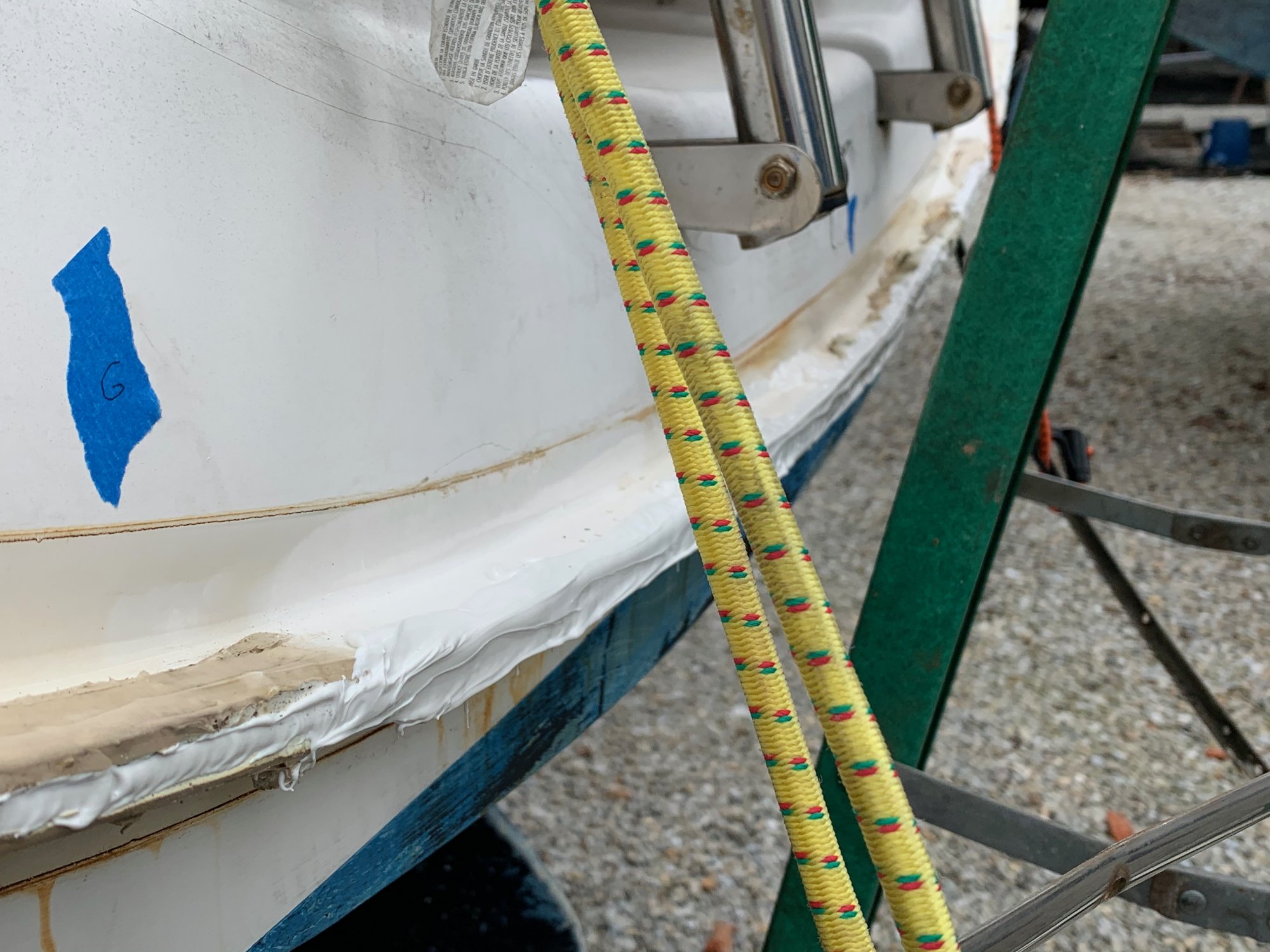

So how was Hunter fastening the hull/deck joint as of 2004? Here are a couple of pictures of the (cleaned up) joint from the stern, directly below the swim ladder. This area had been protected by a huge slug of injected 5200, which I have trimmed away here. The joint in this area looks to be in really good shape: perfectly clean, and with no cracking. I'm mainly posting pictures to show that they alternated thru-bolts (with nuts on the other side) with essentially pointed wood screws. No complaints: it is what it is. Here's the top view, followed by the bottom view of the same 3 bolts/screws:
And here's after I gooped it up with 4200. I left the old adhesive intact if it looked good, but trimmed it away and applied new if not.

Here are a couple of shots of some bad places in the joint. Sorry that I only took them after I had trimmed away the 5200, which originally showed some serious cracks which were letting in rainwater. The first picture is of a maybe 1 foot long stretch on the starboard side where the lower part of the joint (the hull) was not flush with the upper part (the deck). For the remainder of the maybe 20 foot long part I examined, they were lined up perfectly (and sometimes still had cracks in the 5200):
And here's a shot of a place where there was a crack in the 5200, and I cleaned it out with a utility knife to the extent that I could:
Since I've already cleaned it up, you can't see the original crack, but it was pretty obvious where rainwater was getting in, b/c it was pristine 5200 and then dirt inside the cracks. And here's a different area, after gooping up with 4200. I have to admit, it doesn't look like a very good job on my part, but after it had cured, I think I felt pretty good about the integrity of the joint.
After doing this along the entire stern joint (arch to stern to arch), I put the rail back on, injected 4200 into every (long) screw hole, put the screws back in, securing the stainless steel strip as I went so that I made sure it all lined back up correctly.
I'm fairly certain that our boat wasn't repaired, as we bought it new in 2004. Although I suppose it's possible they found a leak before we bought it.
