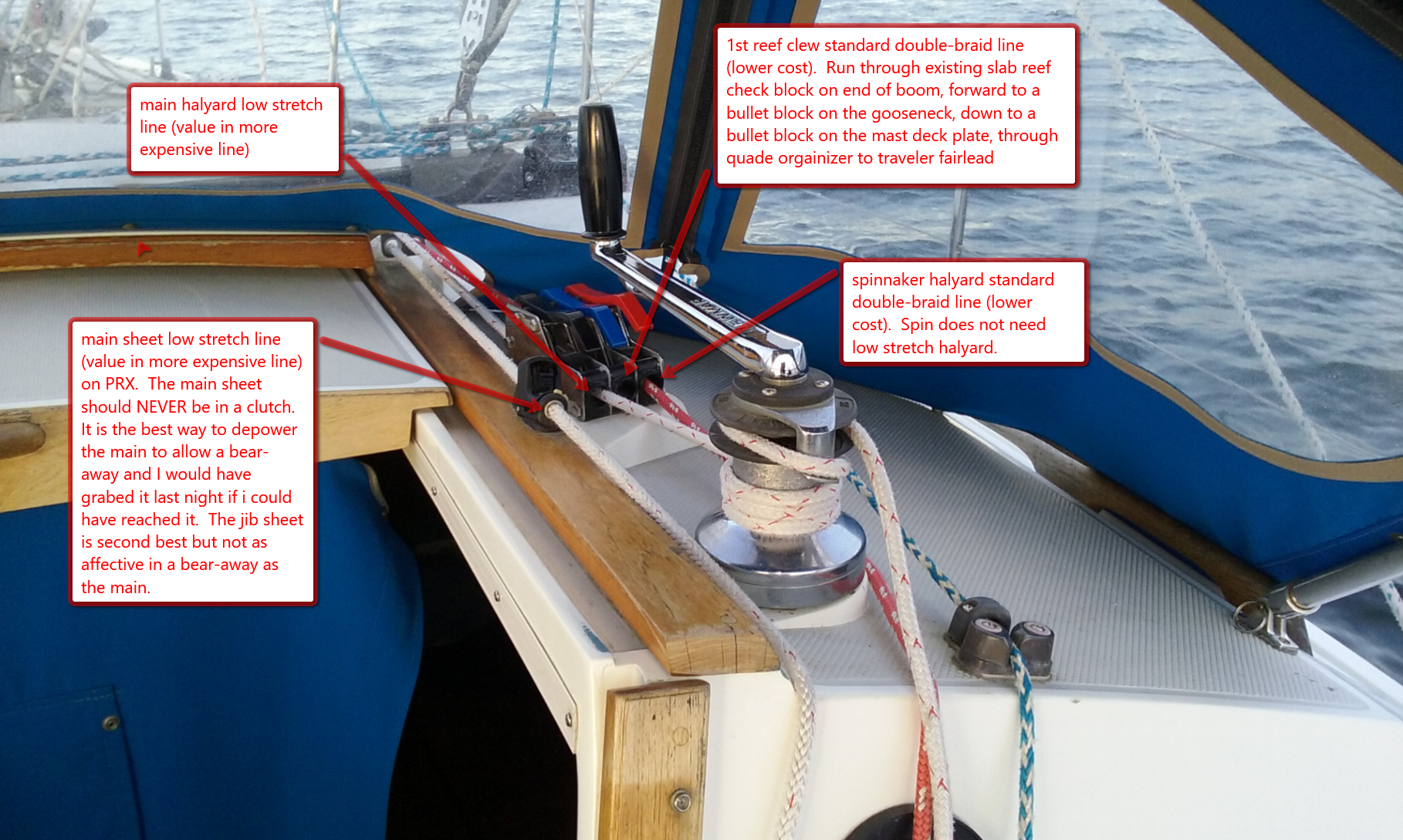

So I am contemplating adding a cleat / clutch to the cabin top on my Catalina 22 to free up the halyard winches for either a spinnaker, banjo sheeting, or whatever. Being that this is a small boat I am interested in hearing ideas on what is better. A cleat like the PXR is smaller which is nice however a traditional Rope clutch is normally what is used for the job. I use the boat for cruising and racing so I don’t want to shorten the handrails etc. I know there will be compromise but I’m trying to find the best balance in technology that will free up the winch while also allowing for the needed adjustments and things. Your thoughts or additional ideas?

I wouldn't use a PXR for this. On cabin top or not, they always seem to be popped open at the most inopportune time. For halyard, I would go for a clutch.

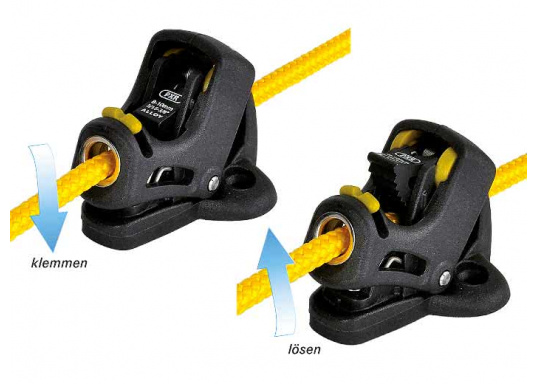

I need to make a bit of a correction to John's memory of race we did about 1½ years ago. I do have three PXR's on my C30 and absolutely love them BUT they are not on any halyard. I think that would be too great of a load for them. I used them for my whisker/spin pole mast mounted car control lines (up and down) and for my main sheet which is in a 4:1 arrangement. I also plan to get a couple of them to replace the cam cleats for my 4:1 traveler control line. They are fantastic for running lines that need to be adjusted often with a pull and forget simplicity. The release with a flick of the wrist and with much less force required than the cam cleat but do not have the tendency to not lock in which I have had with cams. I think they are a far superior cleat to a cam cleat and can be used any place a cam is used. I do not think that they are the best choice for a highly loaded static line like a halyard.
For a C22 like that of LakeShark is asking about, the large PXR would more than likely have plenty of strength. I still would probably not use one for the halyards though. the halyard is a "set it and forget it" type of line. Once it is set, you do not need to mess with it until ready to drop the sail. The PXR is too easy to release and you want the halyards to be secure. For a C22 I would suggest the Spinlock mini jammer which are about the same cost and stronger and more secure than the PXR

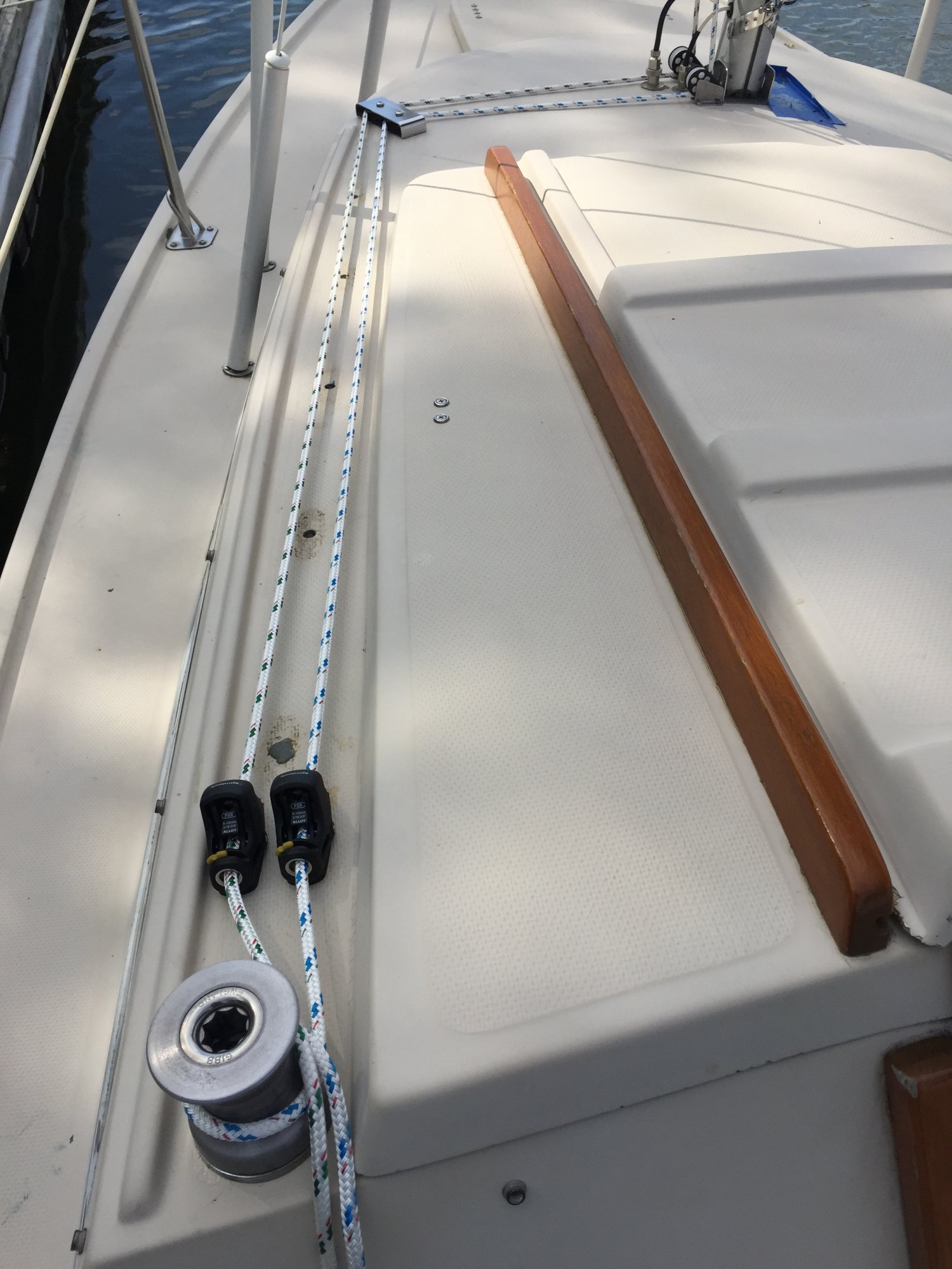

I used the PXR on mine when I did my lines aft project. I have two on each side just ahead of a winch. I was able to keep the teak handrails but did have to remove one loop (haven't missed it). I've had them installed for two seasons now and couldn't be happier. I have not had a single issue with them popping open unexpectedly, jamming or failing to release under load as a few people told me would happen. Never had any slippage either. A clutch may have superior holding power, but the smaller footprint and dramatic price difference were bigger factors in my decision. After two seasons of use and for the type of sailing I do, I honestly can't see where a clutch would have offered me any advantage over the PXR. Just my $.02 based on my experience, your mileage may vary.

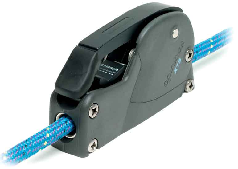

Here is a clutch for 1/4" through 7/16" that will open under load for under $70. As far as feeding the line through them, if you use the max sige it will take it can be a bit difficult. If your line is less than the max it is not a problem.

@Jacomo Sailor that's great information. One thing I have been pondering though is do you have trouble with line overwraps on the winch or releasing the line to lower the sail just a bit for adjustments? I want to be able to lower an inch or so as I trim sails for a race if needed without cutting the whole thing loose if you know what I mean.
No, I have not had any issue. The way mine is set up, I can either take the line off the winch and pull upward to unlock the spinlock (handy if I'm back at the tiller as you can snap the line up sharply from a few feet away), or I can keep the line on the winch, open the spinklock by pressing on it and then let the line slip on the winch as needed.
Here's a pic of my set up during installation.

@Jacomo Sailor that looks great and the picture is just what I needed. I had not thought about being able to snap it up from the tiller. That might be really handy for lowering the genoa when I’m single handed. Not yet sure what I’ll do but I do have the winter yet to consider it.
