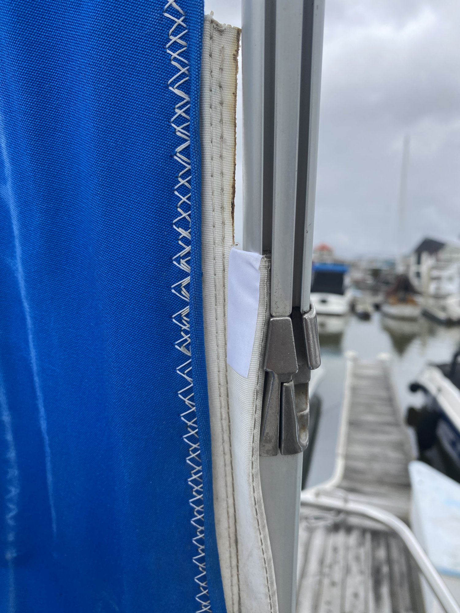

Hi All,
Noob questions so bear with me.
I replaced my Jib sail to do maintenance on the one that was on the sailboat.
I have a furling jib,Harken.
The forestay has a luff foil on it.
The Luff foil has two tracks so I can feed the sail in either.
The first question, is which track do I use?
The second question is assuming there are two tracks in place so I can take one sail down and raise another at the same time.
How do I do this ?

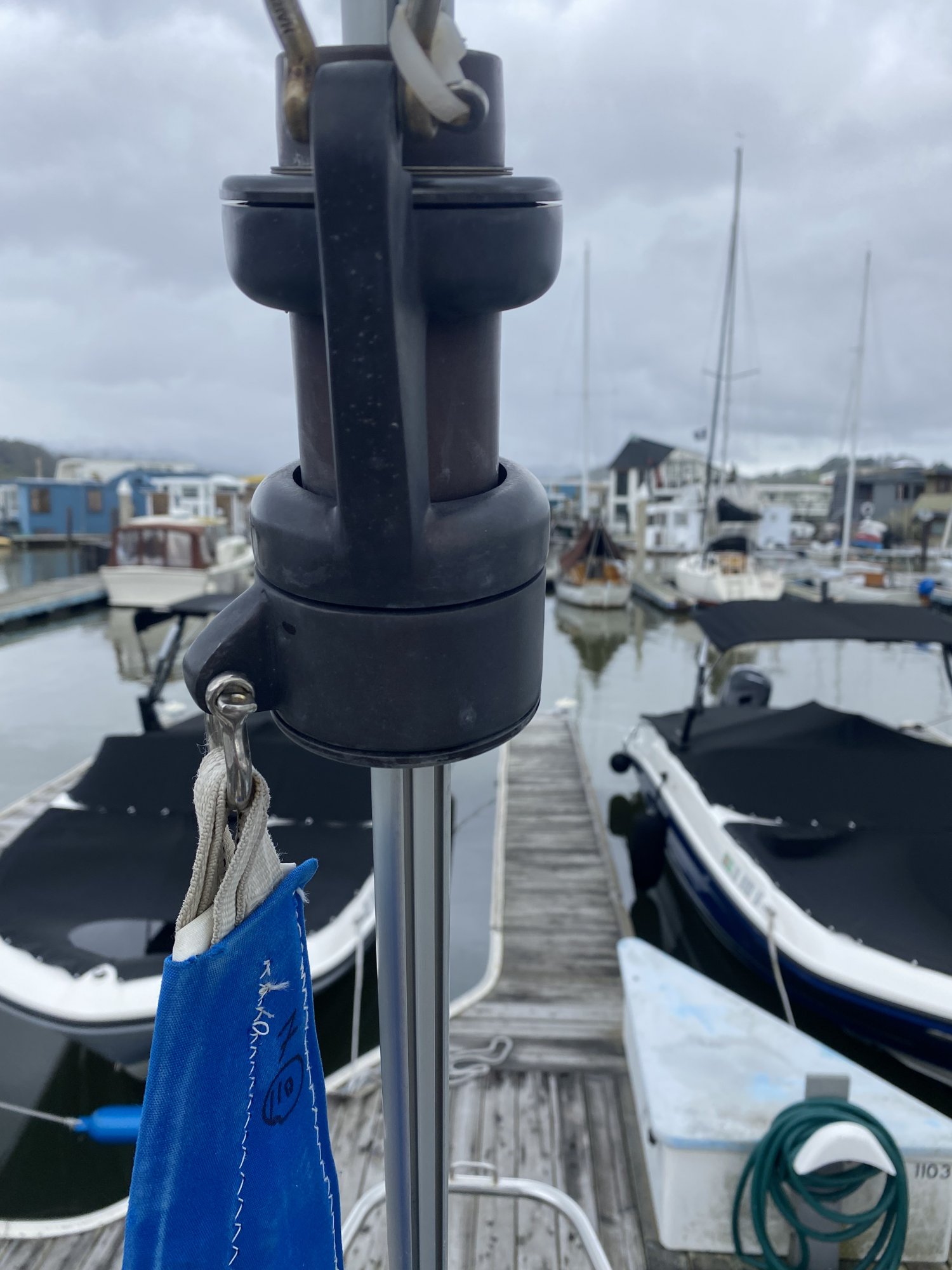

If I lower the current sail, the swivel at the top will come down and prevent the other sail from going up.
Is it just so I can "prep" the other jib a bit, then lower one jib, switch the shackle from old jib to new jib, then quickly raise ?doesn't seem like it would save that much time.......
The third and final question.
Should I replace the shackle at the top swivel with a Twist Shackle ?
Thank you

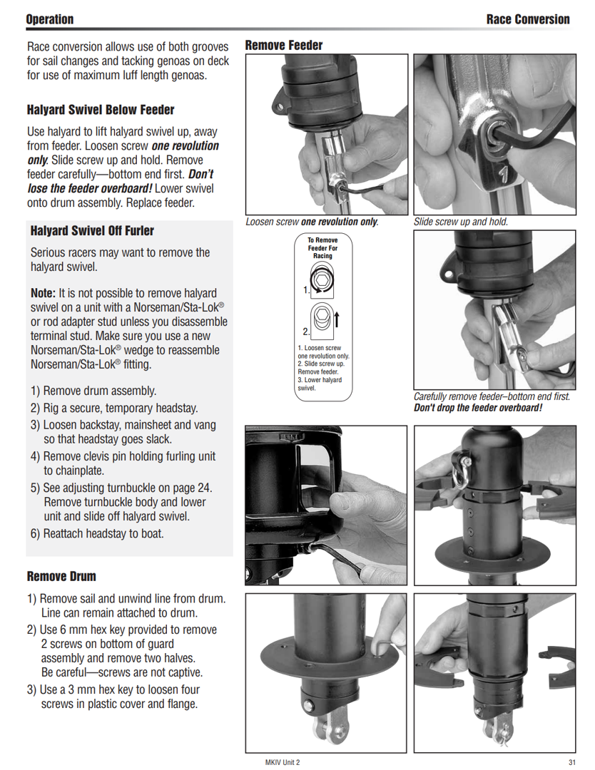

As dlochner says, typically the sail feeder is removed to allow the swivel to rest on top of the furling drum. Then Port track is used with port halyard and stbd with stbd.
EDIT: oh, the feeder is held on by one screw.. don't drop it ! ya might want to get a spare screw.. The feeder will be loose as well.. don't drop that either!

Well, to sum it up.
If you are in racing mode.
You turn the screw on the feeder like Claude said.
You remove the feeder and keep it safe.
You can then lower the Halyard Swivel all the way to the bottom.
You then put the feeder back on.
This allows you to hoist Jib2 while Jib1 is flying.
If your Jib 1 is on starboard foil and you are on port tack, you simply hoist Jib2 on port foil. Then lower Jib 1 and bag it.
If your jib 1 is on port foil and your are on port tack, you can tack, raise Jib2, tack back and lower jib 1 and bag it.
If you are in cruising mode heading downwind for a long time and don't want to raise a spinnaker.
You can raise two jibs.
One jib will fly , Jib1
The other jib Jib2 you will add a whisker pole to keep it to the other side of the Jib1.
