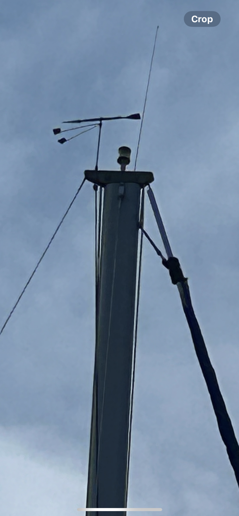

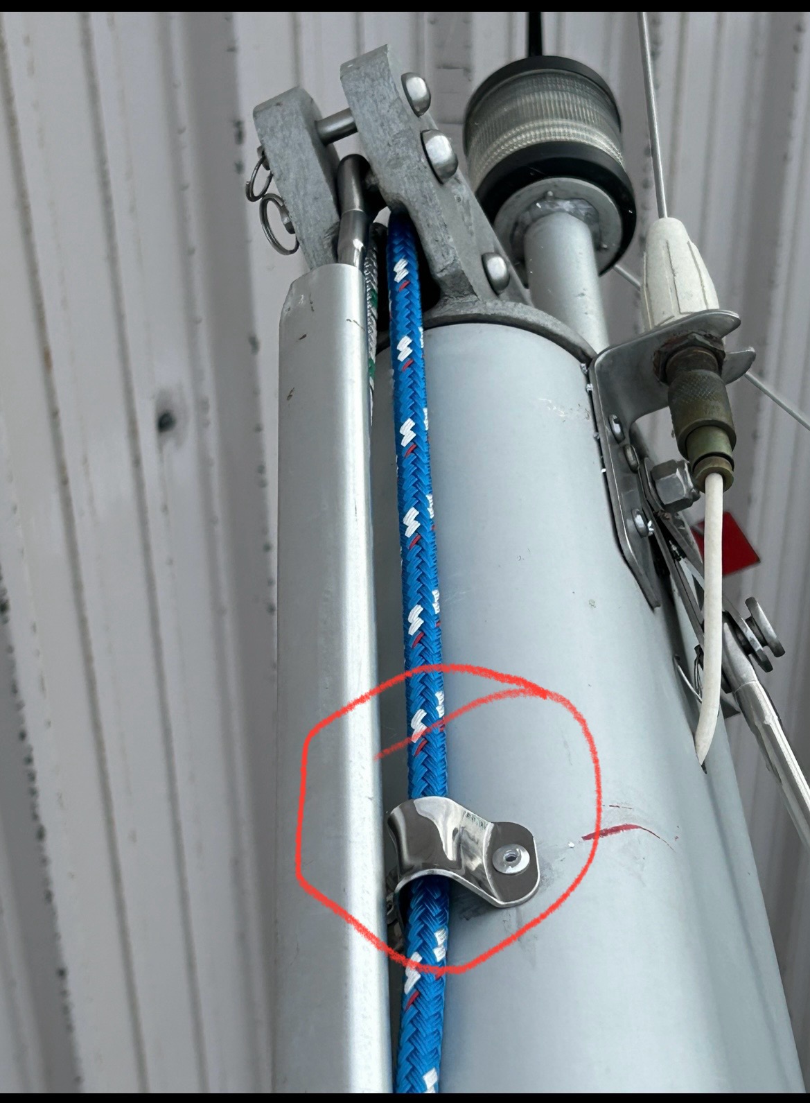

The issue was halyard wrap. Eventually the halyard snapped and needed to be replaced. Planning to install a guide to change the halyard angle to prevent wrap. If you have the issue I posted initially you can visibly see the halyard wrap if that’s the issue. The key thing to know is that it’s intermittent, it wraps then unwraps so in a static position it may not be wrapped. Also it only happened when I was following up the jib. Never happens when unrolling.
