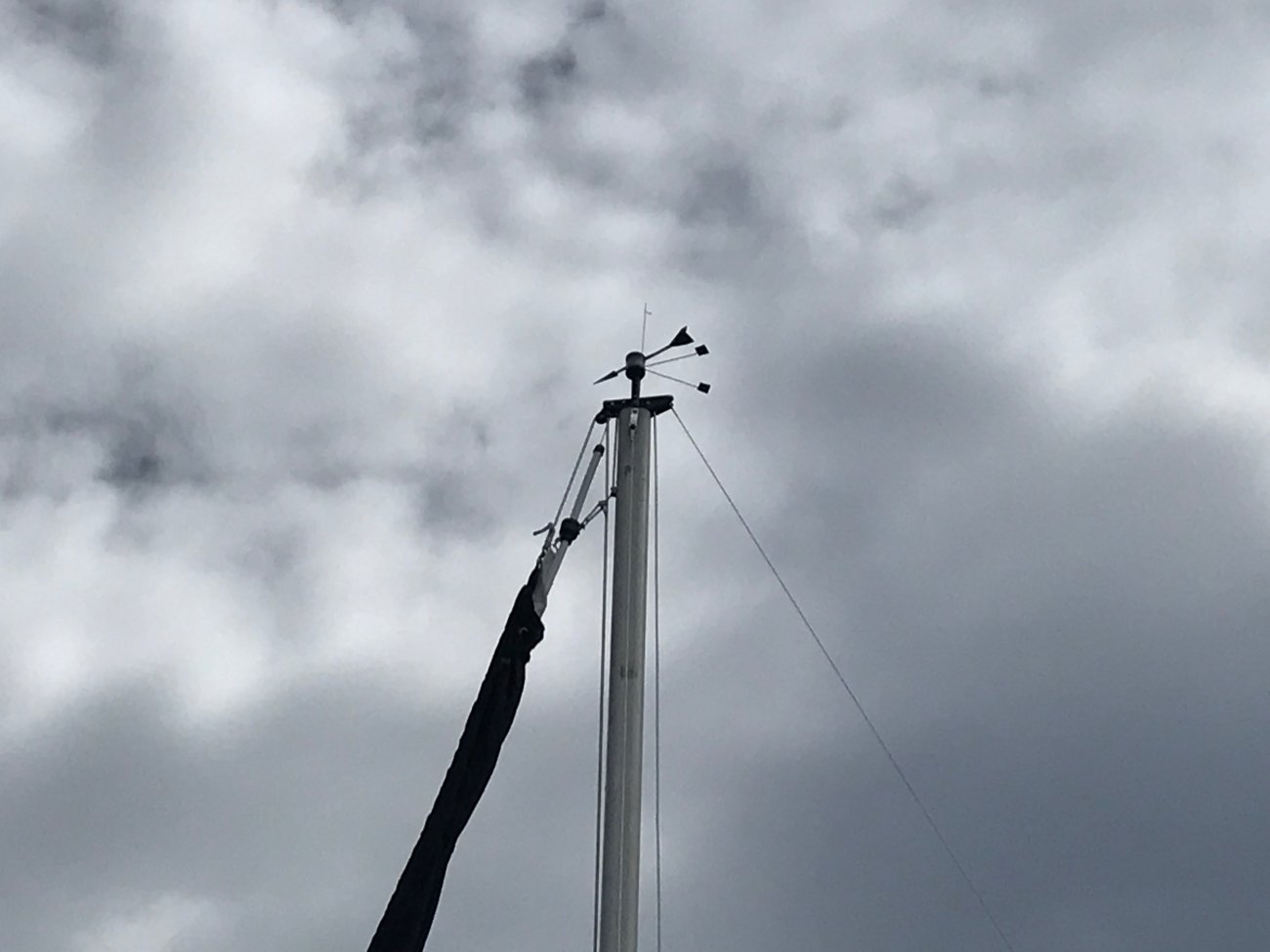

I have a Schaeffer snapfurl. It was doing the exact same thing. It turns out that the halyard was wrapping around the forestay at the top of the mast. I could usually get 2 or 3 turns before it stopped. I just looked at a photo of the Harken, and it looks like a similar setup. The fix was to lower a small clip that held the halyard next to the mast so that it would connect to the furler at an angle that did not allow it to wrap around the forestay. It now works flawlessly. Could yours be a similar problem? If so, it is an easy fix. Schaeffer has diagrams on their website addressing the problem. Maybe Harken does too. I attached a photo that shows the halyard and the clip. I hope that it all works out.

I don't have a furler, but my neighbor c22 does (Schaeffer IIRC), known/common issue referred to as "halyard wrap"....he experienced same condition recently...

harken has an instruction manual on the web. the attachment from your mast to the top swivel is critical to prevent halyard wrap. ease of furl with a non-wrapping halyard is affected by the # and direction of wraps on the drum. follow the manual like it's a new install.
