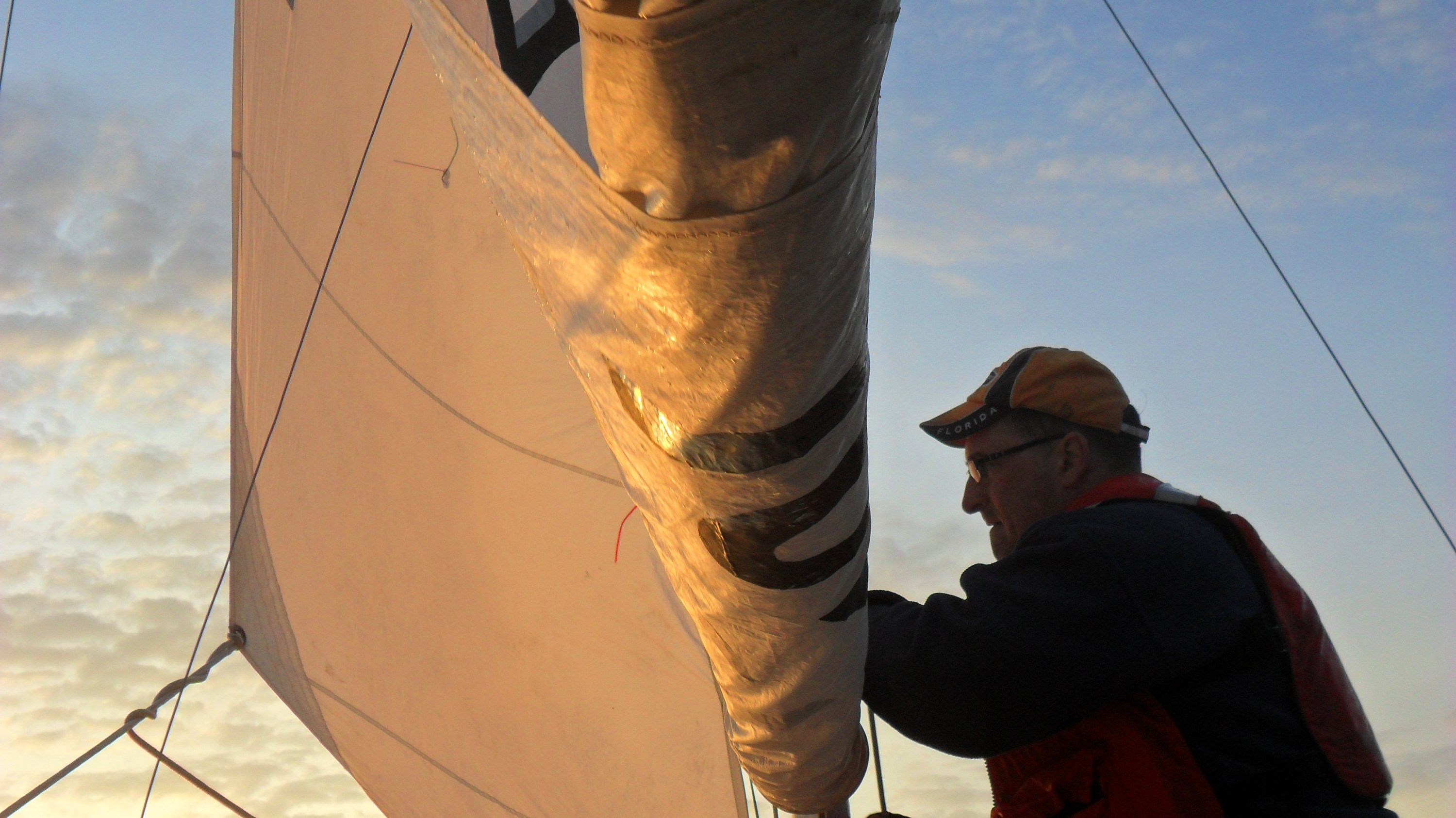

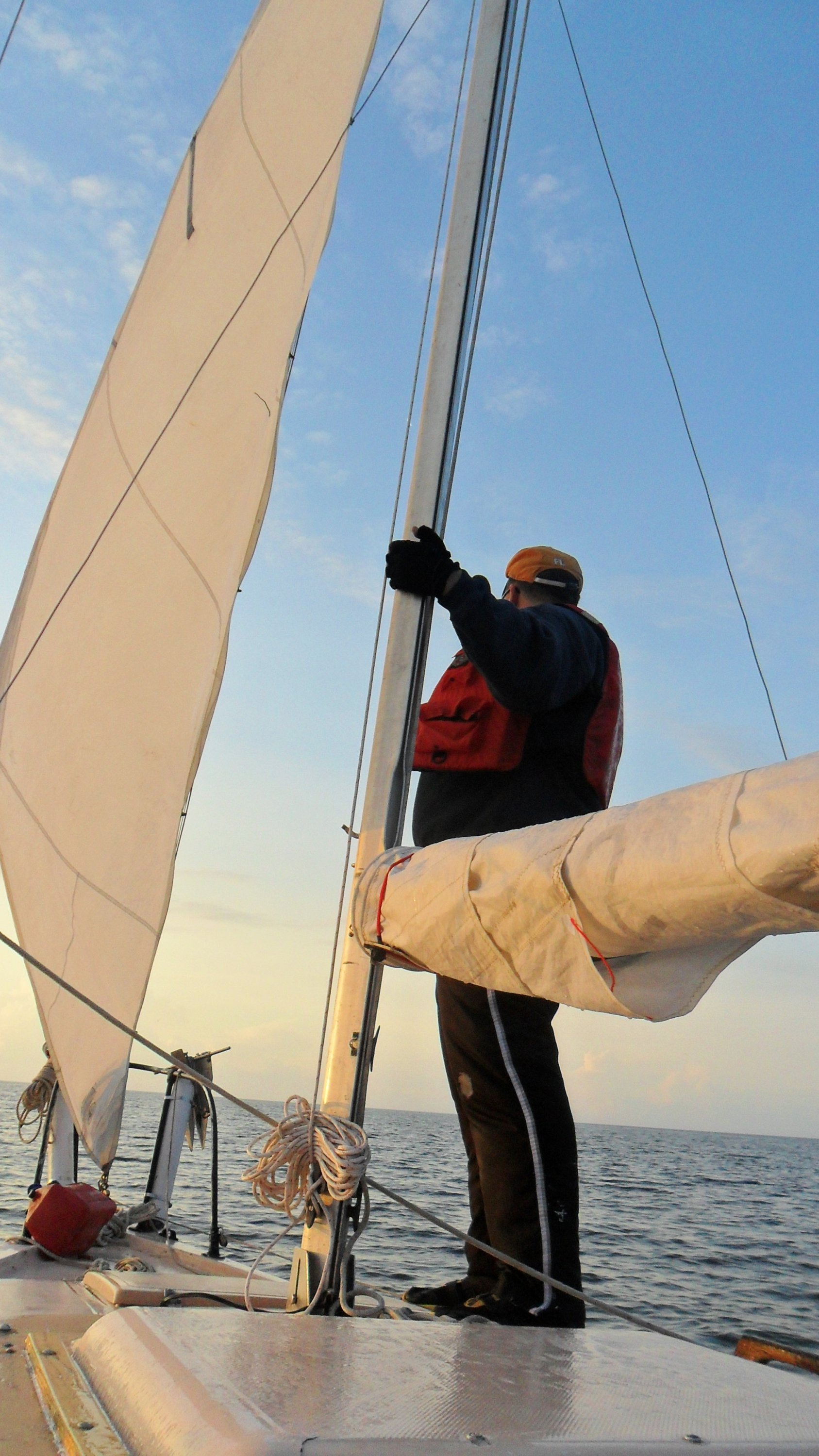

And two boats ago, I had a boom furler on my Mac 22. It was not a gear thing, you had to do it by hand. There was a pin on the goose neck that you could take out and the boom would roll around a shaft. It was very good when your goal was to let out a reef, but it was nearly impossible to set a reef with the sail flogging. So I also had slab reefing on that boat for when I needed to set a reef. It is probably better to think of it as roller furling but not roller reefing. What I often did was leave the harbor with a reef set using the roller boom... and then I could quickly let it out once I got a sense of the conditions. Very smooth and easy to do single handed...But as the day went on, if I needed to reef, I used slab reefing.
Here is a pic of that set up. It has some nice advantages, especially when you were putting the boat up. I liked the clean way the sail could be rolled up and stowed on the boom.

Thank you so much ! those photos are excellent! Yep, I also have alcohol cooker & heater , oil lamps, foot pump, and all my jibs/yankee spitfire etc. are hank on for really nice sail shape , and the 2 larger ones the genoa & lapper, have reefing kringles in them; plus manually hoist n stow my 44# bruce on 300 ft of rode. Sailing is a real sport! I like to do all the "exercise" helps an ol codger like me stay alive n hearty .

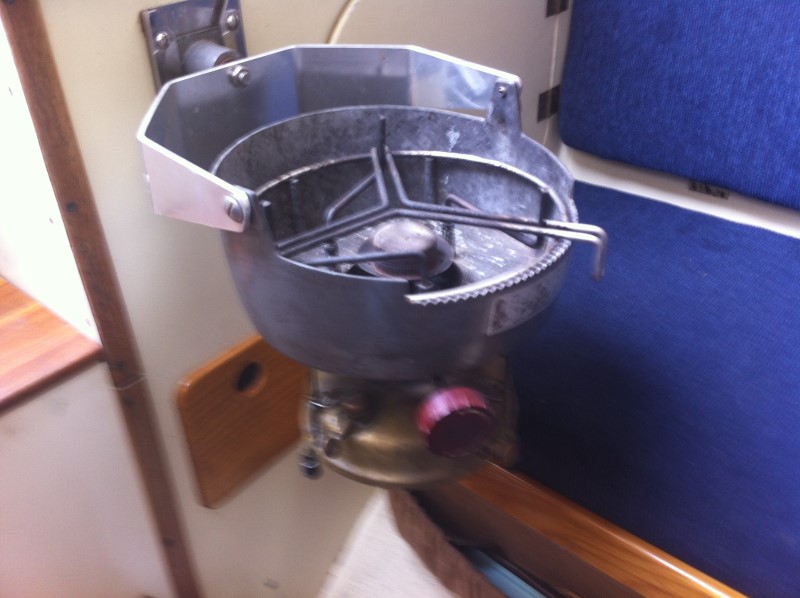

Galley foot pump- yep
Pressure Kerosene stove?Yep
Hank on jibs-yep
Wooden mast and boom? yep -mast is original from 1961, I built the boom
The stove is a true antique or so the folks in England tell me, mounted in a modified SeaCook stove

I have an old sea swing stove that's made out of solid brass! That thing weighs a TON.
