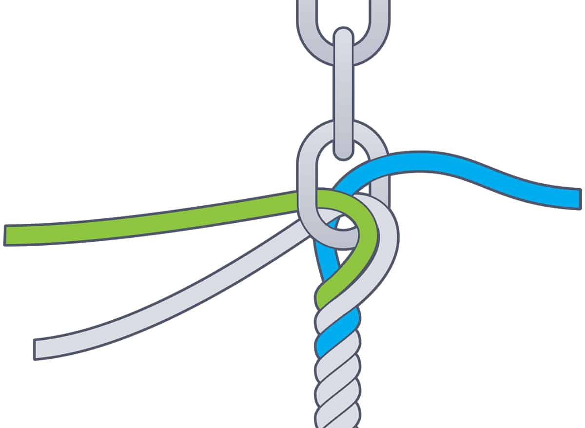

If you have space, I'd use a thimble and splice over a thimble to the chain. The rope to chain splice I use on the bottom of my all chain side so the chain can't leave the boat and I have a rope tail at the end of my chain in case I want it to leave the boat in a hurry, I can just cut the line. But for a working joint like you'll have, I'd splice over a thimble and use a shackle to join them. That's how I did my secondary anchor which is a rode/chain system like you are building for your primary anchor.
I found paint lasts very little time. I went from paint to zip ties. There have been threads about other sytems of marking the chain. You may wish to read through those.
There is also a rule of thumb that most windlasses drop chain at about 3 feet per second. I don't know what happens there when you get to your rode...
dj
How does your windlass handle the thimble and shackle joint between chain and rope? I understand the joint is more sound than splicing directly to chain, but I also understand a 3 strand splice to chain only costs 10% of tensile strength, and we prefer to keep all our processes as simple and idiot proof as possible. How would I get a thimble and shackle past the gypsy and into the anchor locker?

For splicing 3 strand to 5/16” G4, Practical Sailor recommends the “chain long splice” and provides a description of the process. A video would be much more instructive, but I cannot find any on doing a chain long splice. Any wisdom or thoughts in regards to achieving a strong splice to 5/16” chain? I believe my line is 9/16, though it may be 5/8”.
24,926
Simple answer, you can’t!
Not without manually grabbing the line before the thimble get to the gypsy. Pulling the anchor rode in manually to the chain then inserting the chain in the gypsy.
This places the crew member manning the anchor system in a dangerous situation.
You are much safer to use the largest 3 strand nylon rode you can that will work in your windlass and use a chain to rope splice.

For several years I’ve used what we’re calling here a “chain long splice” for my stern anchor, but it will also pass through the gypsy as the bower. It’s 9/16” 3-strand rope long sliced to 5/16” chain. I replace it after a couple of seasons b/c it’s exposed to chaffing more so than the 3-strand splice at the last link (post #32). It’s probably stronger than the type of #32 b/c the strands are not bent 180 deg around a link, etc. It’s easy to make following an illustration.

That's correct, you can't pass the thimble through the gypsy.
In my case I have two sides of a horizontal windlass, the rope side and the chain side. When I am bringing in my secondary anchor - the one that is the rode/chain combo, I am handling the rope as i pull in the line. When my line gets to the thimble, it would be exactly the same if I had a rope to chain splice, I have to manually pick the line over to the chain gypsy. So I only have about a foot to pull to get past the thimble and engage the chain into the chain side.
It is not at all dangerous.
I always have either myself or a crew member at the bow pulling anchor and dropping anchor. So there is no notable difference which method I use. But a rope to chain splice will not last as long and likely more prone to chafe than using s thimble.
If you are desiring to both drop and pull your anchor without being at the bow, and wish for a more automatic process - then you want the splice. Just inspect it often and thoroughly.

You must take care of the long chain splice. The major strands are unlaid so they can be individually woven through the chain links as in a normal rope splice. So, the strands within the strands also open up (unwind partially) allowing significant prolonged exposure to seawater and bottom sediments, etc. Bottom sediments are potentially abrasive to the smaller nylon strands. The splice should be throughly rinsed after use (when returned to dock). I soak mine in fresh water with Woolite as my rigger/splicer has recommended. Resplice every couple of seasons.
Been there, done that. Much prefer a splice with a thimble. Long splice seems to cause the chain at the splice to corrode much faster than otherwise, even when doing a fresh water rinse after each cruise.

I think I’m going with the simple 3 strand splice mentioned by JSSailem above. It seems the easiest to replicate for regular maintenance, should anything show signs of wear. That said, does anybody have suggestions as to what I should do with the old 100’ of chain, aside from secondary rode? Much of it is beyond serviceable life.
Seems simple enough, however, be sure you can get all three strands of your rope through the last link before you go too far. Ours would only accept two with a struggle, which is why I went with a long splice, but then went back to a thimble splice because the long splice was very difficult as well.
