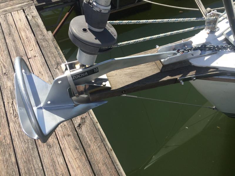

I finally got a chance to fit the Rocna 10 to my C30 tall rig. Haven't used it yet but will see how it works in our river. Not much real estate at the bow so made a chain stopper out of aluminum channel.

Looks good to me. I'm not sure what you were using before but I am sure you'll love that anchor

...wondering if anyone has accomplished the same thing on a no bow-sprit C30...even less real estate.

Bob, I was using a danforth style cheap anchor that was all bent out of shape. It was on the boat when I purchased.
Ron
Agree with all you said. Luckily I anchor in very protected waters on the river.
I'm using a Mason Supreme on a standard rig with no problem. I will say that I stow the anchor in the anchor locker when not using it. A bit of a pain but after seeing Maine Sail's write up on chafing and I'm on a mooring, i feel safer!

Capt. Ron gives good advice. I have always questioned just how strong the average 30 year old wooden bow sprit still is after the years of marine salt corrosion. There is an awful lot of stress on that sprit when the forestay & furling gear are attached to it already. I for one am glad that I don't have this sprit, as it looks like an accident waiting to happen. Incidentally, I also had a forestay fail on me on a Catalina 25, & was also lucky enough to turn down wind to avoid a dismasting. The cotter pins used by Catalina on all of their turnbuckles are cheap & should always be replaced. My cotter pin sheared off & the $.50 cent part nearly cost me big time. I always prefer having the anchor in the locker for safety, but the Rocna sure looks like a great battering ram & would surely take a hit for you!
Ha! It works for giving bruises when you pass by on the dock also.
Actually when you look at the angles of the bob stay and forestay, the sprit is in compression towards the bow of the boat. Obviously when something parts (like the swage, or turnbuckel) then all bets are off and no different than a normal rig setup.
Adding anchor stresses is a different story unless your using a bridle which I don't have.
