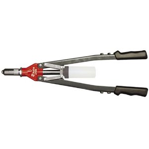

I take a scraper tool and shear off the rivet head with a good sharp blow. Separates the rivet and then I can punch out the rivet body. It (the rivet body) will drop into the mast so that might be a problem if it gets lodged on a sheave or such. My mast was on the hard and the little pieces could be retrieved. I did drill out the rivets before but it was messy and the drill bit walked once or twice scoring the hole. I dont know if shearing off the heads would work with Stainless steel (guessing it might not).
I used the
Astro Pneumatic 1426 1/4-Inch Heavy-Duty Hand Riveter
with 1/4" Aluminum rivets for my mast base. It really secures strongly IMHO. It was $28 on Amazon.
I used 3/8" aluminum rivets for a new steaming light mid mast. What I liked best is that the rivet "mushrooms" but doesn't leave a sharp edge internally (at least from what I could see) so there is no risk of the halyards shredding on the rivets.
I also riveted other things (micro block on the spreader for a pendant line) and it is now my go to tool for attaching to the aluminum parts of the mast.
This is the "BIG" riveter but there are smaller ones that one could use up a Bosun's chair or in tight places
Good luck
