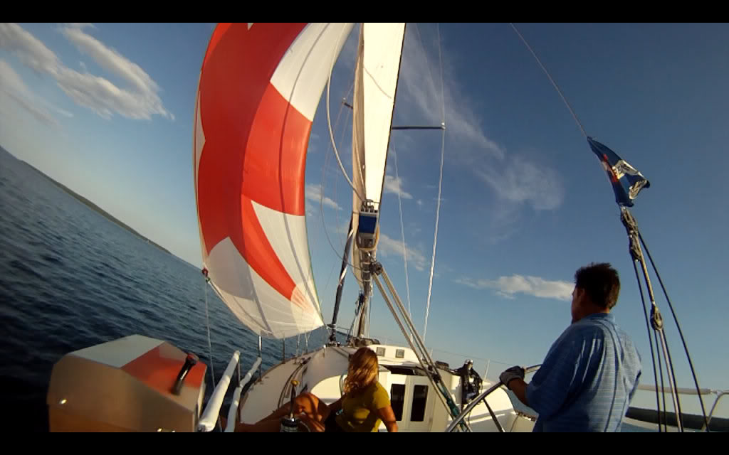

Nov 8, 2010
11,386
Wow, there's a stretch goal for our boat! That is within 10 deg of our genoa. I struggle to hold a course 75 degrees with the asym. Clearly I need to up my game!
Remember thats 52 degrees APPARENT. True is never much above the beam. Here we are doing 6 in 6. Beam reaching with the main so tight it looks like we're beating.
Gunni
Mar 16, 2010
5,937
Great shot, you have that spin tack tight as a banjo string!
Oct 27, 2010
119
E-22 e-22 Stratford
Yep, nice light day, smooth water, mainsheet in tight, spinnaker tack brought down to the bow. (and you can see how this really flattens out the kite...across the mid-section it's not much deeper than a full light number one)
Awesome and thanks for the illustrative picture!!
bp
Nov 8, 2010
11,386
bp
This is SO the key word when it comes to close AW reaching with kites. So many people think that the luff has to be straight when trying to maximize close AW reaching, but that's a false goal. The trick is to get the sail FLAT. Some curve in the luff is good (and needed) to flatten the sail. One of the biggest mistakes I see with people with syms and Code 0s is trying to sail them with as straight a luff as possible.
So you flatten the sail, and drive the luff. A small amount of curl is OK (even good). That's why racing asyms have the chevrons on the luff, so you can see that curl. But if you loose it, you have to drive down to 'pop the luff' back into position!
