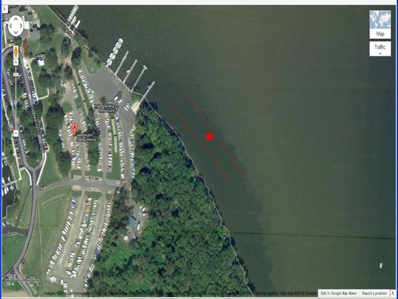

Washington Sailing Marina Approach
Here is a shot of the entrance past the launches. The channel is 5-7 feet deep and about 60 feet wide. The shoal that this shows on the north and east has encroached significantly since this shot and the entire channel is no longer useable (the northern half is 3-4 feet deep until abeam the piers). The rest of the water is 2-3 feet deep to the north and east outside of the channel. I have some pretty detailed depth soundings of the harbor since it continues to silt up
Though I was overtaking him by nature of the channel, once he turned 90 degrees to cross my bow, I feel this was a crossing situation as he was tacking north and south across the channel and not heading to the ramps at the time we approached. Again, I had no problem slowing to avoid him, and readily did so since my approach is that on a Sunday cruise, I am always the give way vessel (unless I am racing). But I am stickler for knowing the rules and how they apply and greatly appreciate the input.
