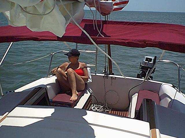

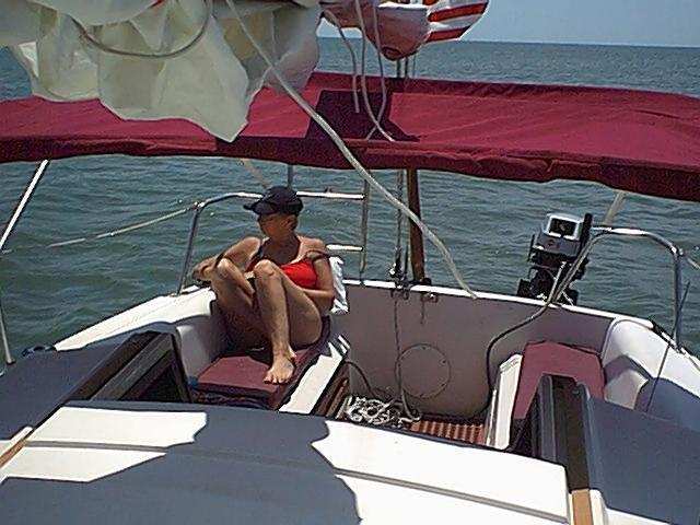

Go end boom. Set the main sheet from the boom's end to the transom and that will determine how far back you can install the bimini. The picture is from a Starwind 223 but the installation should be similar. The tiller got turned up at anchor and actually held by the mainsheet line. Sorry it is from the front angle but only picture I could find. Because of the tiller the "U" bolt to the transom is offset about 1" to Starboard but it makes no noticeable difference.
