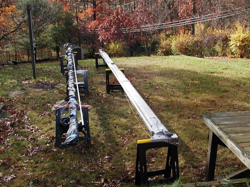

FWIW, my insurance company refused to insure the rigging on the delivery run from FL to MD, even though I had a professional rigging inspector do an inspection at the insurrance company's request. When I got to the winter refit 2008-2009, I had the mast unstepped for a more thorough inspection. I ended up replacing the headstay and backstay. Fortunately, the solid-rod rigging and connections were in good shape. Couldn't say the same for the chainplates - they got replaced, too.
