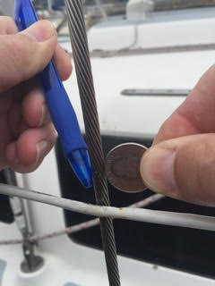

I'm currently in the process of selling my boat. A rigging survey was done and they found that a lifeline has cause damaged to the standing rigging (image attached). They are telling me that I need to replace the whole standing rigging at a cost of $3500. I have no experience so am hoping a rigging expert here can tell me whether that's the right thing to do, or whether they are just looking for me to pay for a brand new rigging for the new buyer. It's a 2000 Hunter 310 and the rigging is original.

More bad news, from the picture it looks like the life lines are due as well. I just replaced my life lines, $700-$1300 boat bucks.

I would have a qualified rigger look the rigging over .. That one wire certainly needs replacing from what I can see.. The lifeline should not be rubbing the shroud.. If a bent stanchion is causing that rub, it should be repaired/replaced before changing the shroud. If after careful inspection by a rigger, there is no evidence of parted wires or rust stains or cracks at the swedge fittings where the wire enters, then I would not replace the entire lot ..
24,938
Regarding the wear from the life line, it is not an uncommon condition. As Kloudie shares it may be caused by a stantion. Or it may just be the angles of all the lines. I have two, on on each side of the boat. I use a plastic chafe guard on the life line and replace it as needed. Some folks use tape. Rerouting a line is a longer term solution than chafe guards.

That looks like a lower forward shroud... the damage from the lifeline not overuse or strain. What about the other shrouds and stays? I would change the damaged wire and offer the buyer a $1500 credit to use as he likes... you must remind him that he is not buying a new boat.. it is 16 years old and you are not representing it as anything other than what it is... a used boat. Oh.. and see if you can do something about re positioning that lifeline so it doesn't keep rubbing the wire.

Offer to replace what is worn: the single shroud. Or offer a deal to let the buyer do it.

So that's the ONLY thing a rigger found after going over the WHOLE rig ???? I'm with Joe, replace the shroud and re-route the lifeline.
