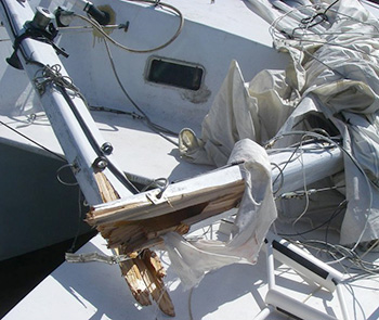

Boat age brings with it issues. After acquisition of S/V Hadley a 1974 Cal I wanted to release the dock lines and unfurl the sails. And I did.
But I took a little care before adventuring to far afield.
  1. I had a 1 year old survey provided by the broker. It was pretty useless.
  2. I had my own experiences which gave me caution.
  3. I had a friend, sailor who had helped me find the boat and we explored the Hadley for issues.
On my first sail in 10knots of breeze, I noticed groaning of the mast and rigging. There was no visual evidence of rust or broken strands on the shrouds, turnbuckles or chain-plates. Yet the turnbuckles were old and the shroud tension was soft. When I examined the spreaders they appeared to be unpainted wood. I spoke with a local rigger Bob, (known by fellow sailors as the Mast Whisperer). He did an inspection and affirmed the shrouds appeared sound but they were maybe 20 or more years old. He was not pleased with the look of the spreaders and the rig tension was not right.
This confirmed my thinking. It was time for a refit. Winter of 2016 we removed the mast. When I got to look at the spreaders, close up, my worries were confirmed. They were made of spruce. There had been no maintenance of them by previous owners and they were rotten. They compressed like a sponge.
Rigging needs to be examined on a regular basis. Certainly yearly, or after any unusual stress event (say a major storm) and definitely before you plan an extended cruise into big water (think Ocean). Standing rigging is not a one and done purchase. Like everything on a boat it gets tired and needs replacement.
There is a certain feeling of safety associated with all running rigging managed from the cockpit. But this has it's downside as well. If you don't go to the mast or fore deck when the boat is under sail you may never notice the sound of the rig or the turn of a turnbuckle that may be the beginning of a problem. I think inspection is an on going form of good seamanship. Seeing the mast & rigging while working the sails at the mast, holding the back stay as the boat pounds against the swell, pulling against the shroud as I go forward to the bow, or getting my hands on the boom while reefing the main gives me a level of confidence that my rig is ready for the conditions I am facing.
