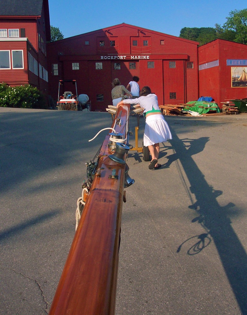

I do worry about the rig coming down. In season, I pay attention to slight movements or shifting of chainplates, tangs, etc.
We pull the mast(s) out every haul out. Everything from mast head down gets a good close look then while it's on horses, and in the spring when it's time to step.
If I'm not sure about a piece, I ask a rigger to take a look.
It was family ritual every spring and fall (usually after school), to help Dad "Drive the mast" through the public landing. I attach the spreaders and shrouds on horses before stepping. These days I've splurged and store in a spar shed.

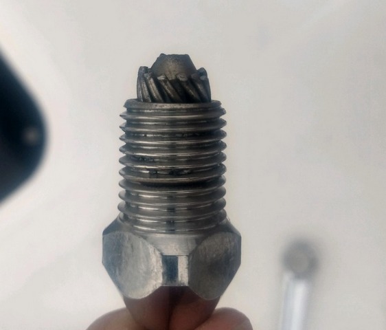

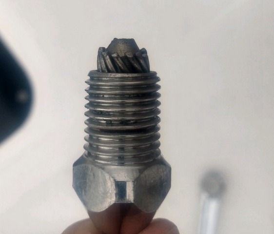

I'm sure glad I hired this guy to inspect the rigging. I'm no expert in Sta-Loks but even I can see this doesn't match the assembly instructions. They will all be redone.
I have never used a Sta-lok. is the error that the outer strands are too short or that the center strands don't protrude?
Ken
Correct. The core should stick out 1/8" and the outer strands should be flush with the tip of the cone. The installer also didn't use lock-tite. This is a properly prepared Sta-Lok:
The cone which you see in my photo above is hidden by the outer strands here, as it should be.
Likes: Ken Cross
