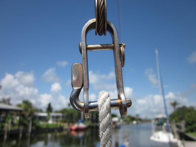

I agree with Joe on sizing. The 1/4" pin size would be very strong but may not have the depth needed for your headboard. I replaced this huge bronze old style shackle on my Morgan with a 3/16" pin size and it works fine for me. The depth (pin to pin) is about 1- 1/2" on this one and I have about 1/2" gap.
See I still have the old wire to rope halyards? They're still good so I'm not in a hurry to changer them out.
My jib halyard has a snap shackle.
