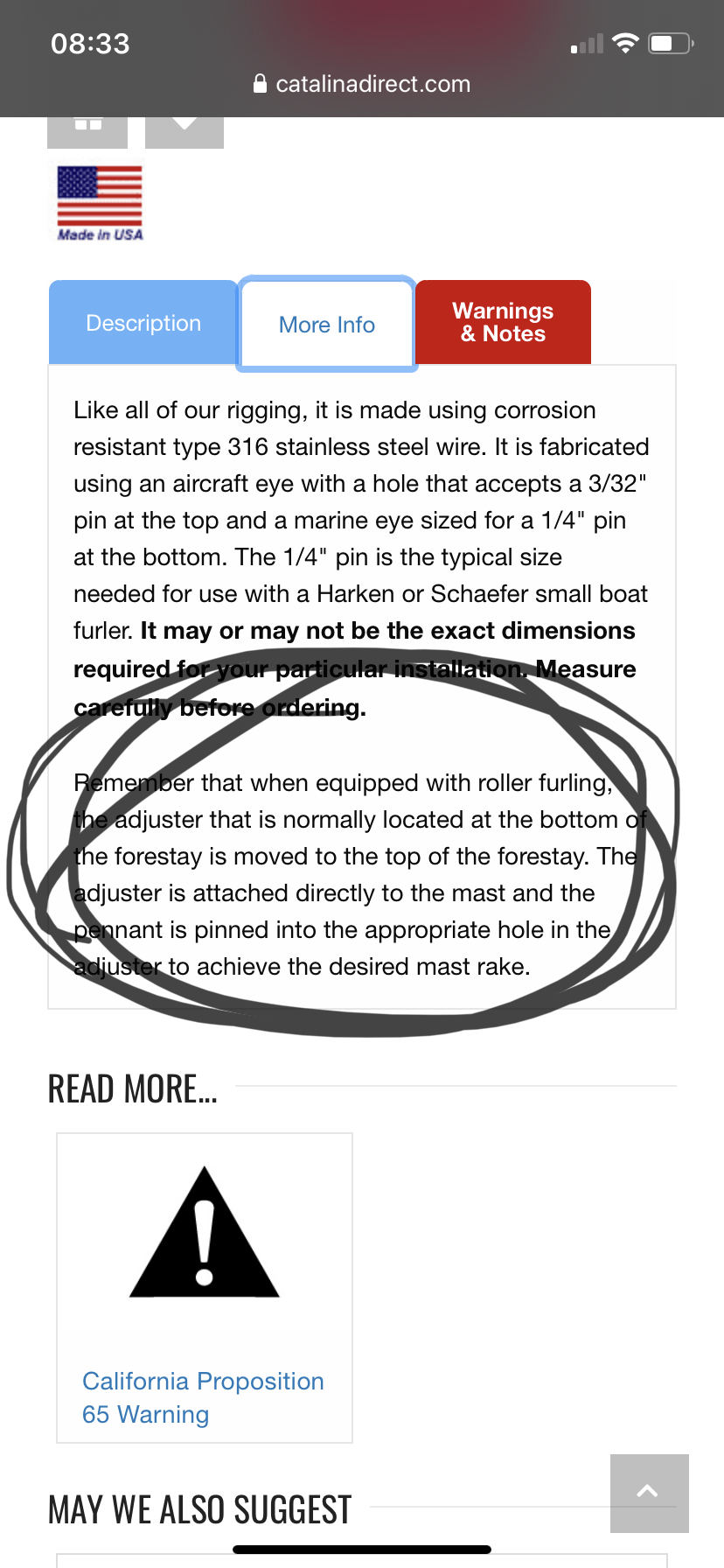

I think this is the appropriate part. Perhaps contact them to confirm for your specific boat.
yep, and the associated part is the swivel I have.

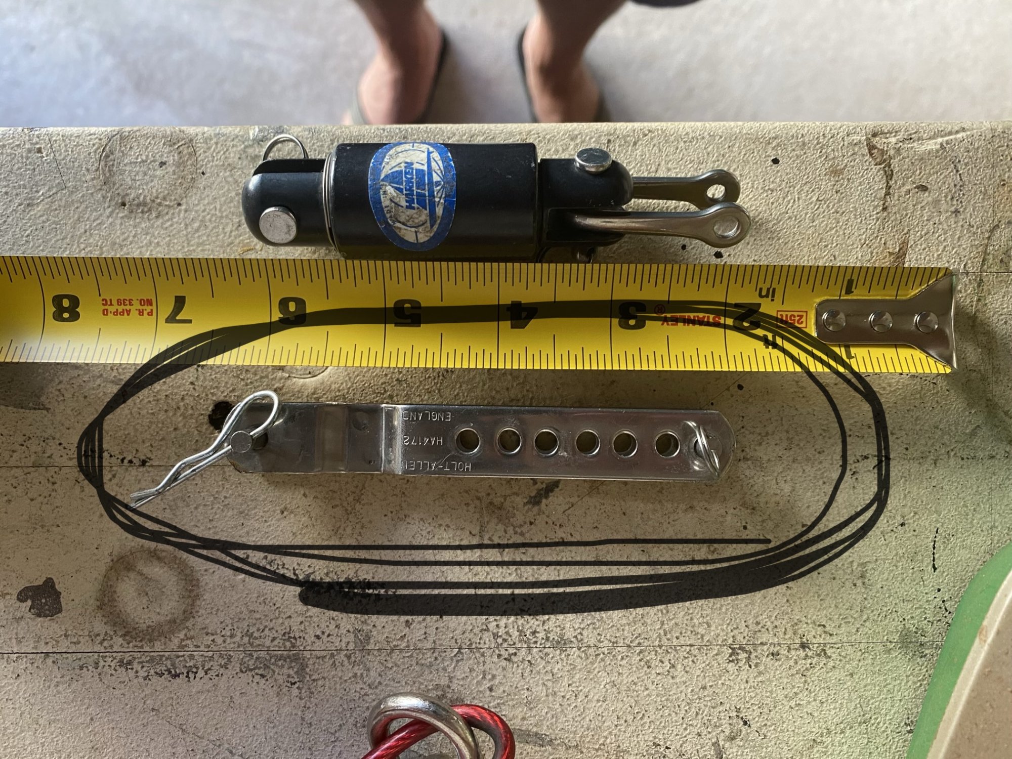

Thanks Joe, first off I meant “ tang” not the boom vang....brain fart. Thanks a lot for the info and suggestions. I talked to Catalina direct, they’re not doing custom rigging because of modified work hours and COVID hassles but they did tell me the length of the pennant, 14 inches. So I called a guy at a marina in Frisco, CO and he said he can fabricate one for me Sunday morning in about 30 mins. So I think I’m good on that score. I found a pin for the jib head swivel on the jib halyard block that I won’t use anyway....winner winner chicken dinner.
Now my issue is stepping the mast. I see how a jib halyard is handy for that...but I won’t have one so I need to figure out how I’m going to step the mast, presumably with head of jib already rigged and what the odds are that the hole in the furler drum is going to match with one of the two small holes in the stem plate.
Any suggestions?

Here's one way: Connect the upper swivel to the mast hound with the pin hole adjuster shown in the photo. Attach that extra ronstan block to the bow stem and run an extension line from the furler drum through the block then back to the cockpit. With the mast set in place ready to tilt up... stand in the cockpit with the mast on your shoulder and star pulling it up with the bow line you set up.... once it is vertical, tie it off at mast... then go forward and get the drum connected... then remove the block and line you used for a lifting aid.
If you have help... have some one walk the mast up while the other uses the extension to pull.
On my nacra I used a fulton trailer winch mounted high on the trailer's mast support to crank it up... still using the line extension.. this time attached to the forestay.(no furler drum). I had a crutch to hold the mast up in preparation to raise.
Dude..... sometimes you just have to go for it.... the best thing to do is practice at home.... don't wait till you get to the marina unless you plan recruiting someone for help.. That may be a good idea though... good chance you might bump into someone who knows what they're doing. If you can launch and maneuver the boat to a beach. raise the mast there. Other wise, raise the mast while it's still on the trailer... not at a dock. keep the boat lashed to the trailer and the trailer hooked on to the tow vehicle. Trust me on this. You can put all the other stuff on wherever you think best... but the mast is easier to raise on the trailer than standing at the dock.
