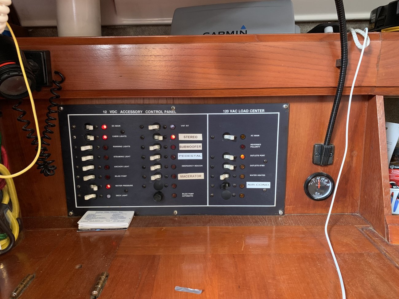

1986 Hunter 34 Owner here: Before I open up the back of the electrical panels, I'd like someone to explain to me how the Main Bilge Pump continues to have power when I've turned off the batteries on the battery switch? On my boat, I've noticed that the bilge pump will run if I have the batteries turned off.
As far as I can tell, it's the only 12v item which stays powered with the batteries all switched off.
I've attached a picture of my breaker panel. I'm going to be adding a 12v breaker which will control the newly installed refrigeration [retro'd the icebox]; and I'd like to have the ability to leave the refrigeration on at the panel once I turn off the battery switches and was hoping some insight as to how the bilge functions with the batteries turned off would be helpful.
Thanks, Shannon

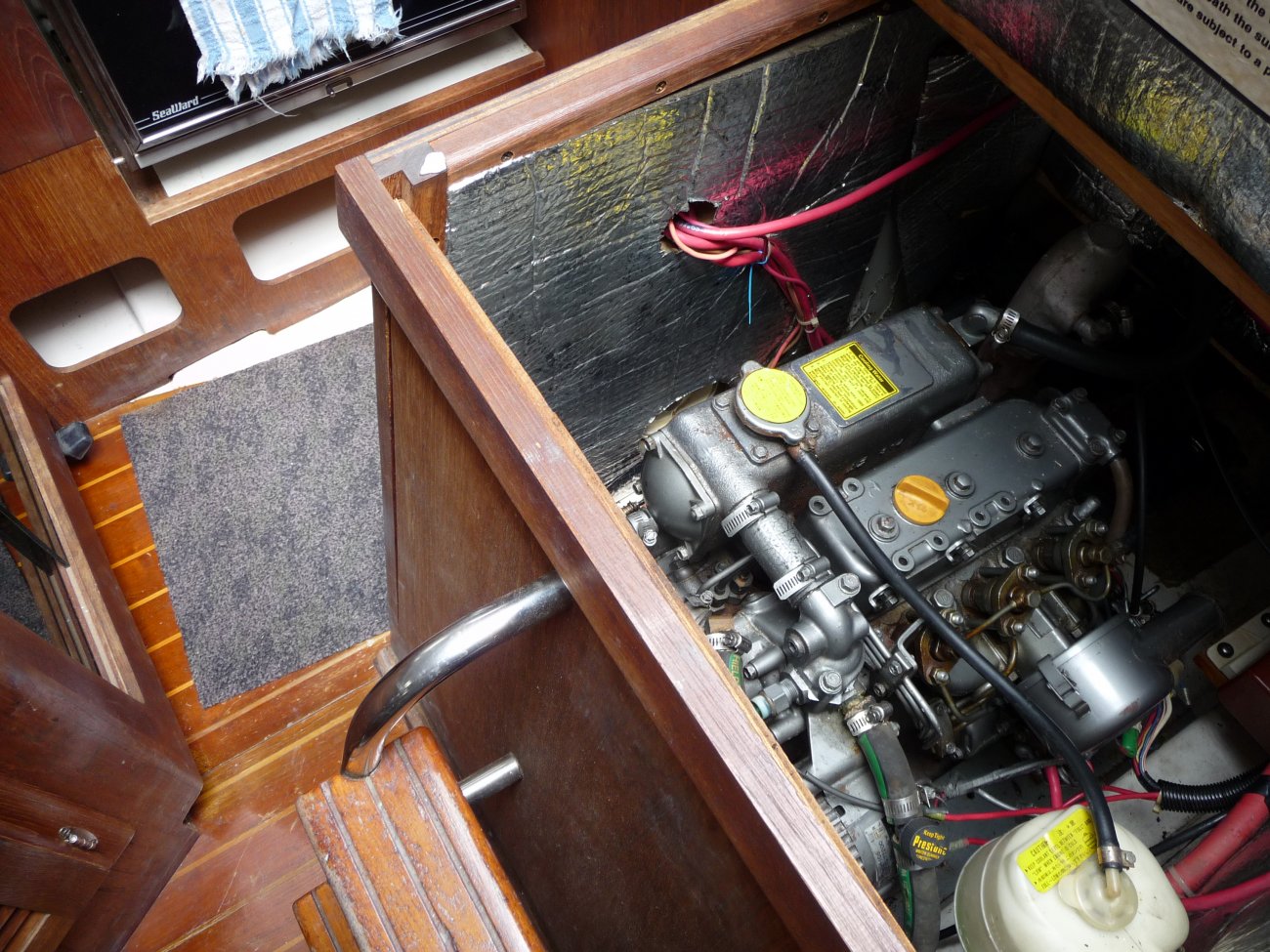

On the battery switch on the side of the engine box, there is a small terminal and red wire that is a constant hot terminal from either 1 or 2 battery, whichever side it is hooked to (before the switch)
10,257
Small diameter (12 ga?) pinkish wire in the left of the bundle from the switch. Goes to the panel and thru the fuse to power the pump.

Claude, thanks. And, I'm to assume that this red wire goes directly to the bilge fuse in the panel? I wonder if I could use this wire and "split" it at the panel: 1 side: goes to bilge [like original] and side 2 goes to the new 15A breaker for the refrigeration? That way, when i turn off the batteries, I could still have power to the refrigeration [unless I turned off that switch seperatetly]. I'd have to check the gauge of that red wire...
10,257
Yup.. should work for fridge if the gauge is sufficient.. Guessing 10 ga (minimum)
would be needed for bilge pump + fridge..
