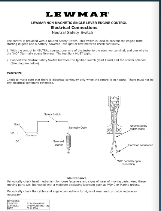

I have a Hunter 356 and have issues with starter. I replaced the starter motor and start switch (button), but still have the issue, which is starter button will only engage starter motor if everything is turned off on 12 volt panel. It has been recommended that I run a dedicated wire from switch to motor as Hunter cable harness corrodes. Can anyone explain how to connect dedicated wire? Where does it tie in to switch and where does it tie into starter motor? Any help is appreciated...

The issue is not a Hunter issue, it is a Yanmar wiring harness issue. A search for solutions using Yanmar starting issues will yet more results and solutions.
The crux of the issue is inadequate voltage at the solenoid to allow the solenoid to engage and thus engage the starter. This is a relatively low amperage circuit as opposed to the starter motor circuit which can carry 200a or more on the inrush. Two possible sources of the problem are low battery voltage, i.e., a battery that is way undercharged or on its last legs, or voltage loss in the wire powering the solenoid.
Power for the solenoid comes from the connection of the large cable for the starter motor to starter. There should be a small gauge wire (16?) on the lug. This wire then goes to the key switch, then to the start button, and then back to solenoid. For any number of reasons the voltage drop on this wire becomes too large to activate the solenoid. Sometimes it is intermittent, the engine won't start on the first try, but after a few tries it does start, other times it starts right up, and sometimes it won't. I don't have a good explanation for it being intermittent.
There are several solutions available, all of them involve rewiring the circuit to provide more power to the solenoid. The one you choose depends on your knowledge, skills, and comfort dealing with engine wiring.
