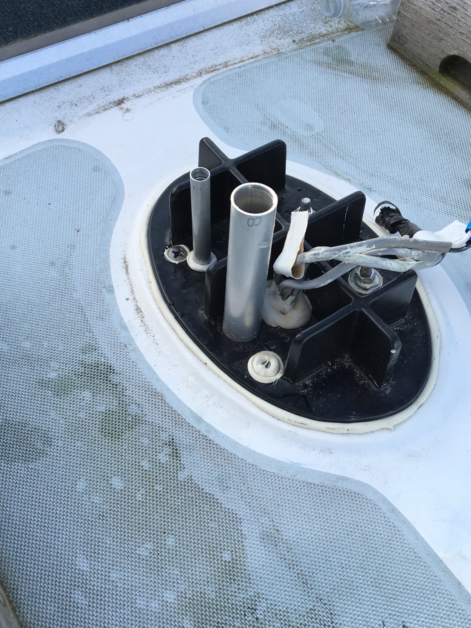

Deck stepped masts have a base plate on the deck the mast rests upon.
This is how mine looks with out the mast.

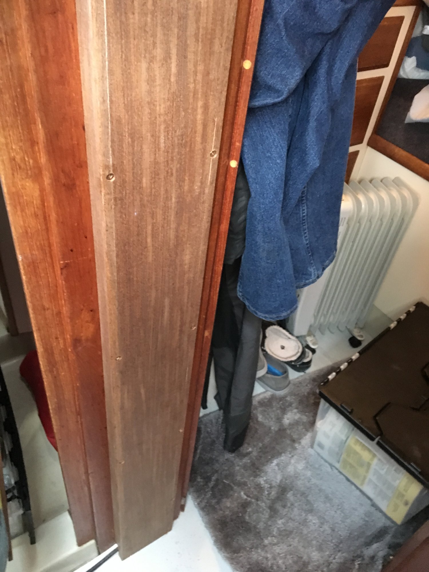

The compression post might be a vertical beam, wood or metal that sits between the bottom of the deck and the keel.

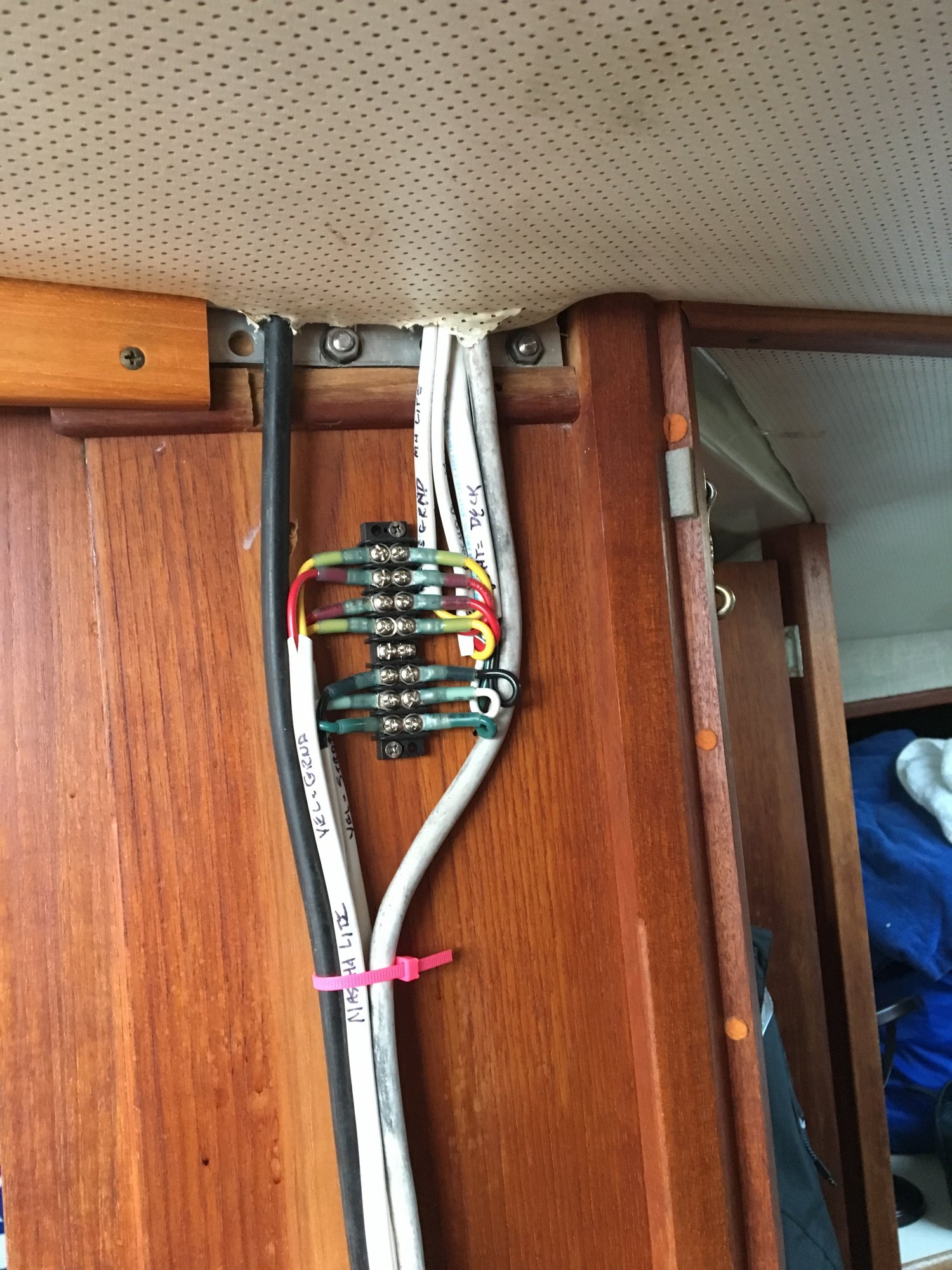

On my boat I wired the cables thru the deck and attached them to the wooden compression post. Then I installed a wooden chase over the cables covering them.

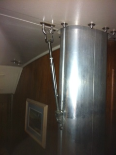

On a keel stepped mast you see the mast coming through the deck. On deck there will be a mast skirt to keep water from running down the mast into the cabin.
The mast look’s something like this in a Catalina 36 as it enters cabin running down to the keel through the sole.
