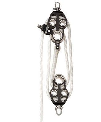

5-1 block and tackle
I found someone who used their own block and tackle in the configuration in the attached photo. This is basically the one that is required for a motorboat which doesn't have a mast and has limited height to bring the person onboard.

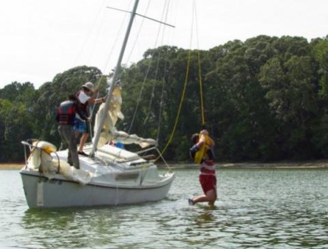

What is wrong with this picture?
This was given as an example of why you can't use a LifeSling2 on a small sailboat in another forum, not SailboatOwners.com, and not one that deals specifically with small boats. The poster commented that you could see the boat leaning over and "about the capsize".
First of all the boat is not about to capsize.
Second, the life sling is not designed to be used as a swimming hole tire. In the actual use of the MOB technique, the person is pulled the side of the boat midway between the bow and stern. At this point, they are pull as far up out of the water as possible. Then and only then, they are connected to the line that is used to pull them up. However,this line is actually connected to a block and tackle 5-1 combination, and then that is pulled up.
The use in the picture has nothing to do with good practice of the use of the MOB using the life sling. IN OPEN WATER WITH WAVES, this could even be very dangerous.

I have sailed the WP Potter 19. While they are 'seaworthy', they are also very tender. I would not want to bring 200 lbs over the side, regardless of the equipment used.

Unless you are sailing the WWP19 right now, and unless you have tried the technique on the boat, you are just shooting the breeze(and from memory yet). That's fun, but its no use for those of us who have to think outside the box to find solutions. Its another of the, "I did something like that, but I've never tried this, so I know it won't work", which is everywhere in sailing. Personally, I get so very tired of hearing those words over and over again, because I usually end up going out and proving them wrong, and then they still try to tell me that they were not wrong and that I didn't do it. i guess I violated their world concept too much.
Its just not helpful. I sail the WWP19 right now, and it not too tender to bring a person up the side of the boat(unless the 400 dagger board is up--- then it might be an issue, but I'm not sure). You sailed it sometime in the past but you never tried something like this.

West marine suggests using a 5-1 block and tackle for Motor boats which is simply four pulleys, two at the top and two and the bottom. With this, even a child could hang in the line, like they were ringing church bells and pull up a 250 lb weight, and certainly any adult.

When I board a Potter I must do so with care. The rapid movement of the boat to my added weight can cause me to loose my balance if I am not careful. That is the definition of tender.
I can understand the acceptance or rejection of forum opinions. What I don't understand is the denial of a boat's inherent characterisitcs.
I can understand the acceptance or rejection of forum opinions. What I don't understand is the denial of a boat's inherent characteristics.
Never noticed that. Do you have the board down when you are boarding? The inherent characteristics that you describe are not noticed by me. So they cannot be inherent, there has to be something else going on.
So either you aren't remembering correctly, you are actually thinking of another boat, you have the board up so that she moves side to side more easily, or have some circumstance that is not the same as what I am used to.
What I don't understand is your unwillingness to accept that your opinion for a boat that you don't own and don't sail regularly might actually be inaccurate. Instead of trying to explore that, you simply assume that you are right and everyone else is wrong. But in any case, that discussion in not germane to this thread, and is actually destructive, which is about thinking out of the box in ways to use the life sling with a WWP19. It does allow you to show how much you think you know, at the expense of other people who don't know as much as you, but it doesn't help the discussion about how to use the lifesling on a small boat.
What would be more useful would be for you to take your vast knowledge and think out of the box for a solution to the issues that you see. Are you able to do that?
