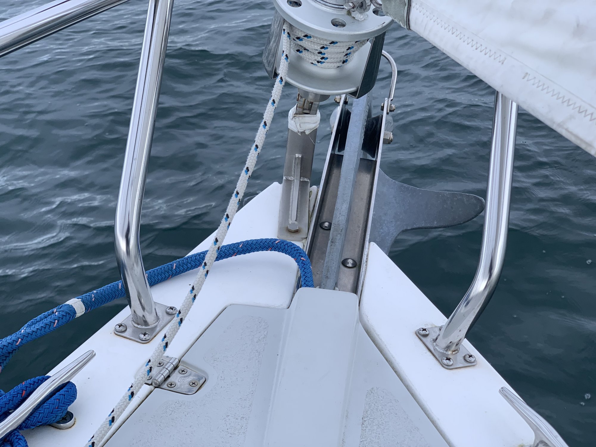

the Cat28 mk ii has an asymmetric anchor roller, and the anchor and/or roller may interfere with the a-frame bowsprit.
I couldn't figure out a way to avoid interfering with the anchor, so I planned mine so I could pull the sprit off quickly to anchor (See the start of the thread and removal process, followed by a picture that might help it make more sense). It usually takes me a minute or two to remove the sprit; I think I could do it in 15-30 seconds if I was in a hurry to get the anchor out (and wasn't taking care to avoid banging things on the deck).
You have a little more room than I do on a C-22, so you might be able to arrange a system that lets you anchor with the sprit in place. Perhaps if your roller is low enough that you can put the sprit above it (my roll-bar anchor interfered with that - a newer design like the Mantus M2 might be better). If so, you'd probably want a snap shackle to release the bobstay, to keep it out of the way of the anchor rode. Then, anchoring would be 1) Release bobstay; 2) (possibly) Rotate sprit upward a bit (if you tension it upward with shock cord, that would be automatic when the bobstay is released); 3) Drop anchor as normal.

The Trogear sprit can be pivoted up to clear the anchor and rode. The bobstay would be rigged as an adjustable type and not a fixed one. Just loosen the bobstay and pivot the sprit up and out of the way. If you wanted to remove the sprit completely, you would only have to unscrew two bolts. Seems pretty easy to rig.
