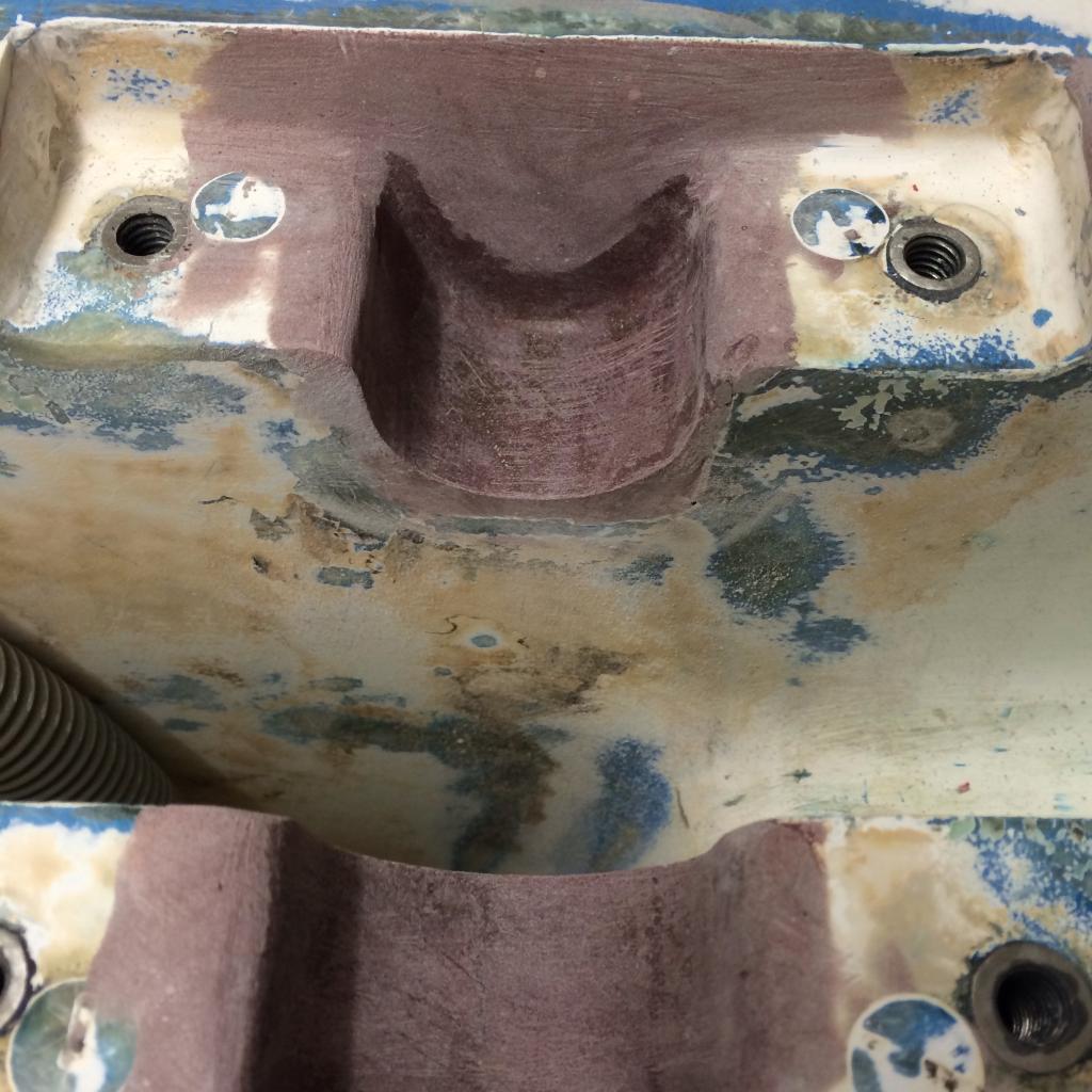

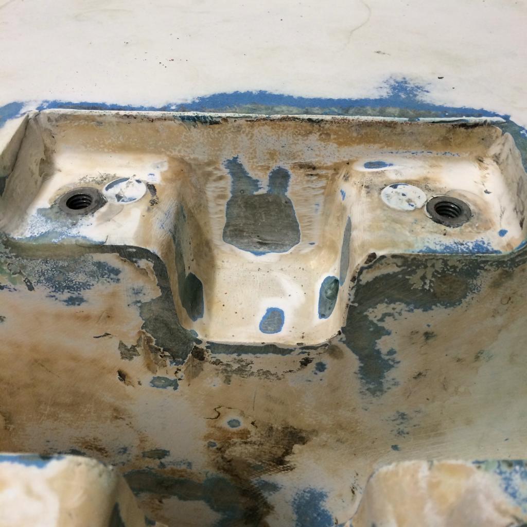

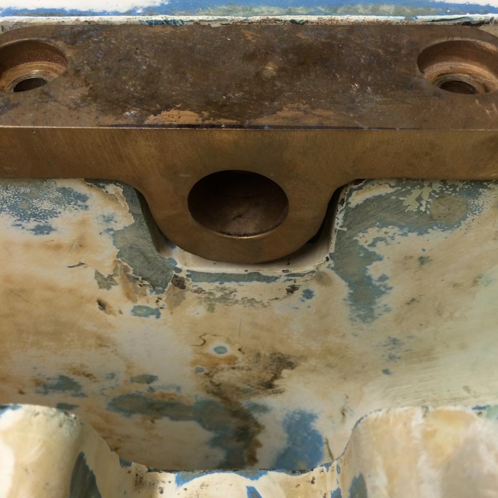

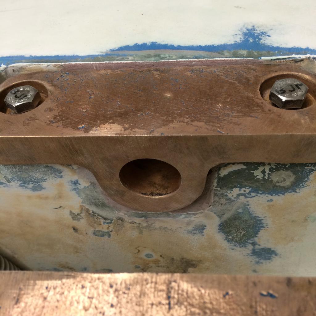

I did put the spacers on and believe it or not I think I have to grind them off! I made a template from a piece of wood that matches the taper of the keel pocket. At the base it is the widest, about 2.25 inches. All the way at the top of the pocket (where CD recommends you epoxy the spacers) the pocket tapers in to 1.75 inch. The top edge on my keel is measuring 1.85 wide, so it looks like I never should have even epoxied them on.I forgot the reason I came on here was to ask if you put the keel spacers on yet and if so pictures? Thank you
I'm going to call CD tech support and ask the if the intent is that the spacers actually jam and flex out the wall of the pocket a little. Without knowing the answer I can already say I don't like the sound of that. I think I'll use my belt sander and try to shave the spacers a bit to match the taper. More on this subject later....
